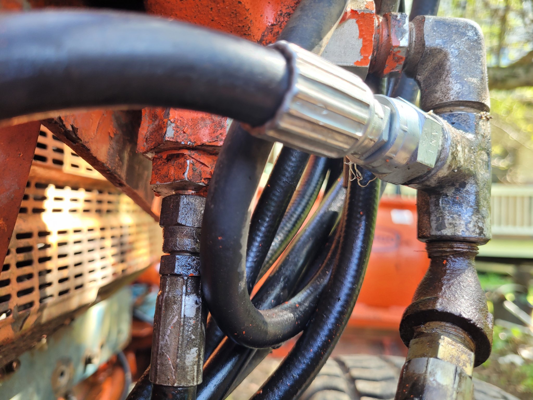

Post a picture of the bottom side hose.
9,911
5,245
Both of these ports have large adapters unlike every other adapter.
