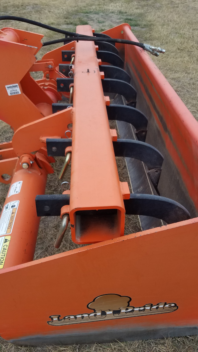

I don’t have time to read the replies right now, but one thing that concerned me was the way the ripper teeth are attached.
Personally, I would not have one that takes “special clips” to hold the shanks in place. I would only buy one that uses simple “pins” to hold the teeth in place.
I passed on a Landpride model for this very reason.
(Unless you can weld and could convert it…)
..just my .02
..just my .02
The BB1560 has the round pins, which are spring clip held.
I somehow lost a pin once and subbed a heavy bolt until it showed up again.
..just my .02
Purchased a used LandPride when I downsized to the BX. Couldn't pass up the price for the few scratches and one of shanks showing a bit of rust. QH compatible. The clips stink. Replaced them with a set of L style shank holders. Simple and inexpensive fix to the poor system LP uses.

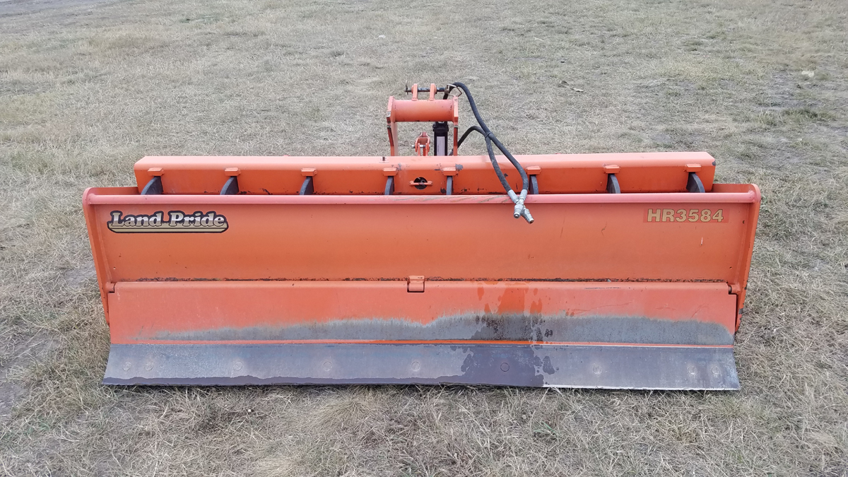

8,356
11,755
I almost bought this Land Pride HR3584 from the local dealer a few years ago. Kind of wish I had to be honest but at the time I didn't think it was particularly affordable which in hindsight was a mistake given the current cost of implements. I have a 7ft EA box blade, 7ft EA land leveler and an 8ft Buhler/Farm King rear blade with 3-way hydraulics, but this thing sure would be nice. The EA method of adjusting the height of the scarifiers on the the box blade and land leveler are ok but still annoying compared to moving a lever in the cab.
