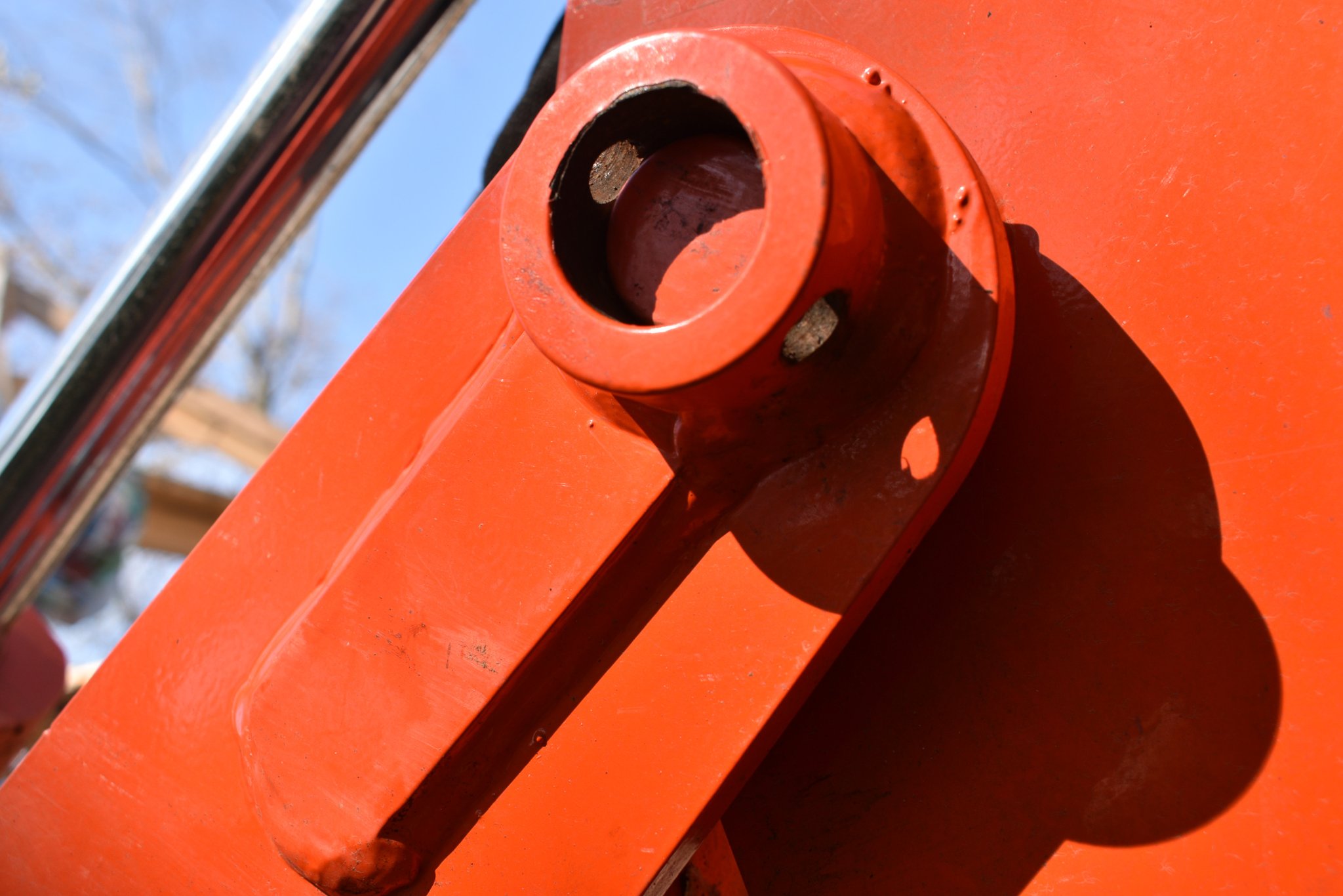

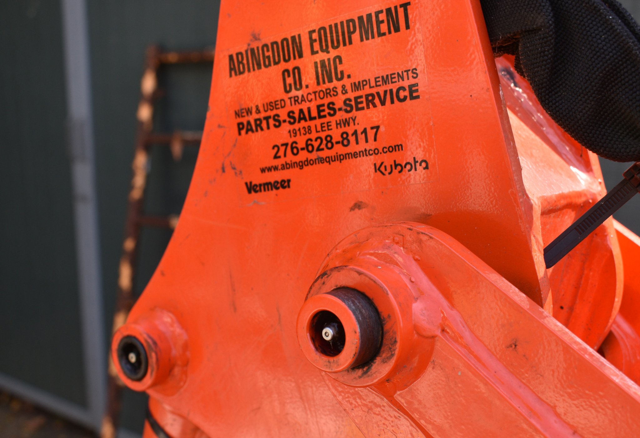

My LX2610 with the hoe exceeded my expectations so far, except that while greasing all the fittings during the 50 hour oil & filter change, I noticed the pin that connects the boom to dipper had come out to one side about an inch. On the empty side the pin appears to be wedged into the boom.

Question: Is this something I can repair or take it to the dealer?

Can you just lower the bucket to the ground to get the pressure off the pin a little to get it back in place then find a bolt to put through it?

Simple fix.
There should be a bolt with a locking nut through the two holes and the pin
You can tap that pin back into place and put a bolt with locking nut on it.
Nut and bolt should not be tight.

The pin is jammed in there pretty tight. I did relieve pressure by lowering the boom, with no effect. I tapped on it with a 3 pound hammer (and block of wood) and am concerned the inner race of the boom could be damaged, or the pin broken if I have to get the sledge out.

There isn't so much weight on the pin that would prevent hammering it out. Use a punch or rod that is nearly as large as the pin so that there will be no problem aligning the holes when installing the pin. There is only a simple steel bushing in the arm. I would punch out the pin whichever way it goes the easiest, then check the pin for straightness. If you find a bend, replace the pin and bushing. A new bushing can be drawn in using a large bolt with nut and washers.

Gently lightly rapping the pin while simultaneously working the boom (with the bucket sort of on the ground) should find the sweet spot where the pivot is unloaded and the pin can slide right back in.
If it is not greased, you might want to do that first.
You will also probably want to press it out the other side far enough so the hole drilled through for the fixing bolt is visible. A long punch inserted through the hole in the pin, rotate to ensure the holes in the boom can align and tap the pin back.
The bolt that 'fixes' it should have a Nylock nut and a few MM of space (not tight as mentioned above)

This morning I bought a bolt to replace the one that fell out and tried to grease the pin, but it would not take grease. Upon examining the space in the joint between the boom and dipper, it appears there was never any grease applied, or at least never any that made it far enough to do any good.
Looks like I should pull the pin anyway and check to see if it's bent or scored up.

Used a 3/4" pipe to knock out the pin, cleaned the carbon off with an emery paper, pushed a wire down the journal, cleaned out the grease fitting, and it slid back into place nicely. Took grease normally and now I can level out a place for a shop slab and dig the footings.
