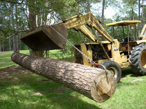

My common practice is to attach the chain to both hooks and suspend the load from the center point beneath the bucket.
This is a much earlier picture showing a 20' chain across the bucket. I now can use two shorter chains attached to the hooks on the bucket. Handling logs like this keeps them level and under control.

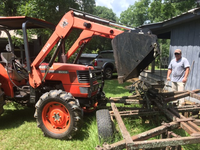

I use my clamp on bucket hitch ball/hook setup for the light stuff. (1st pic)
I have a 5/16 chain with a removable grab hook that I pass through the welded angle I added on top my bucket for the heavy stuff. (2nd pic)
I think maybe that ball mount which I love could be modified from 1 of those bucket foots that slides on the bottom of bucket to keep bucket from digging in. I'm more interested in the chain hook than the ball.
