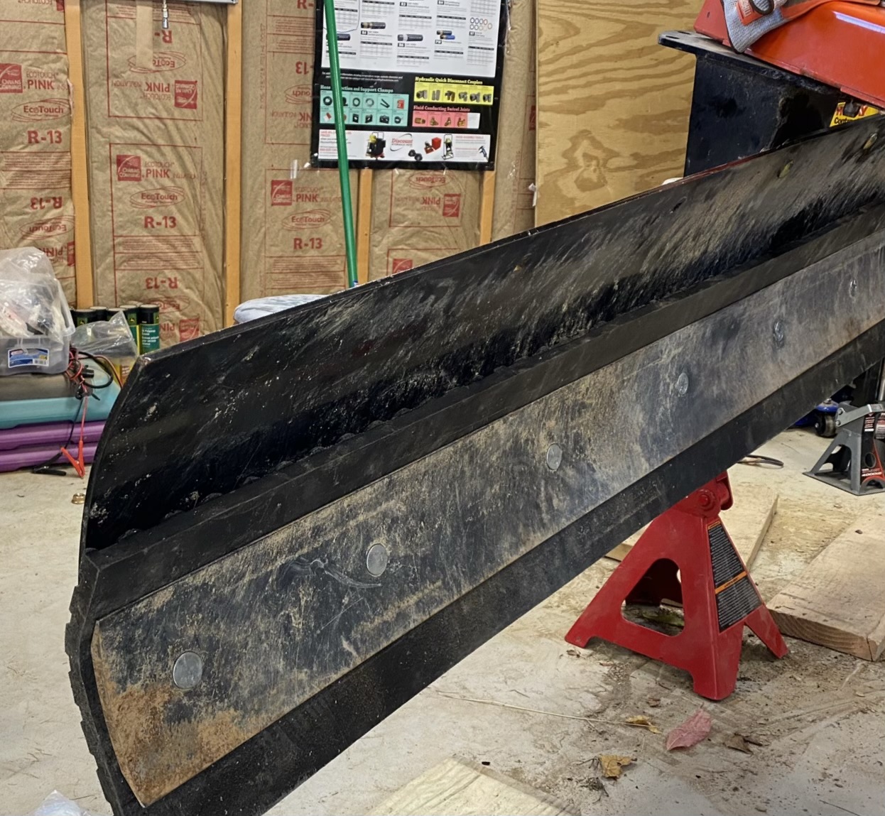

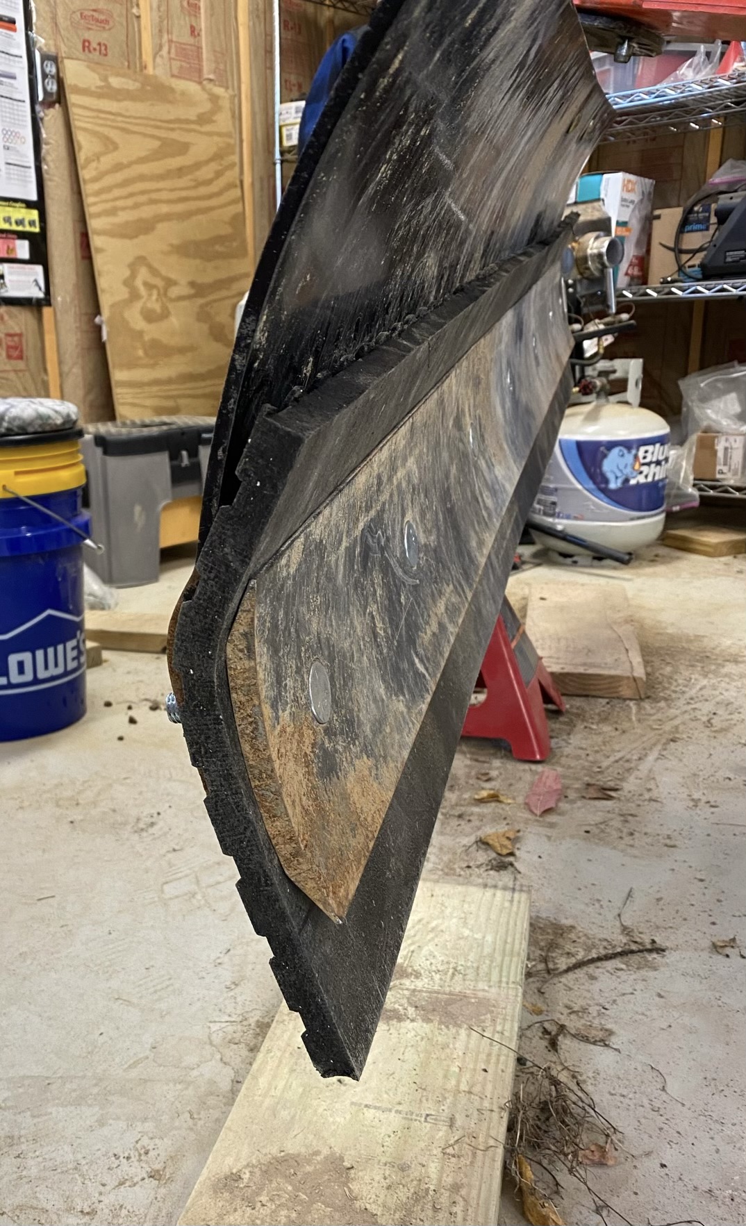

I modified a rear blade with a sandwiched section of horse-stall mat, which works really well on my gravel driveway.
With some snow in the FEL bucket for weight, loaded rears, and my fat butt, haven’t had the need for chains yet.
This is the same setup I use on both front and rear blade to prevent scraping up concrete and blacktop driveways I plow.
