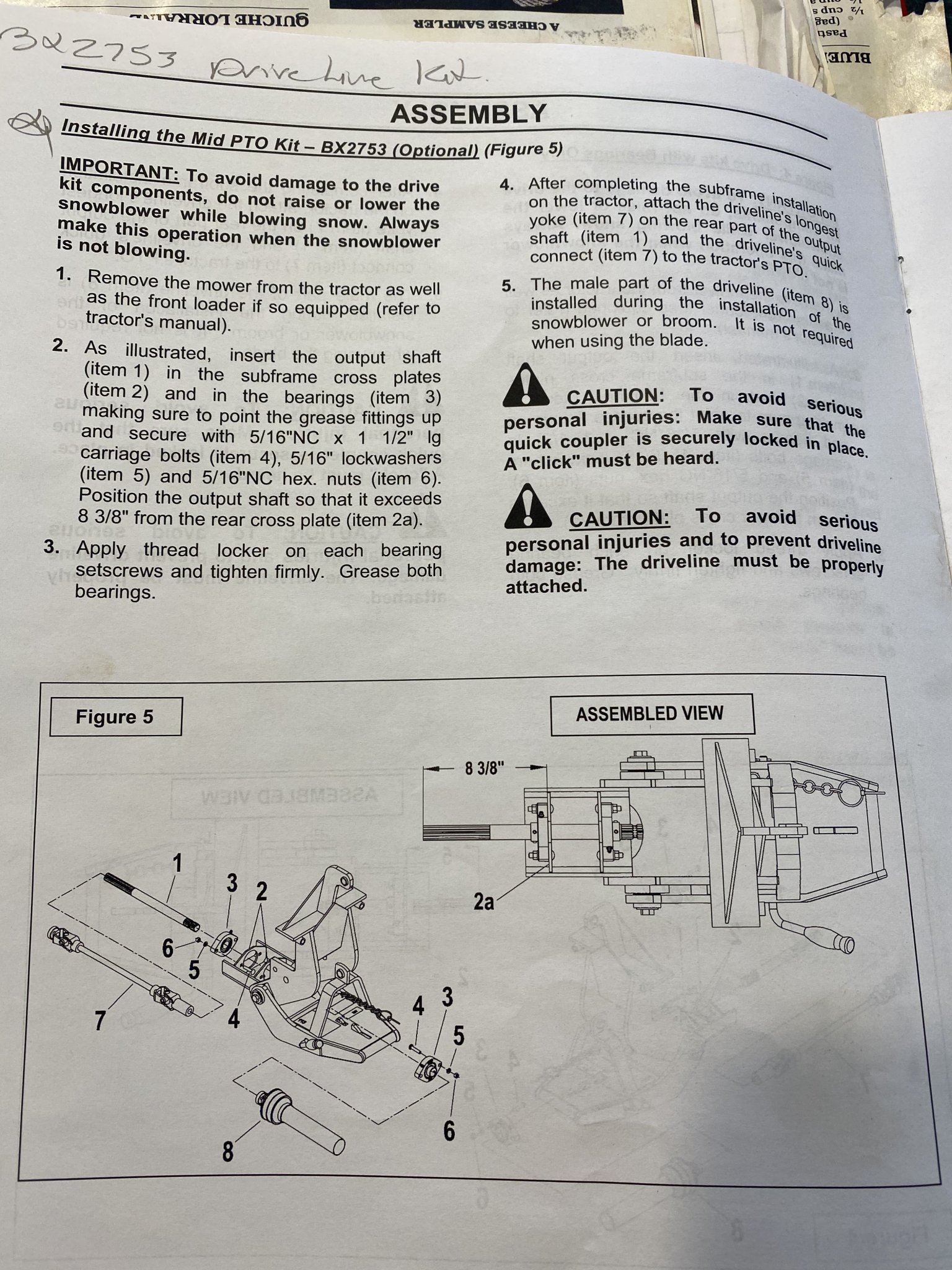

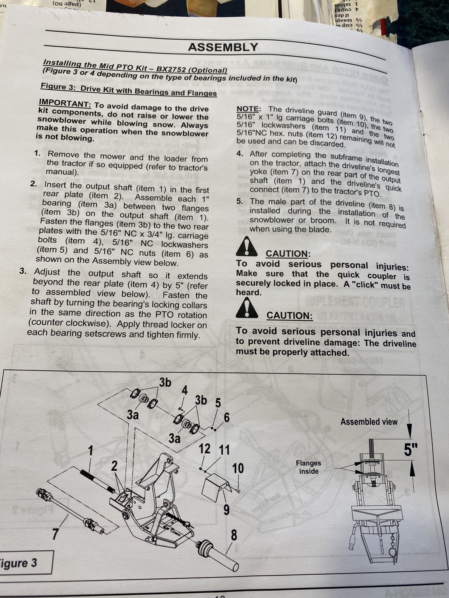

My tractor uses the BX2751 front hitch, and the BX2753 shaft. Yours looks like the BX2752 or BX2752A shaft.
I noted in my manual that the flanges are mounted differently for the shorter BX2752 versus the longer BX2753....something to check...
This is the shorter BX2752..
The BX2753.

mid PTO shaft length yoke tip to yoke tip: 34 1/8”
In both failure instances, the set screws became loose causing the output shaft to shift forward, there in lies the issue. But clearly there is a difference in the output shaft length...I’ll check next time I’m in the garage and when the new mid PTO shaft comes in how much clearance I have between the output shaft and the mid PTO shaft...off the top of my head, I definitely have the pillow block style vice the flange system bearings. That being said means I have the longer output shaft length and should help instead of be more of an issue.

Thank you all for feedback. Sometimes it’s the simple or obvious things that you miss when trying to diagnose a complex issue. While awaiting replacement parts from Messicks, I found the input shaft to indeed be loose, as 3 of 4 set screws in the pillow block bearings loose... but why and how?
After inspection of the mid PTO shaft, found a bend on the order of about 5 degrees on the engine side of the PTO which is consistent to the location of the “PTO shaft” access hole in my skid plate, which is about 30 inch back from the input shaft engagement. I am guessing as the shaft separated from the front input shaft due to input shaft shifting forward, the mid PTO shaft was left uncontrollably whipping around the heavy gauge steel skid plate access hole with plenty of force to induce a bend in the shaft. Going to take a leap of faith and assume I bent the shaft the first time this failure occurred in 2014, as I am going to attribute that failure on me for not initially applying loctite or torquing the 4 set screws properly on the pillow block bearings. So as suggested, I am going to imagine this was enough of a yield to the shaft that caused excessive vibration to cause the set screws to loosen enough to shift the input shaft forward.
