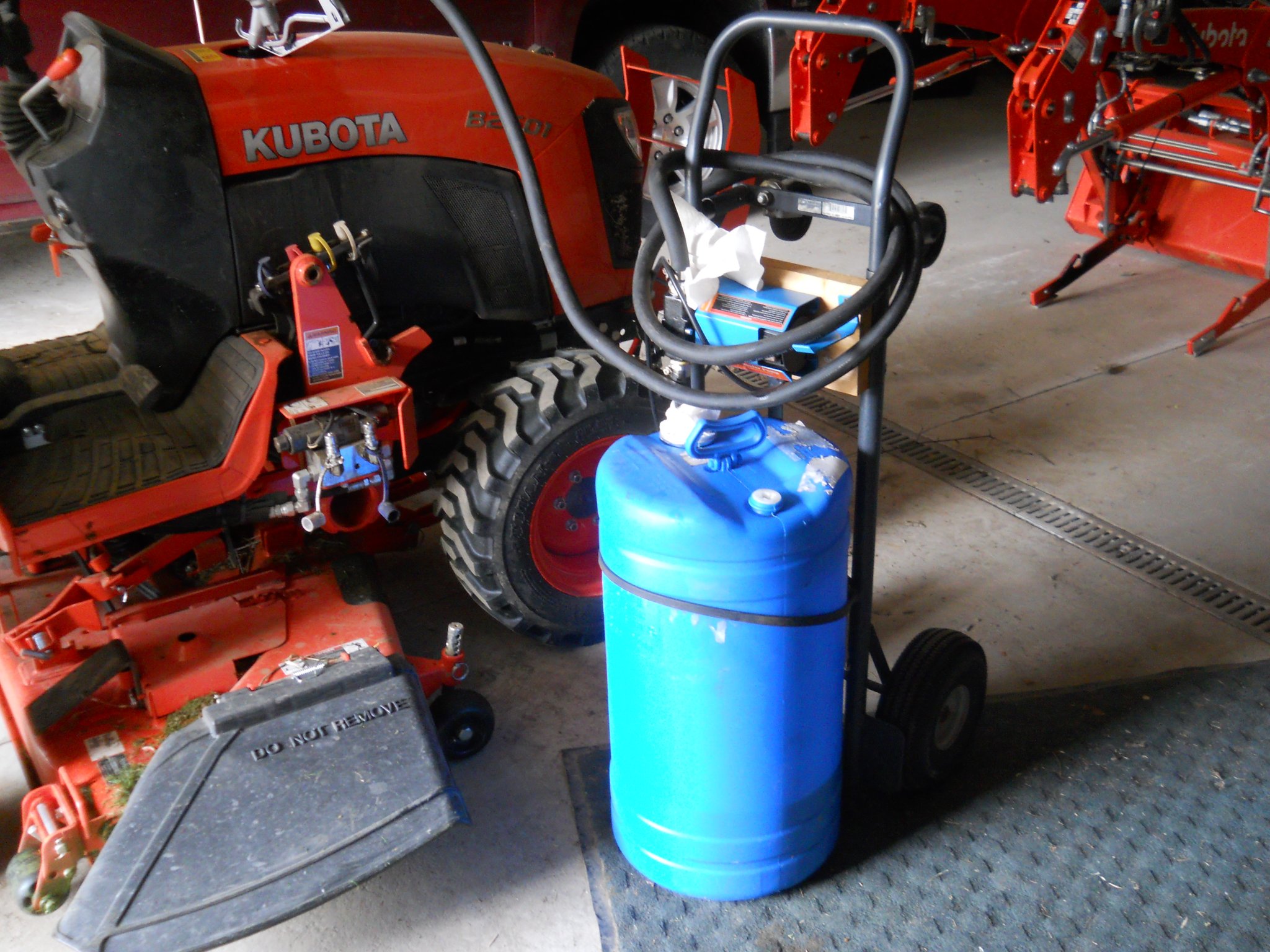

As other previous posters, I used an Amazon 12 volt 'kit' and made my own refilling station of sorts. It was easier years ago when I burned #2. I just had our oilman fill it when he came. Now I use the forks to lift it into my son's pickup. The drum dolly it sits on makes it much easier to handle. It plugs right into a 20 amp socket behind the fel bucket.

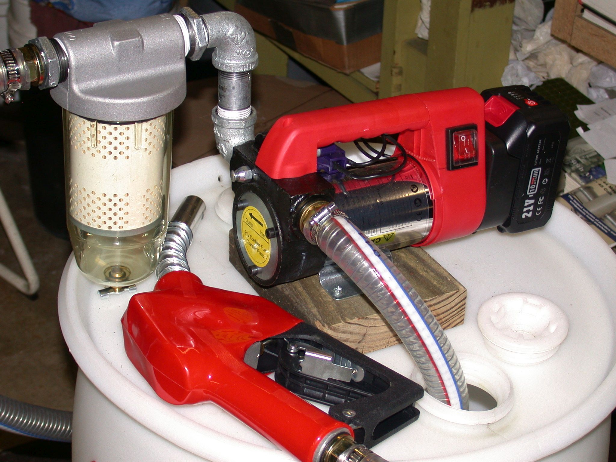

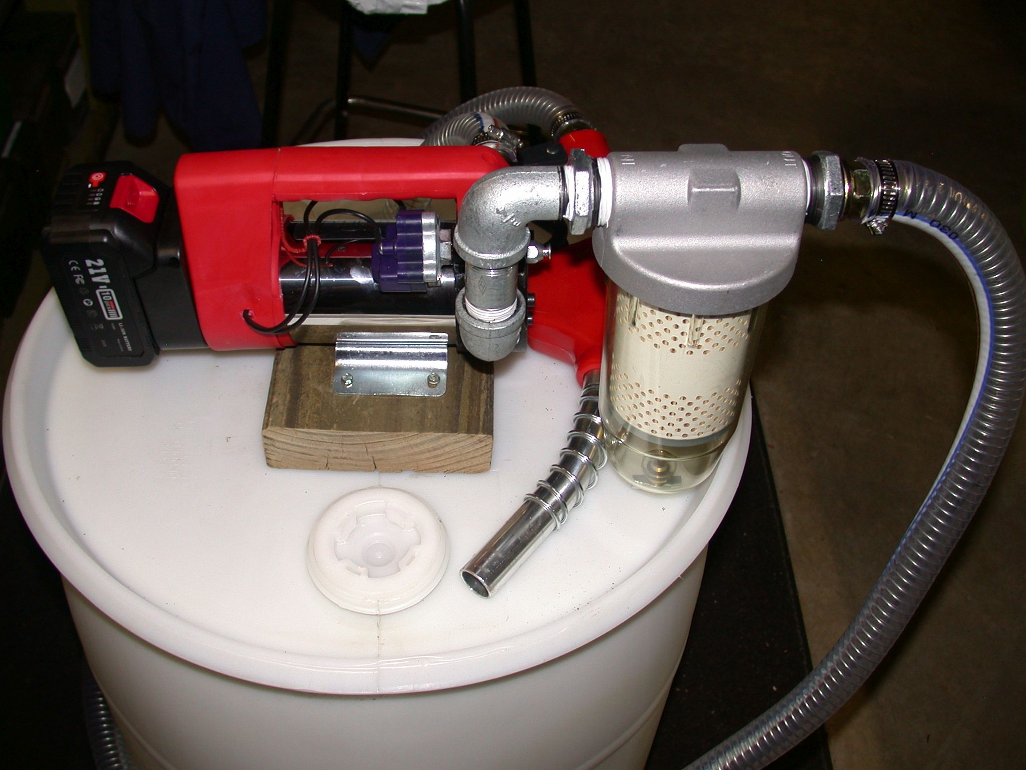

Just set this one up, works well
rechargeable 21Volt battery All the lines etc. come with it. I added a water separator filter. Nice, portable....well made.

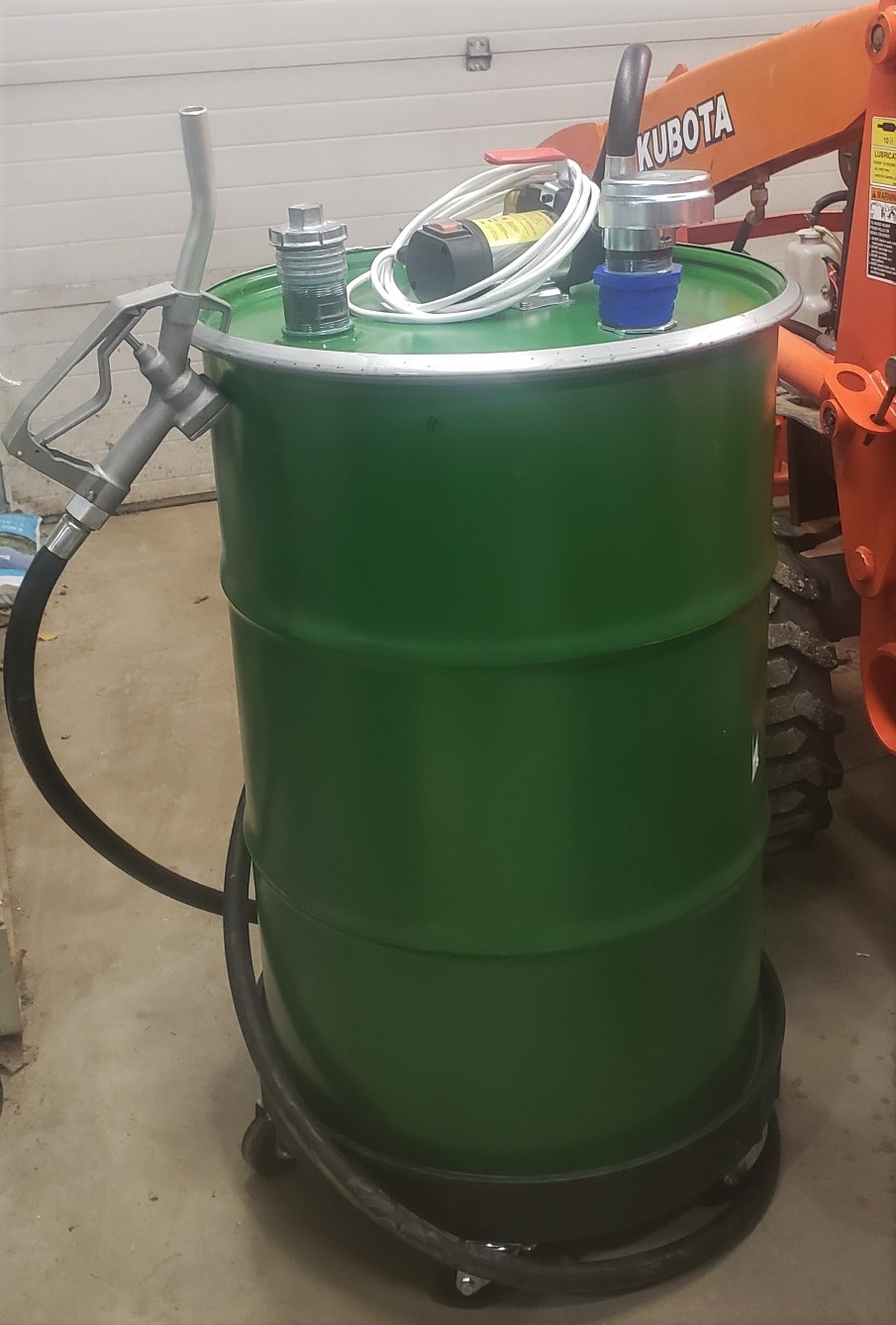

Well, I guess mine is battery power. The battery is in the tractor. I brought a 20a 12v connector to the front of the fel.
and that powers my Rube Goldberg diesel storage tank.
All standard oil tank fittings. Some I was able a scavenge from old tanks. The pump & hose setup were from Amazon. The tank I found new on ebay - I think it was about $35 iirc. All in about $150. Been working for 5-6 years.
