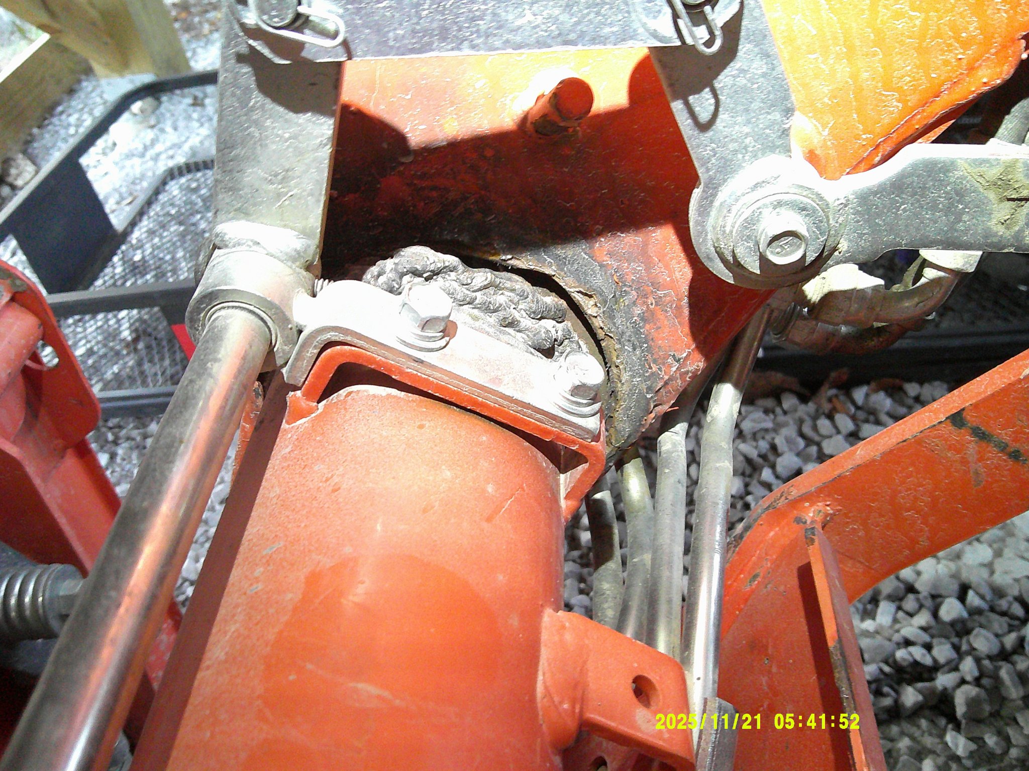

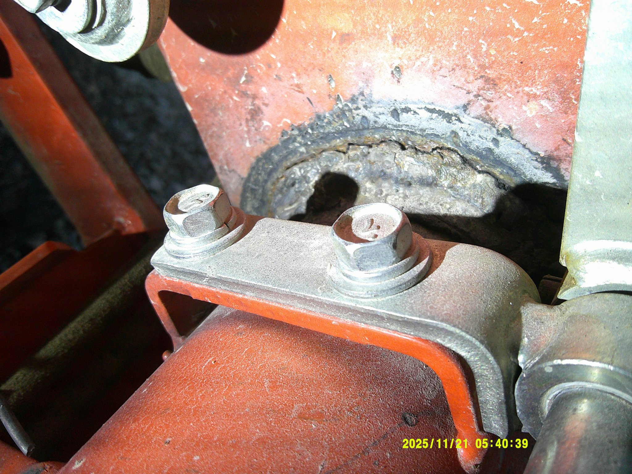

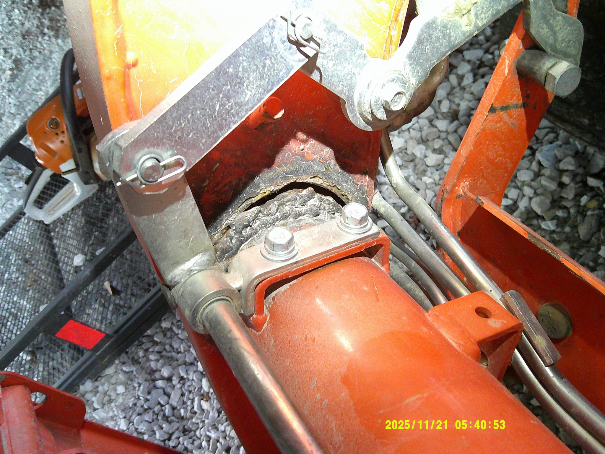

The person that did this to your loader is not a weldor.
I had a good career for many years working as a welder and diver on construction sites, fabrication shops, shipyards etc., and passed numerous welding tests that were required during that time. It's easy to criticize welds but we don't always know the challenges that a welder faced whether it was equipment, contamination, time, bad prep or whatever. Without more information I wouldn't say too much about the qualifications or ability of the person who welded the loader, but I certainly wouldn't be pleased with the end results if I had worked on that thing.

There are several problems we’ve seen in this thread.
Yes…poor (almost no) penetration (not enough heat) in those welds. The beads were sitting on TOP of the base metal….Not “welded into” it.
But even poor welds should not be asked to do with what this crossmember is tasked: The Single Hydraulic bucket “tilt” cylinder on this design places the entire bucket-tilt-load onto that tube… basically “twisting” it off the loader arms.
Without extending the tube THrough the arms…. the tube should be given greater surface upon them. One method might be to slit the ends of the tubes and weld extensions up/down the inside-surface of the arms to spread the bucket tilt cylinder forces along the arms.
Otherwise, the bucket should have Paired tilt/dump cyls placed at the ends of the bucket and taken directly to the loader arms. (which is another reason (besides the thru-tube) the LA535 the other responder posted-about, doesn’t have this problem)
REally really poor design. When you get this thing fixed…. be gentle with the loads when tilting/dumping that bucket.

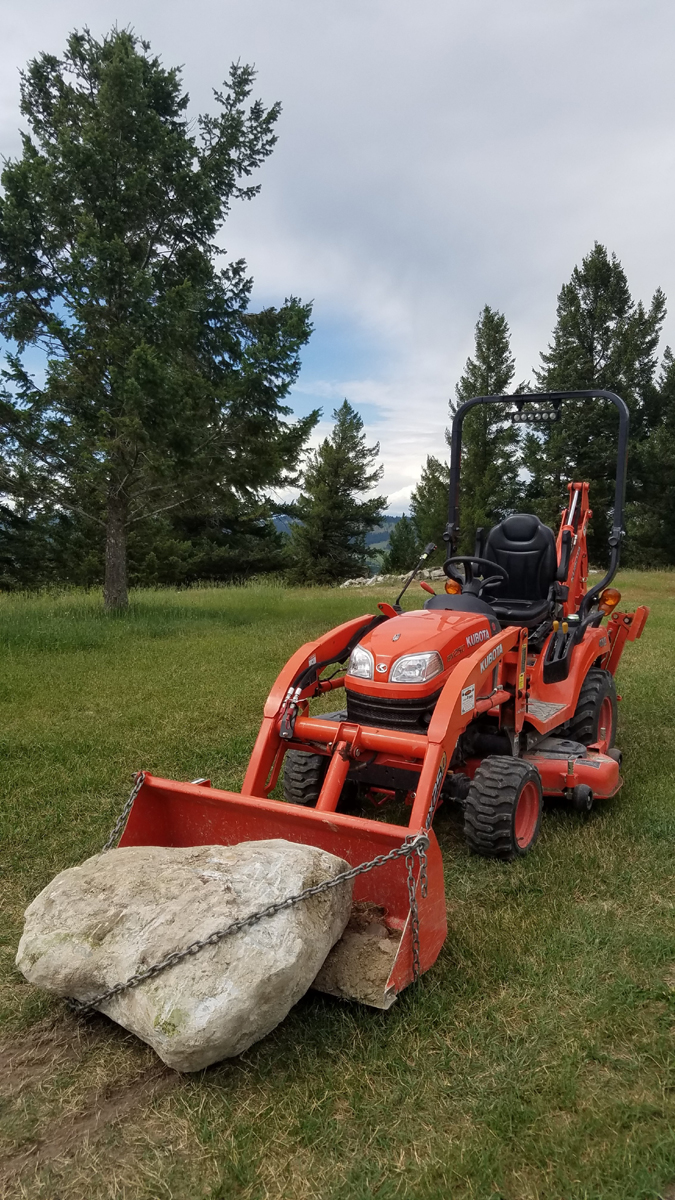

I've never picked up a rock that big with my bucket.
Nor have I, or at least not with the BX. I've picked up much bigger with the MX and M.

That pic doesn’t show the rock actually being lifted. (i tried to lift a rock only slightly larger in appearance….with my LA-1002 (2K capacity)… but no bueno!
Didn’t break any welds tho’ either.
