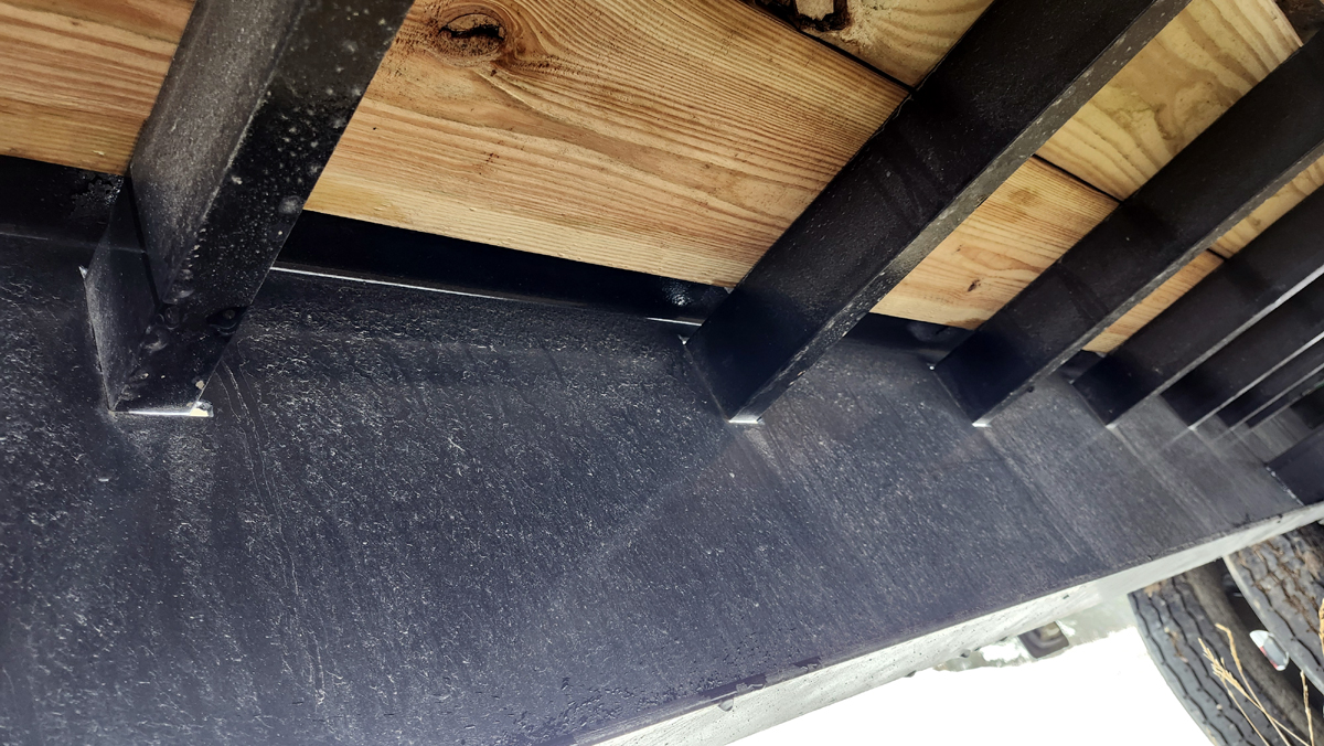

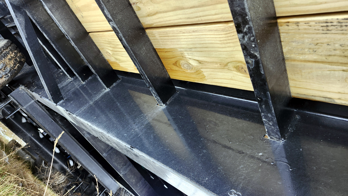

The cross members pierce the 12" x 16lb I-beams that run the length of the trailer, but the C-channel cross members are only welded to the I-beams along the web of the channel. I'll fix that by welding the flanges as well which will add stiffness to the trailer.
A word of caution: the flexibility may be desired by the manufacturer. C-channels are typically used on truck frames to allow flexing. Rigidity increases strain on the components.

Some pictures might help, since we're discussing welding, best practices, piercing etc.
Here are some photos under the Kaufman trailer. The C-channel cross members are welded to the I-beam on both sides of the web (outboard side only), but vertical down for sure. First photo is inboard of the I-beam and the second photo is outboard of the beam.
Well, I have a basic understanding of welding and mechanical engineering but I would not consider myself to be an expert it this field.
From what I see I would say the welding is strong enough for what it is supposed to hold. Maybe Kaufmann is cheaper because they do not do unnecessary welds and dolphin/tuna/sushi plates?
If the internet is not full of broken Kaufmann trailer stories I would simply leave it alone. Never touch a running system ;) :giggle:
