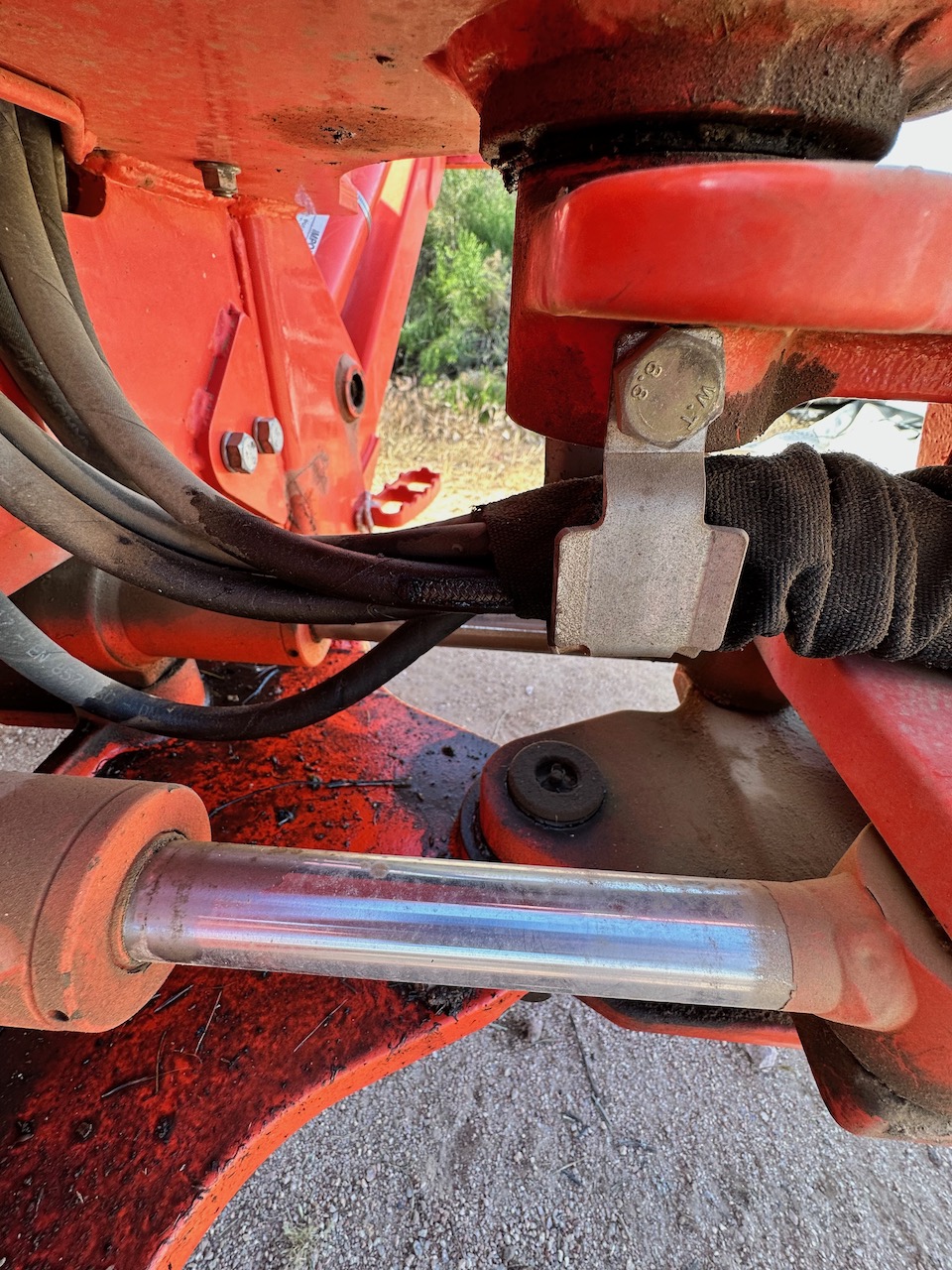

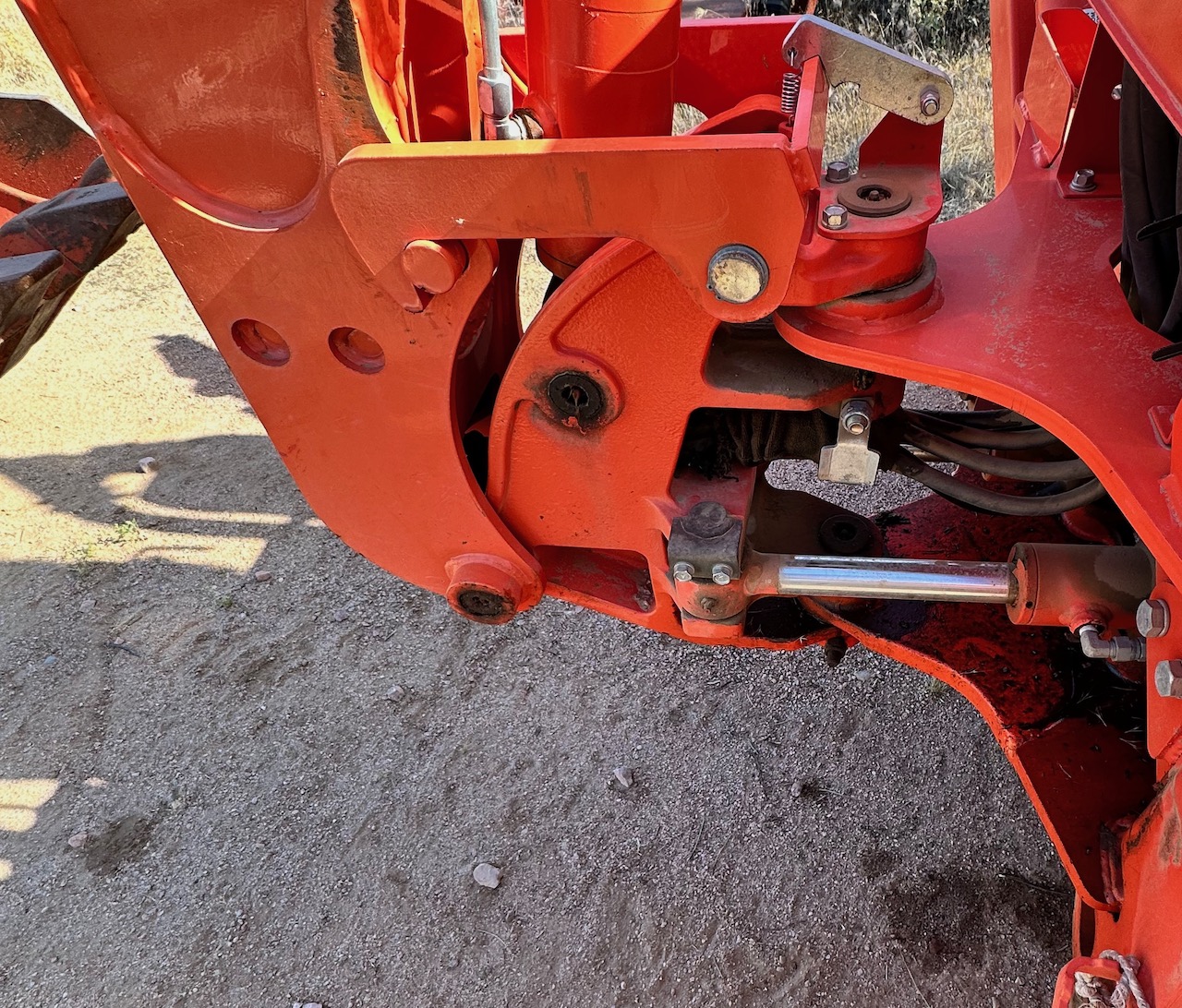

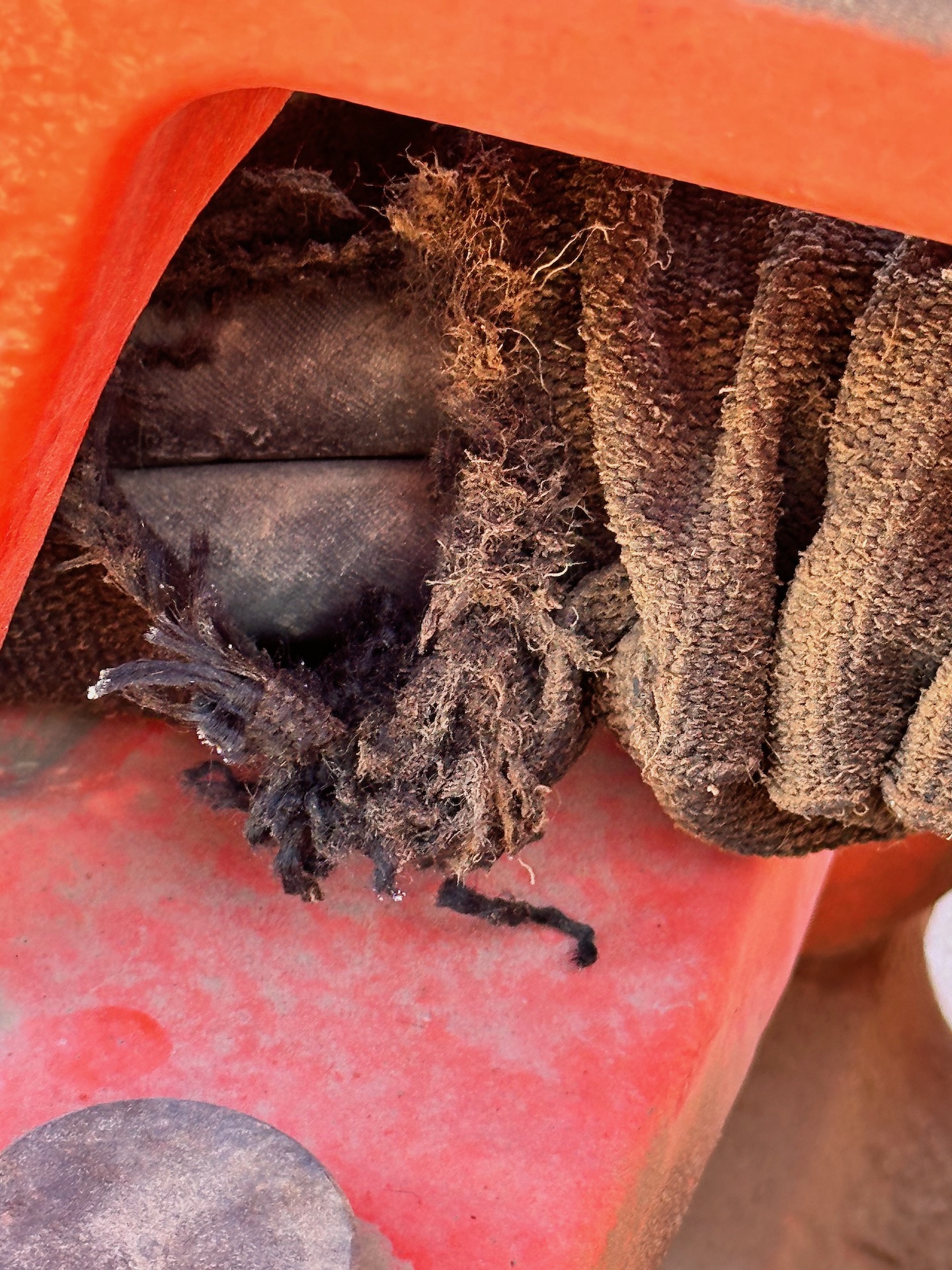

I have a L4600 with a BH92 12' backhoe. I have a hydraulic line that rubbed and now needs replacing due to a leak. ALso the cloth sheath that goes through the bottom of the backhoe arm has a worn hole in it and needs replacing. Any advice, tips, or tricks you can offer?
