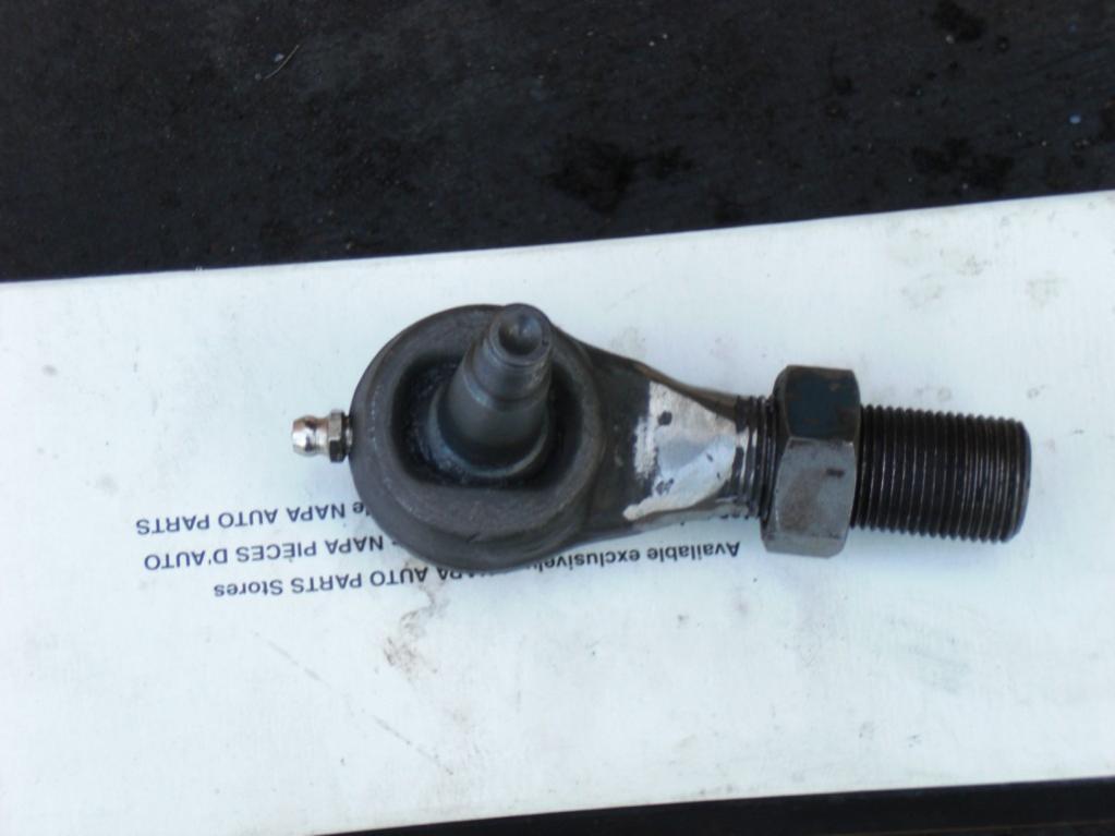

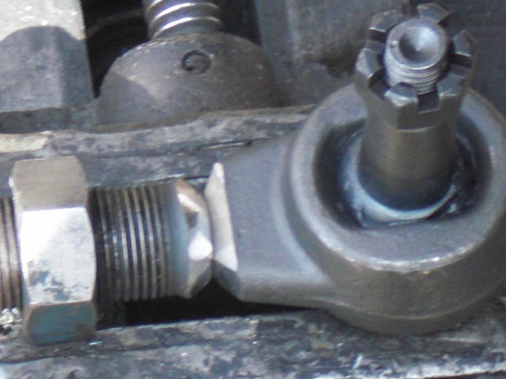

Glad you fixed it dusty towel usually works good long as you weld slow (give it a chance to cool between pass) keep it wet and off the weld. Keeps those boots from burning. Looks like you ground it down also dont beleive you will have any problem. I usually prefer welding those with a stick.(JUST OLD SCHOOL) but the stick is usually stronger if done properly. Proved that one to lincoln back in the late 1990s.Good luck handy

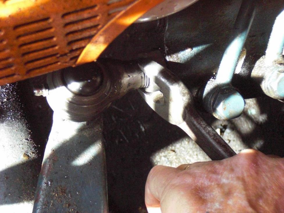

Thanks Handy. I use stick for everything me & mr mig don't get along. Two passes and fixem up at the end. No I don't think it will break. Took about 30 min to weld. :D Dusty

Dusty that weld looks GREAT :D
It only took you 30 minutes? It would have taken me a lot longer, especially counting how long it would take to go back to NAPA for another rod end.

Never wet rod end or the weld itself with water sometimes people think they are doing good to cool it off with water.NO NO let it cool on its on the water was for the rag wrapped around the tie rod end to keep the rubber on the tie rod end from melting. Dont get the water on the weld but rag around the rubber tie rod end and keep rag wet (OR IT WILL BURST IN FLAMES). The wet rag works good on delicate parts when you need it.I have used all types of gels made for this over the years with not a lot of luck. The tight rag with water works best. BUT dont put water on the weld( notice the tie rod end in picture) . Dusty wraped the rag around the rubber boot and ball part only. Look at the rubber in next picture no damage to rubber. The rubber boot will hold greese for a long time. Another simple trick some things (to keep them from warping after I weld them) I have been known to bury them in my sand pile to cool slower( Not often) but for some metals this slower process of cooling will keep them from warping or twisting while they are cooling. Starting to ramble so I will hush try the rag sometime let me know how it turns out or just check dustys pictures. Hope I explained about the water and wet rag. handy
