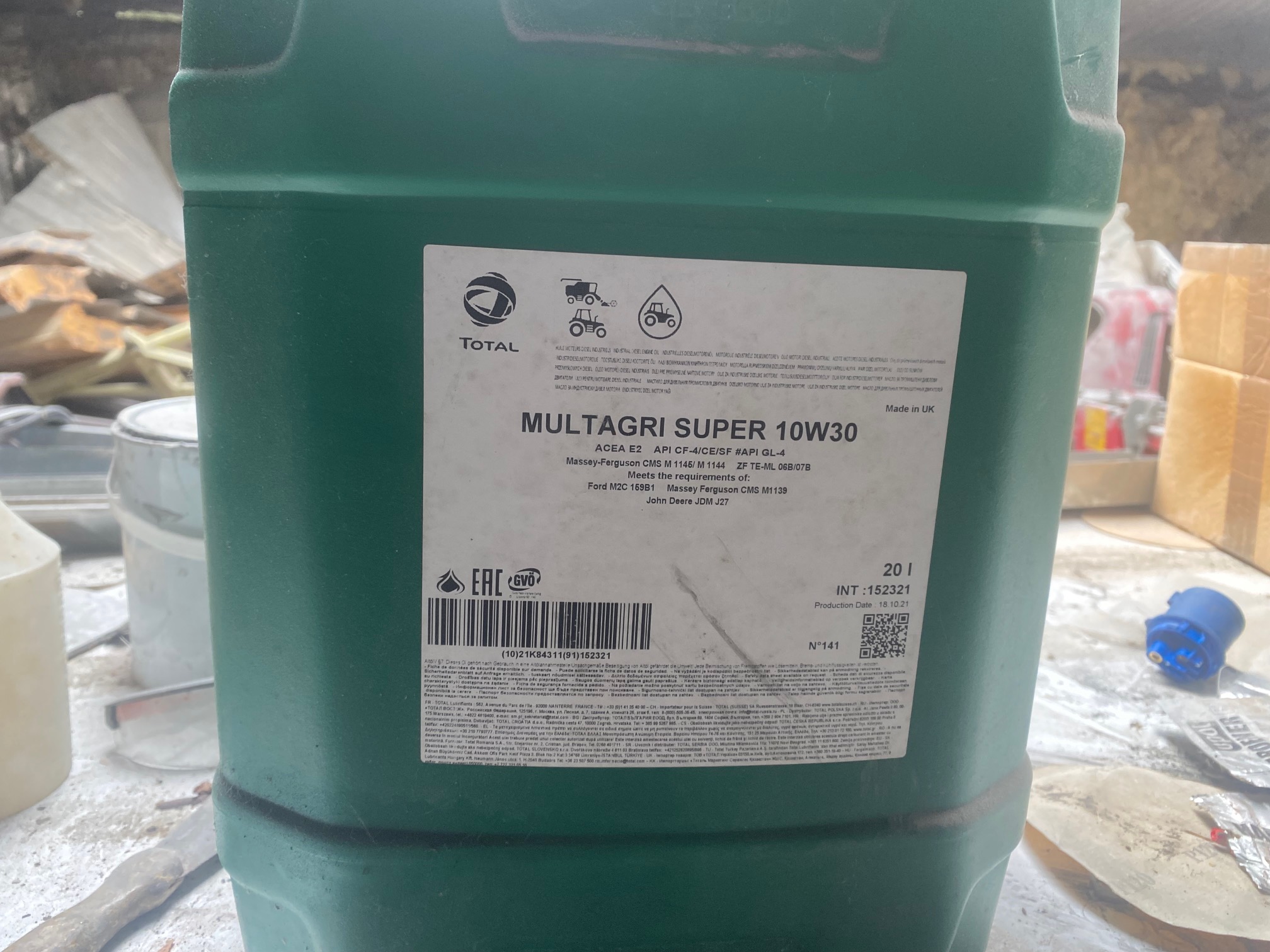

I'll forgo my ego and reveal the issue, in my defence I have had no tractor ownership experience & I went to a reputable tractor shop for the offending item & had used it a couple of years without issue, however after prolonged used I ended up with the issue of no hydraulics,
I'm presuming the gradual increase of this product caused all the issues, but now resolved.
Thanks for everybody's input, hope this helps someone else in the future

I strongly doubt that.
