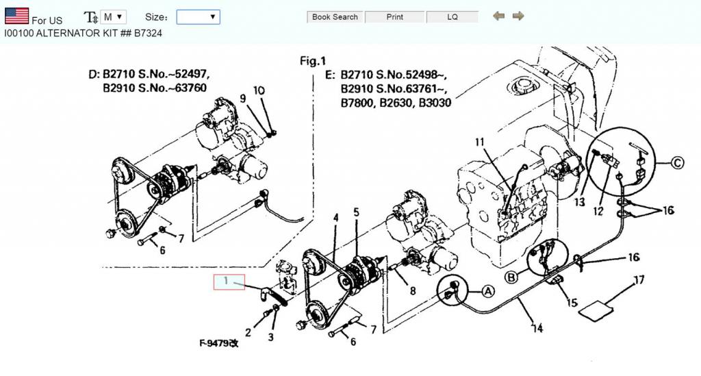

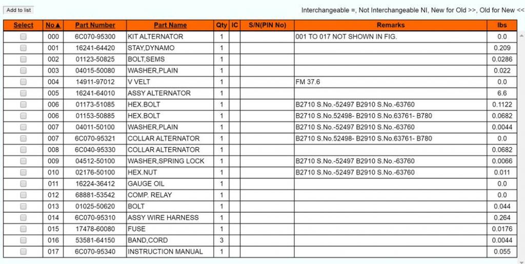

A high capacity (40 amp alternator kit) was offered through wholegoods and was half the price you're claiming for the conversion. I don't know if it is available, but the Order code is B7324 40 Amp High Capacity Alternator Kit (B2710, B2910, B7800,B2630HSD,
B3030HSD (Std. on B3030HSDC), B3200
Quick search revealed this for $217.
https://www.colemanequip.com/parts/details/KubotaParts/ALT-KIT/B7324/
Typically these wholegoods kits are complete with everything needed for the conversion including directions. If the individual parts purchased through parts the price will be much higher.
Is this an option for you at this price?

Be aware that wholegood items can be obsoleted by Kubota at any time without warning.
Attached are the contents of the kit in the event it is helpful to anyone in the future. Info taken from https://apps.kubotausa.com/illustrated-parts/ after entering B7324
