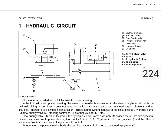

This is from the BX1880 WSM and shows how the power steering circuit is implemented.
  1. Item (3) is the priority flow divider which takes the full output of the hydraulic pump (max of 5.5 GPM) and divides it into two separate supplies
  2. The priority stream is a constant 1.8 GPM flow and is sent to the steering controller
  3. The excess stream is whatever is leftover after the 1.8 GPM is diverted from the pump supply. It is sent to the loader outlet block and from there to the 3pt control valve.
  4. Simple arithmetic tells us the maximum flow going to the loader is 3.7 GPM which is pretty close to the max your B7200 pump can produce.
  5. The pump on your B7200 can only produce ~3.9 GPM so using a flow divider and this PS controller on your tractor reduces the max loader supply to 3.9 - 1.8 = 2.1 GPM. Its going to be about half as fast as it is now.
Does that help your understanding of prority flow dividers any?

Thanks Dan. Yes, it does. I was wondering if there priority valve always takes the steering flow even when there is no steering happening - this makes it clear.
