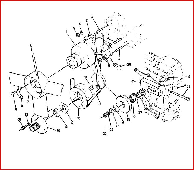

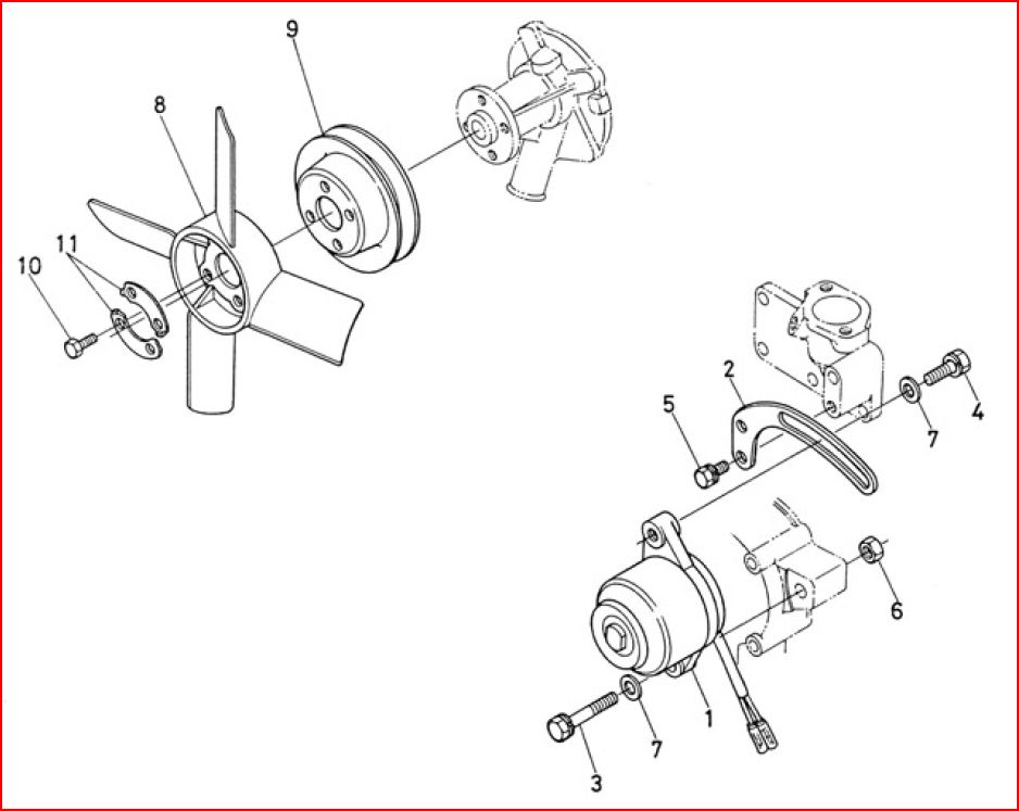

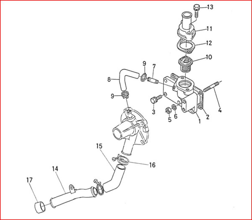

hi guys, i do have a query on this guys.
I have a mid production run B7100d and a late run B7100hst-d and both have water pumps.
They both have the side mounted dynamo's unlike you guys that have the top mounted dynamo with the fan on it, whereas mine has the fan on the waterpump.
I have been looking at the kubota workshop manual for the 70mm series engines which does tally up with mine.
By anychance is the D-750A engine fitted to yours only a US version , mine over here it appears to be the D-750B unit as per workshop manual. If so, it may account for why i was having issues with hose diameters between radiators, the larger hoses on the non-pumped engines and smaller ones on the pumped units.
both my 7100's use the smaller dia hoses and both sets of hoses are indentical eventhough there is about a 6 year gap between them.
whereas the rad i got from a late B6100 uses the larger hoses, but it also has the dynamo fitted to the top water outlet on the head and not the side fitted dynamo as on the 7100's.
attached pics of the D750B setup, same as my mine, last pic is also b7100, but same as the late B6100 i took the radiator from with the larger hoses etc.
I reckon its a D750A and a D650A
can anyone clarify things,or am i just going on about a load of rubbish.......

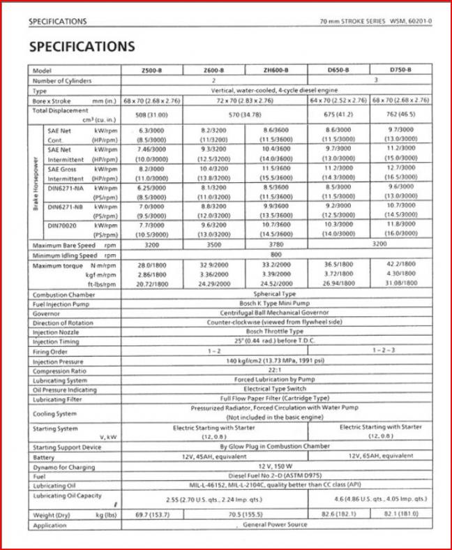

I seem to have aquired lots of B6000/b6100/7100 etc manuals and workshop manuals over a short period, probably too much to be honest.
In all of the B7100 paperwork , none show the waterpump and thermostat, they dont list the engine version as the D750-b either.
The only manual that actually shows the correct engine and electrics spec as far as my model is concerned is the Kubota wsm.
page attached.

well i appear to have resolved the issue of water pump or no pump,
Its a Uk thing.
I spoke with Kubota UK today and they explained the possible confusion etc, they confirmed that the uk spec 7100's were suppied directly with the 750-b unit which has the water pump.thermostat and side mounted Alternator (not dynamo).
something to do with needing more power hence the fitting of an alternator over the normal dynamo.
This also clears up the issue with wiring diagrams also, the 7100 in the uk have the revised wiring loom which does not appear in the normal 6100/7100 owners/users manuals etc, but is in the kubota 70 series engines workshop manual.
You see, there are a few benafits of living on this little island, not many, but a few.

I'm interested on add a water pump to my b7001.
I'm not sure if possible, and looking pictures i think there is needed something between pump and piece numbered 1.
Could anyone post part list with kubota references to get more info?
Pictures from a d750 with pump on it, would help to.
Thanks in advance.

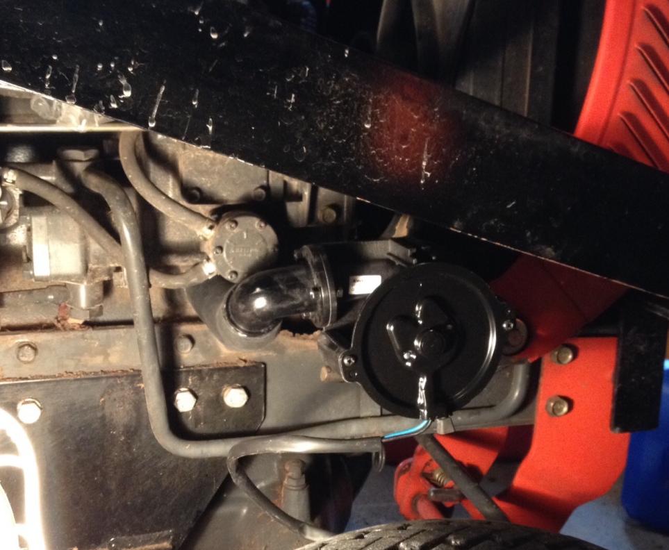

I just installed a Davies, Craig electric water pump with controller on my B7100HST. It took a couple of afternoons and several trips to Autozone for hose, etc. So far it works well, no overheating even after lugging engine with box grader. $400 online from Pegasus Auto Racing Supplies. Well thought out kit.

Interesting set up. I never thought of putting one in the lower radiator hose.
Thanks for posting the pictures.
