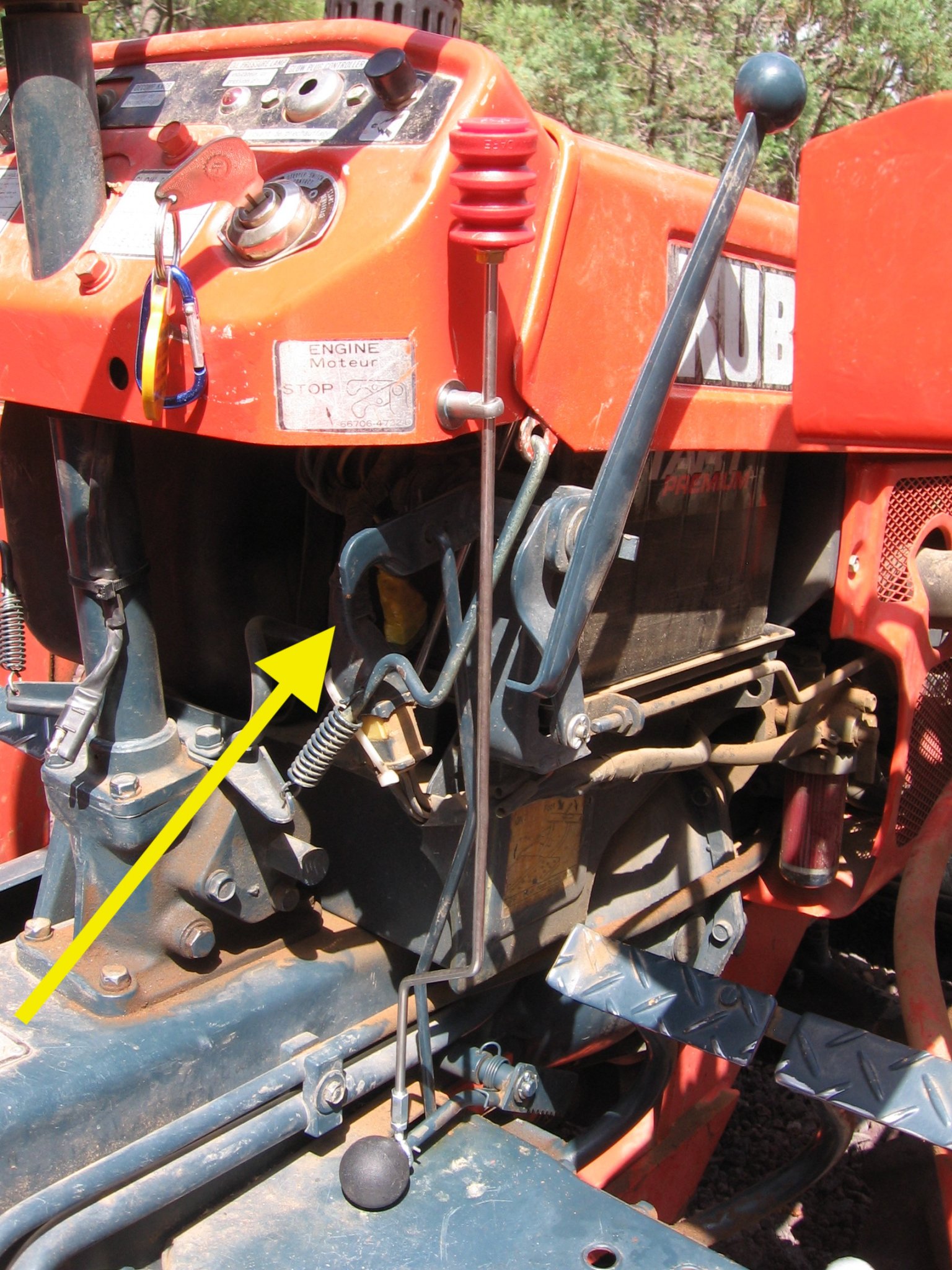

OK, now I'm totally confused. :confused:
On mine, and others I have seen or driven, you pull the throttle lever towards you to increase speed & push forward to decrease speed. To shut down, you push the throttle lever forward to idle speed, (as in pic) then pull the "trigger" (yellow arrow) upward to kill the engine.
Does the other style only come with the HST? (mine is gear drive)

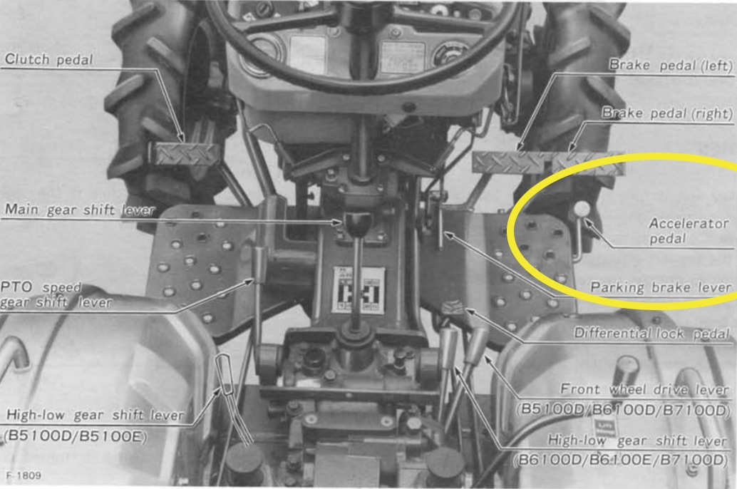

Does everyone have a foot accelerator also? Or is it only on gear drives?

My B7100 New Type, throttle forward increases RPMs, rearward to idle. If you pull rearward against the spring, that is the Kill position, throttle lever stays in OFF position.
Only the gear drive units have a foot throttle on any Kubota tractor.
Only a gear drive B7100 has the little separate lever to kill the engine.

I betcha as the early ones came out, the forward off, flick the lever up to kill the engine was replaced with pull it down- hold and you get two-for-one.

Makes sense (now that I think about it) that the HST doesn't need a foot throttle.
