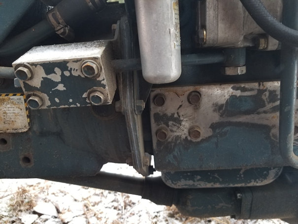

The suction line, the upper and larger of the two lines already has a flexible section in the line. now the front of that line on a HST is solid (goes to the cooler), there you just need to remove a clamp to give it some play.
The pressure line, lower and smaller of the toe lines CAN NOT be cut and have a hose section installed.
Just do like torch said, remove the bolts on the block and line clamp and pry it a little to get it to fit.
Suction line flexible section:
Pressure line block:
