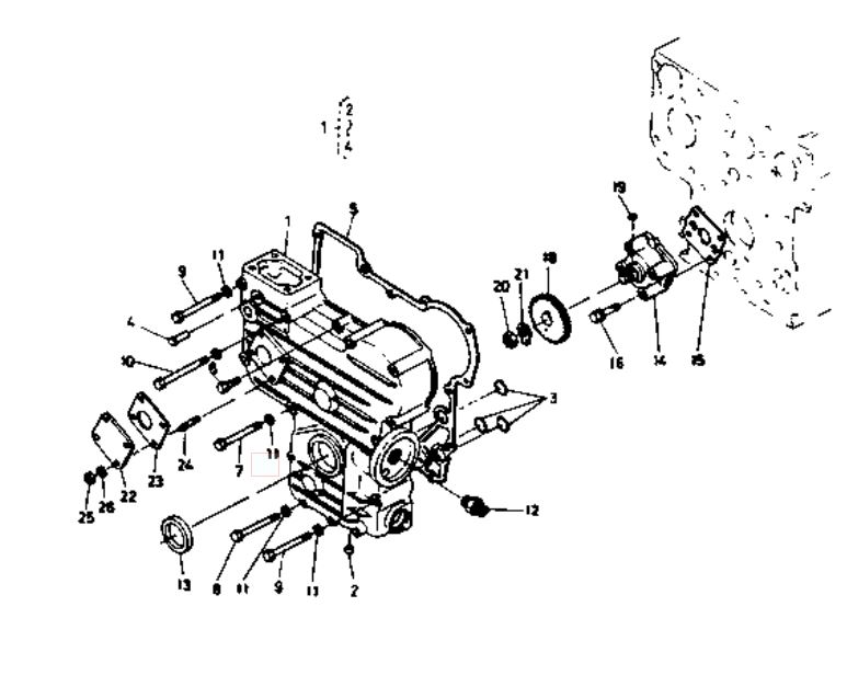

Hey Everyone,
So I ordered the parts to perform the repair, but after looking over the exploded drawings that North Idaho Wolfman provided me with, I think there might be a few more things I should add to the order…
O-Rings shown in the third drawing marked #3
Gasket in the third drawing marked #13

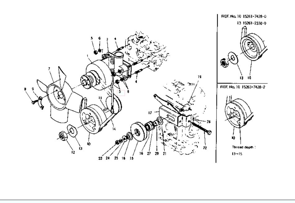

Also, since my tractor has the front-end PTO, that item needs to come off. After pulling it though, there looks to be a nut behind it holding the crankshaft on. Does anyone know what size nut that is so that I can get the proper socket?

Hey Everyone,
D2Cat, my hand is doing much better but I am unable to move that finger now. It’s a little more difficult now picking up small bolts :D
Kyle
IIRR, its 37 mm. Nut really isn't torqued real tight, you haveta bend the locking washer, to get the wrench on, though...:D:D
