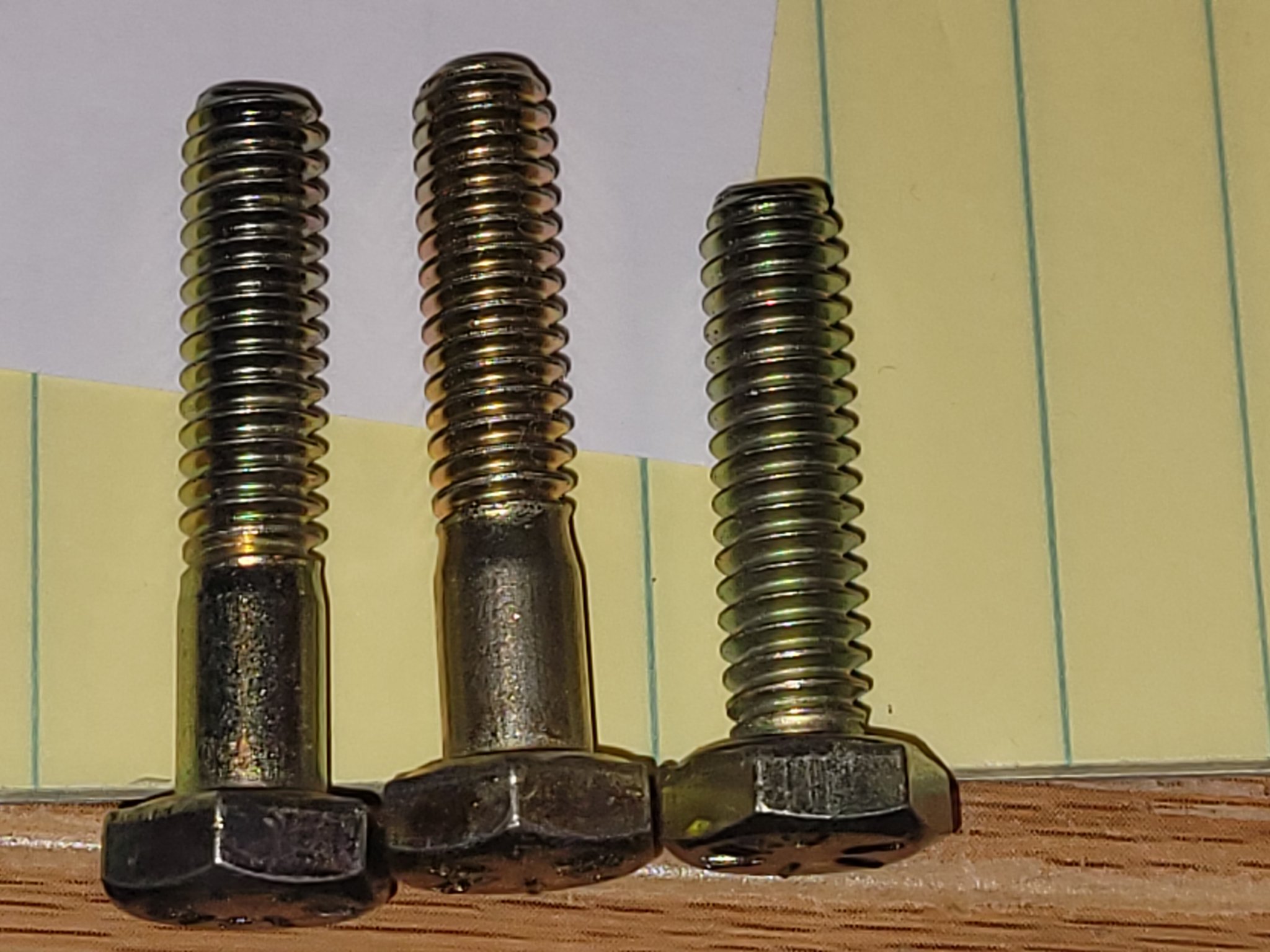

Other than the one on the right being shorter, because the description from online sources and the dealer were all wrong, any difference?
All three are grade 8, 6 lines on the bolt head(hard to see it on the right one but it is).
One is a dealer bolt.
One is a local fastener supplier bolt.
One is a Home Depot bolt.
Local dealer is out with no ETA on fan shear bolts so I am looking for other sources.
Since the dealer bolt appears to have NO groove or alteration, I would say these are equal substitutes, get a longer right bolt.

Grade 8, 1/4-20x 1 1/4"
Apparently this blower can take either depending on the serial number. Mine is the 1/4".
In the photo of the 3 bolts, the one in the middle is from the dealer!!

The place I bought them is like
I would go to www.mcmaster.com and check the cost of that bolt in quantity. A fully threaded 1 1/2" cadmium plated grade 8 bolt is $8.69 for 25 pieces.
The place I bought them is like mcmaster-carr.
I only bought 10 each nut and bolt in case they don't work.
$.22 for the bolt
$.11 for the nut
Might be cheaper in a bulk amount.
Home Depot had the nuts in a 100 count for $8.20 and bolts are $.32 each.
McMaster-Carr is $15.88 for 100 count.
