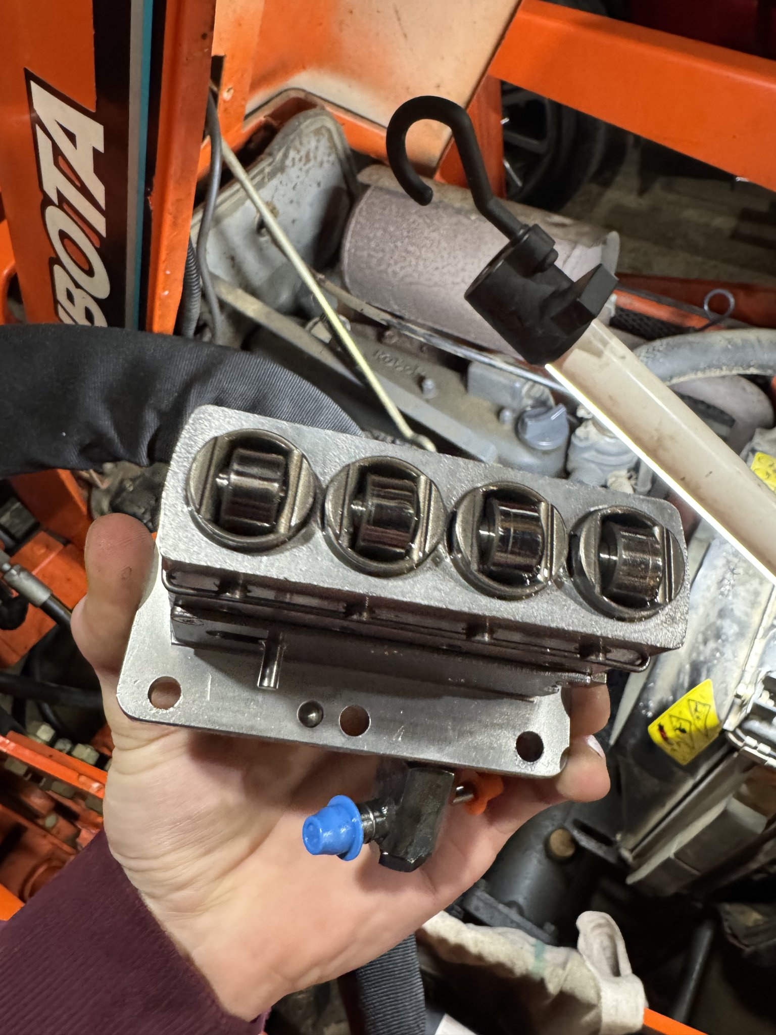

Still wasn’t the fuel shutoff switch lol. It’s completely out of the way now it goes all the way down but the front roller hits the cam lobe and won’t go down any farther 😂 go figure looks like they gave me some sort of after market pump housing or some shit and it’s the wrong one. Have no clue why it won’t work at this point. About to just hire a professional i don’t understand at all it should be just dropping in place right now.
Crazy guess but do those rollers go up and down? And if so would removing the blue caps allow it to move up? If so after a rebuild now that I know everything is going in right do I kinda have to get those rollers to seat correctly around the cam lobes?

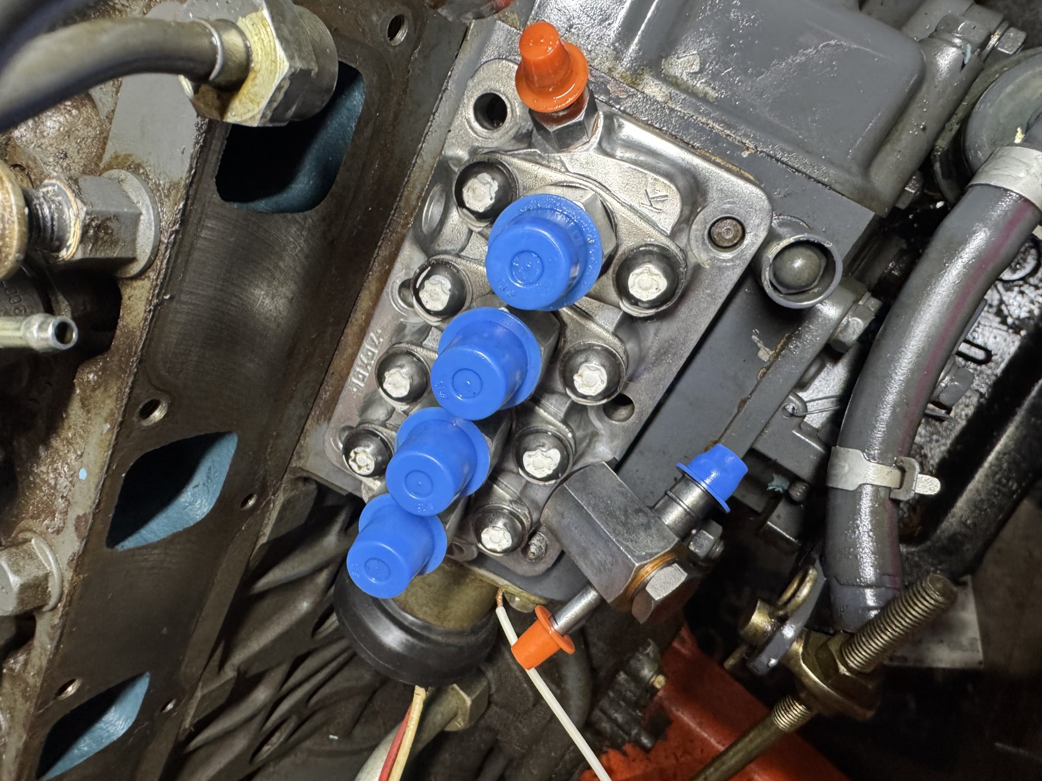

Crazy guess but do those rollers go up and down? And if so would removing the blue caps allow it to move up? If so after a rebuild now that I know everything is going in right do I kinda have to get those rollers to seat correctly around the cam lobes? Also am I aiming for the gab or the v? I can’t tell from their stupid drawing of the back side of where it goes that you’d only be able to see if I cut the engine block out.
Blue caps
i removed blue caps and didn’t push on it hard enough to break anything etc and constant pressure to see if it’d go down and it didn’t. Must be some crazy thing I’m missing here getting pretty frustrating at this point to be honest. It has got to be the linkage stopping me from getting it and I should be aiming for the v but there honestly isn’t anyway to get it into that.

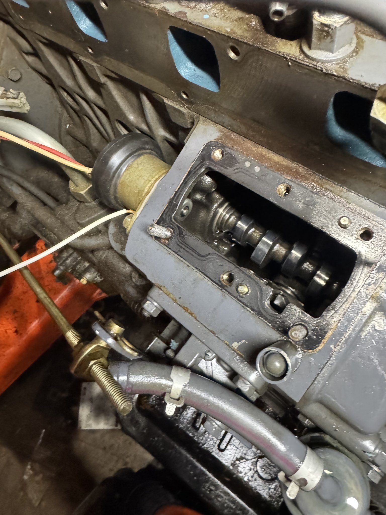

So I’m pretty positive I’m getting the pin into where it needs to be. I watched a YouTube video of a similar tractor but 3 cylinder and the guys pump kinda did the same thing but he had his side cover off and after everything was in place he just put the bolts and nuts on and righted it down to it went completely down. Is this how I would do it too? I think I have enough of the studs etc to tighten it down after it’s in that position. Just not real sure. Calling it a night going to do research and figure out as much as I can.

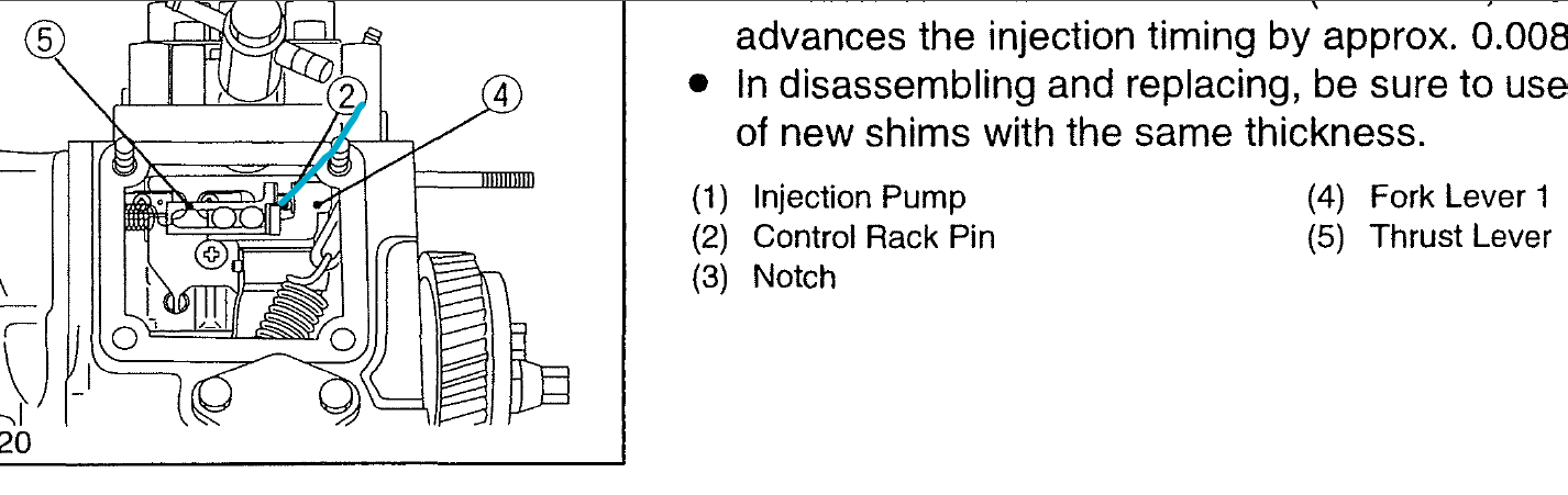

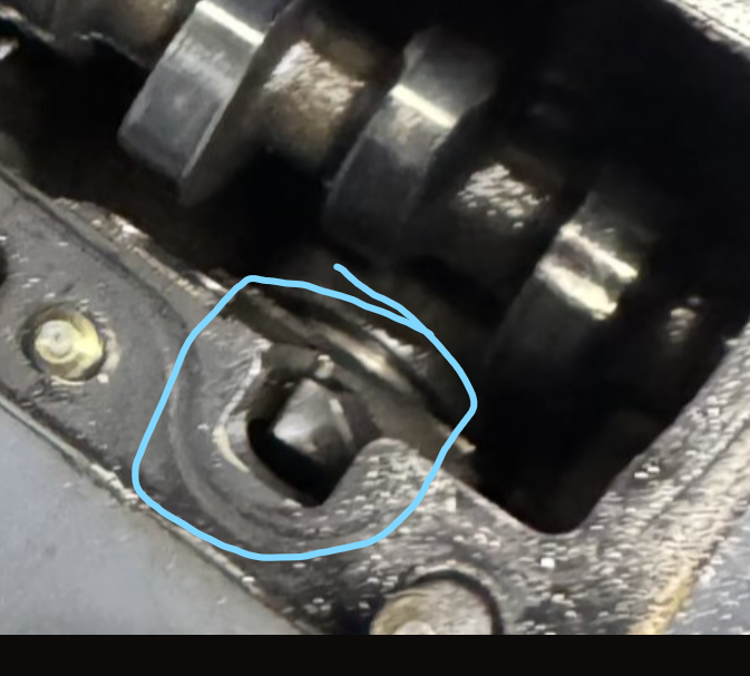

4 is the V, so not in the V but 2
Pull the side cover as you will be able to see what's going on in there.

I've done quite a few of them, and I'm lost as to why your having issues too.
It is possible that you've got a lobe up on the fuel cam, that will make them feel odd putting it in.

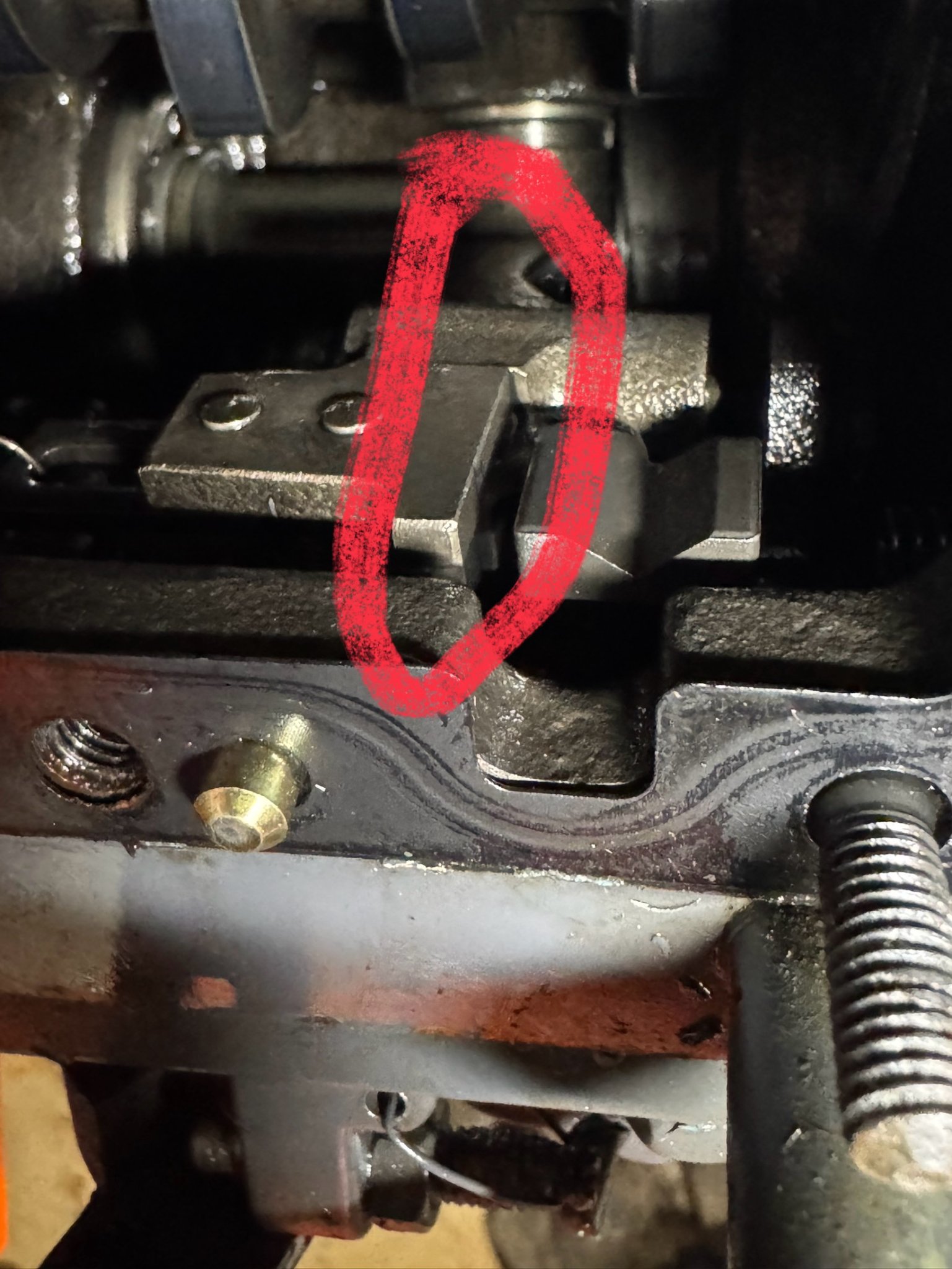

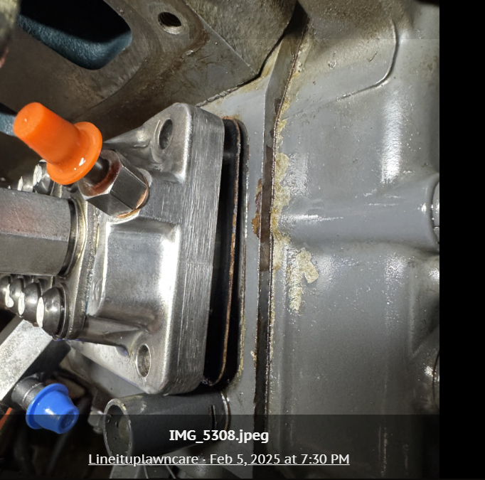

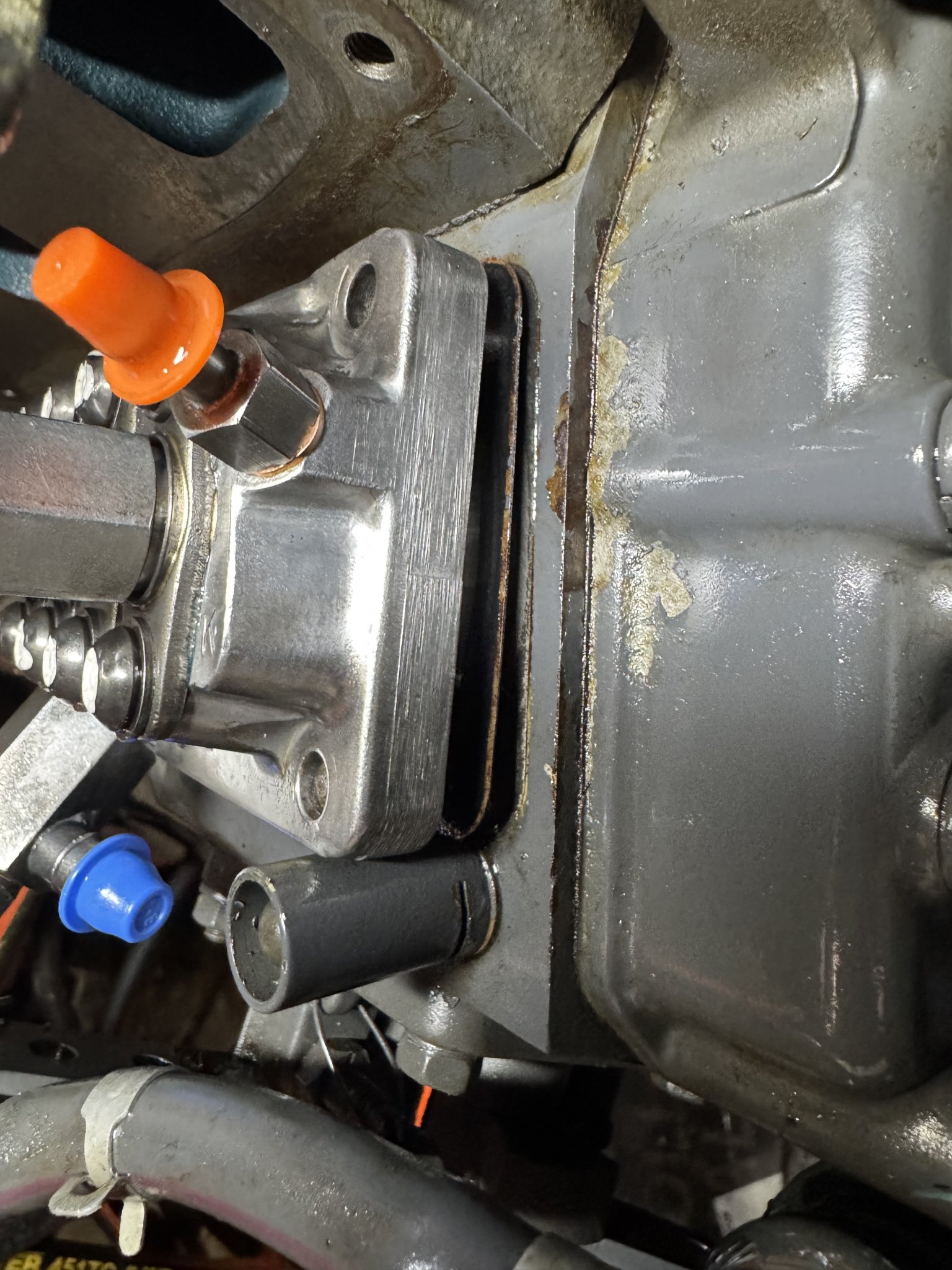

This right here is most likely your issue.
2 more manuals both verify that it goes behind the V not in it.
36,469
11,249

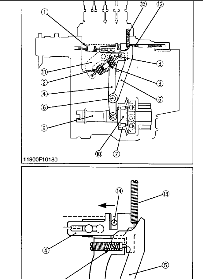

This picture tells me your not getting the rack pin in the proper location on the governor linkage.
Yeah the front lob is on the highest setting and is hitting the roller of the pump. I was a good 99% positive I was getting the pin lined up properly etc. the wider I open the thing on the side the wider the gap gets for the pin so it should drop in fairly easy and I think it has the whole time. I honestly just think I’m going to have to put the nuts on and tighten it down and see what happens. I think I might be being a little too gentle with it and it’s just going to taking some presssure to get it to seat down all the way because it was just rebuilt. I really hope it’s just that. I hate to push on it real hard but it’s either that or put the bolts in and tighten it up. Ps it’s probably just me, I’m working on something that’s a little over my pay grade and I don’t really know how it works. I know how valves work and I assume the pump rides those cams and goes up when it’s supposed to fire fuel.
36,469
11,249
Read into this more you have the very early style governor linkage, I don't think there is a slot in the front of the V, I think the pin might have to fit into the v.
This has been an issue before, as the other style has a second slot that the pin can fit into that is also wrong.
