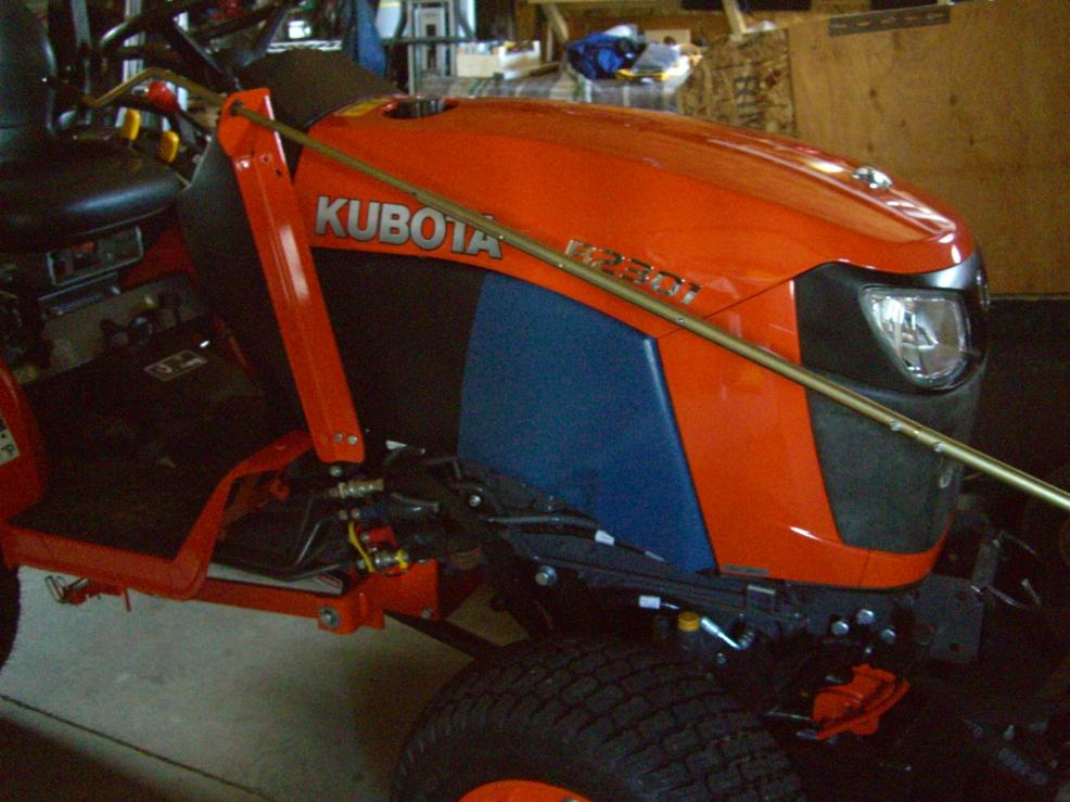

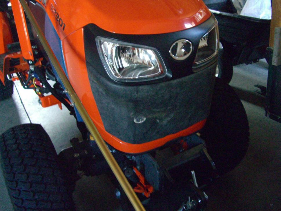

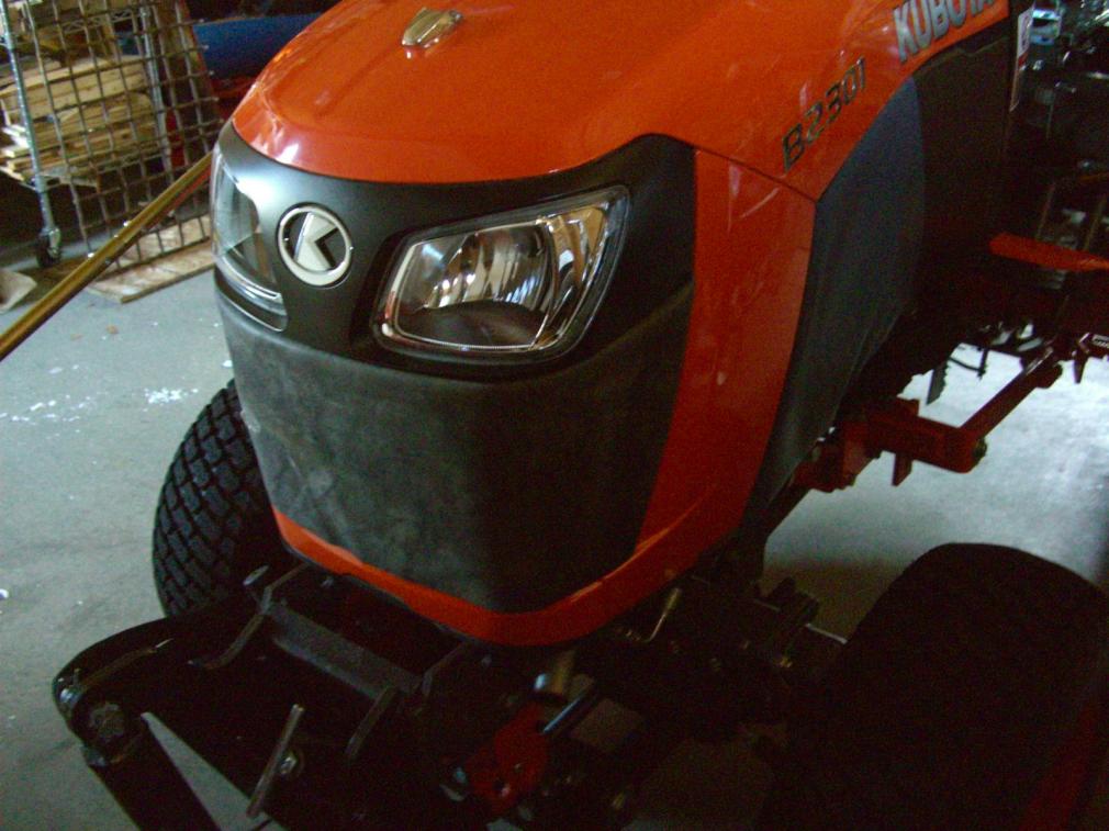

Having previously spoken to my dealer about the potential of this happening and seeing the reality I decided to try a snow shield or intake pipe mod.
The intake at the filter housing is 1.5 inch OD - I did not have a 90-degree bend so I moved to the shield.
I was going to use some offcuts from a fertiliser bag but that was very rough.
Used some side sheeting from a trailer and used that on the sides - laced on with some zip ties and it looked OK.
Then I found a bit of rubber pool liner so I used that on the front. I think it is better but I will evaluate both.
To do the front I released the 3 bolts holding the light housing on and the 1 bolt holding the bottom air intake grill. Stretched the rubber over, cut 4 slots for the side mounts and 1 for the bolt and refitted, looks OK.
We will see how effective it is in operation.
Sorry it is not orange, but I though blue was a nice contrast.

That came out nice, I wonder if the kubota kit blocks the front vents like the JD one. I just want to make sure we can constrict the airflow like that safely to keep the snow out.

Update to the front screens.
A couple of days ago while blowing about 3 inches of wet heavy snow I noticed the temp rising, not much above mid position, I decided that I probably had too much restriction so I removed the side panel covers.
Today I needed to move about 10 inches and mid-way through I again noticed a rise in the temp, as I was not quite half way through and only running about 25 minutes I decided it was again too restrictive. Removed the front unit and the temp immediately dropped to just above C. It was +2 C so maybe if it had been colder it would have lasted the entire time but I thought better of it.
I still have the modified intake pipe in place and that seems to be working without issue. I opened up the filter and it was clear and dry.
I think that any shielding would have to used only when the outside temp is well below freezing.
