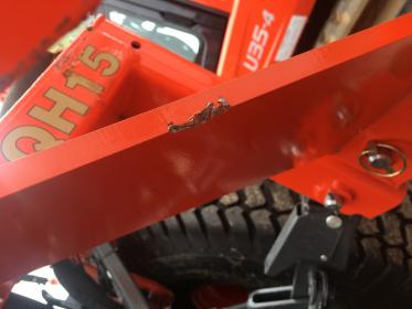

Yeah I don't think any of it is functionally impairing, it's just "new" banged up in some spots.
I spoke with the salesman, and he apologized for the damage and said he would talk with the owner and determine a course of action. Asked if I would be willing to take a discount on it, which I said probably since it didn't seem to impact the use of the implement.
I tend to keep my tractor garage kept and out of the elements, so I was pretty adamant with the salesman about it being factory new.
I guess I'll see what they say discount wise. The should probably clean it up and paint it to prevent the rust (or I'll do it when I get it).
What do you think a reasonable discount is for the damage?
The other thing that seemed odd that the salesman mentioned is needing to get this contract completed before end of month. It's on the August promos, which I secured before they expired. Not sure why the end of month is important for those promos, or he was really just trying to push this to completion (i.e. kind of telling me if I wanted to replace the BB due to that damage, then we were going to have a problem with the promos).

Ok I'll see what they say. Chances are they'll knock a bit off for the damage.
Sorry about the small and sideways pics posted here. Here's a link to an album of all the QH and BB damaged areas.
https://m.imgur.com/a/KMLjp8L
The worst gouge is probably from a forklift moving the BB or something. Like it was wedged in the arm. Both the arm and the attachment base area got marred up.

I always feel that talking gently about things gets a better outcome - sounds like they're going to look after you.
On the one hand, it's a tractor, once you use it it'll get dings and scratches (at least, if you're using it right it will). On the other hand, you paid good money for a new one, it's your right to put scratches and dings in it, not theirs.
If it were me, I'd angle for a free or discounted implement of some sort. The discount will be forgotten soon enough, and you'll still have scratches. But if you have a free implement, then every time you see one of the scratches you'll look over at that free ballast box, and think - that was worth a scratch or two.

I agree. New is new. A few of those scrapes could be forgiven, but the big gouge on the BB arms is more than I would shrug off. A discount is in order, or they can give you another that isn't marred up for the the new price.
