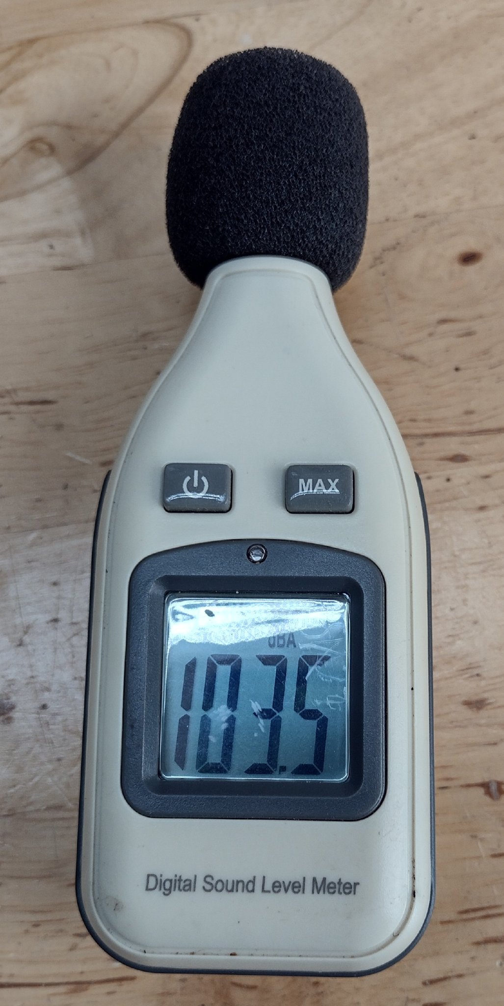

My LX3310 cab is loud but bearable with normal pedal operation. Set the parking brake or engage the cruise control and I need hearing protection. Max speed in medium range with the cruise control set will hit 103dB. I put some mat pieces in but didn't go as far as doing dynomat and it made no difference. That is because all the super loud noise is being transmitted through the linkages.
