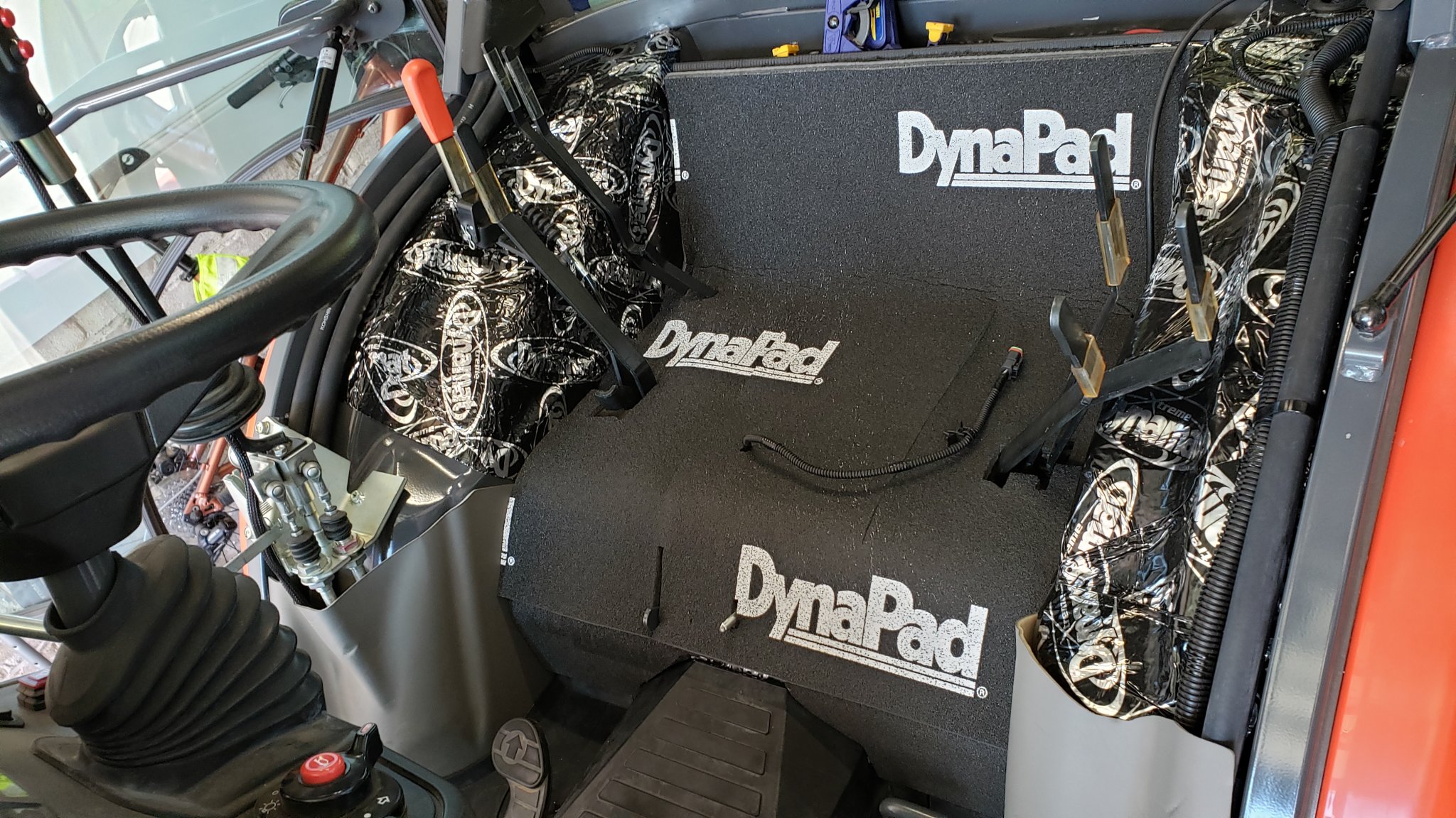

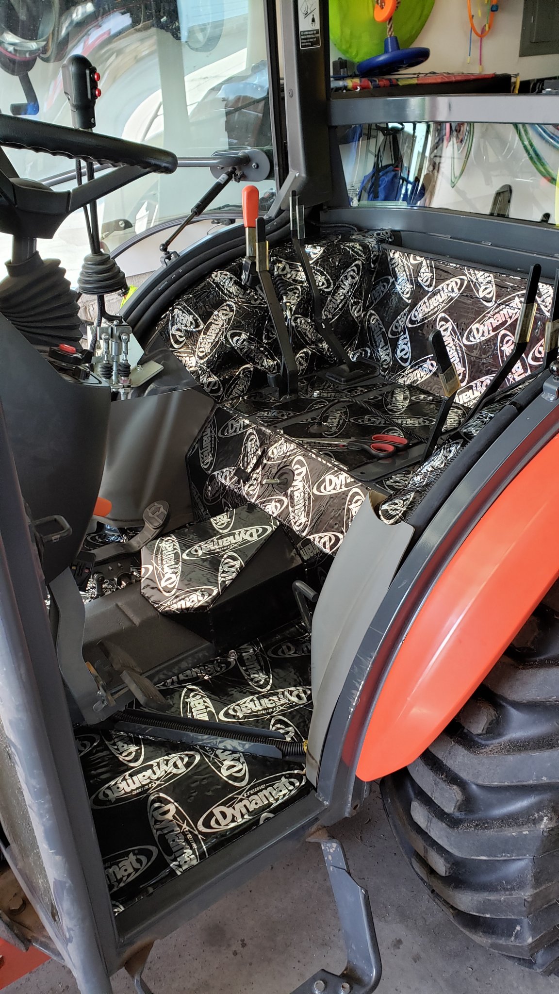

Nice work with the dynomat! I've never been in a cab version of the B series. My Grand L 60 has the quietest hydro I've ever used. The loudest was my L2501.
As for A/C performance, tinting the windows is a big help. On a sunny day, you're basically in a greenhouse.

Any updates on the dynomat? I'm curious if you find the factory rubber mat moving around or moisture getting between the rubber mat and dynomat?
I don't notice the factory mat sliding. However the thickness of the sound deadening under the mat is the same as factory and the factory mat is a snug fit.
Regarding moisture, I keep the tractor in a garage and don't work in the rain. If I work in the rain I have to deal with ruts later.
I did notice the noise reduction, maybe this year I will get around to tinting the windows and reducing the noise from the hst pedal.
I was less concerned with rain than I was with snow. I didn't realize that there was anything under the mat so thats good to know. I was going to do my 2610 but ordered a LX3310 last month so I will do it instead whenever itcomit comes in.

has anyone tried adding any kind of rubber grommets or bushings around the mounting brackets to isolate vibration even more? I've been looking into this for my B2601 cab and wonder if those small changes might help reduce certain frequencies. Would love to hear updates if anyone’s tried anything else since the last posts.

I added mass loaded vinyl and closed cell foam from https://resonixsoundsolutions.com under the cab floor and behind the seat, and it made a noticeable difference. It’s not dead silent now, but way more comfortable on longer runs. I didn’t bother with the ceiling or doors yet, but might later. Everything stayed in place fine, even with temperature swings.
