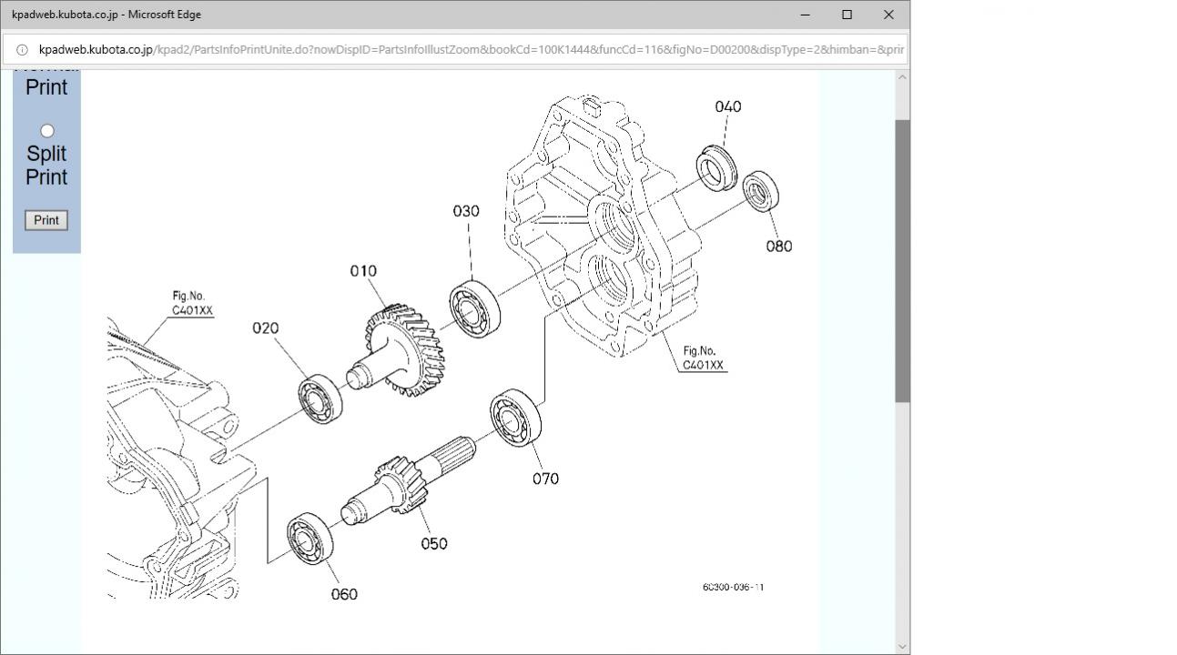

I can't figure out where the 4th plug is. I have opened the one by mid-mount PTO and two in the back, but where is the fourth one? I believe it's the one on the below picture labeled as transmission case, but I can't locate that, mine doesn't look like that.
Both the operator's manual and work shop manual only list those three plugs, nothing about the one by the transmission case. What am I missing?
Bolted to the back of the clutch housing is a gear case that Kubota refers to as the front transmission. The 4th drain plug is on that.

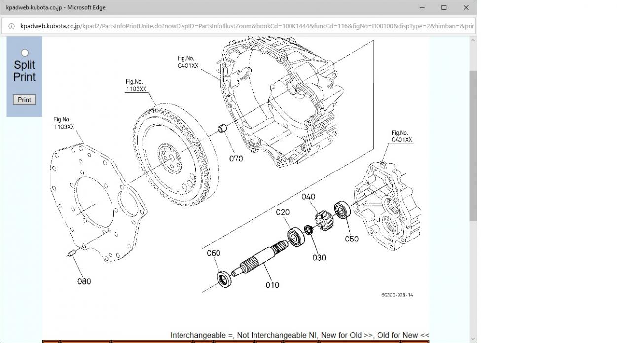

There's no fluid in that one though. It's for water or moisture is it not?
It has gears and bearings in it. It has hydraulic lines running to it from the hydrostat transmission. It has fluid in it. Here are the parts break-down from the Kubota site.
Thanks guys, this was gold! I got another over half a gallon drained from that plug, so I'm now little over 3.5 gallons total of 4 listed on the spec sheet for the tranny oil.
I found this plug from the work shop manual, but it is listed under clutch section, and not on the service and maintenance section for transmission fluid change. Go figure.
