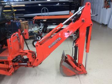

I know there must be a manual thumb kit from kubota but i have spoken with 2 dealers one being (messick) who say the only thing that fits the b26 with the BT820 hoe is the powered thumb and that kit is 2000$ for parts only.
something similar to this,
I cant post the link because of a post count its a manual thumb at bxpanded
I know its not listed as fitting. The hoe comes with the eye welded on for the top already.
Thank you for your help, I have spent hours trying to find this.

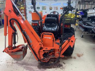

This is the thumb on my BH77 hoe, looks like what you need? I could send measurements if helpful. IMG_20190327_123238437.jpg

This is the thumb on my BH77 hoe, looks like what you need? I could send measurements if helpful. View attachment 41795
Sent from my Moto G (5) Plus using Tapatalk
23 3/4" between end of dipperstick and thumb mount flanges pins. 2 9/16" gap for thumb bar at mount flanges with 1" pin.

Take some pictures of what you would like and of your setup with measurements to your local fabrication shop - they should be able to make up a manual thumb pretty easily. I bought the bolt on thumb for mine from amazon, and it's been very useful already.

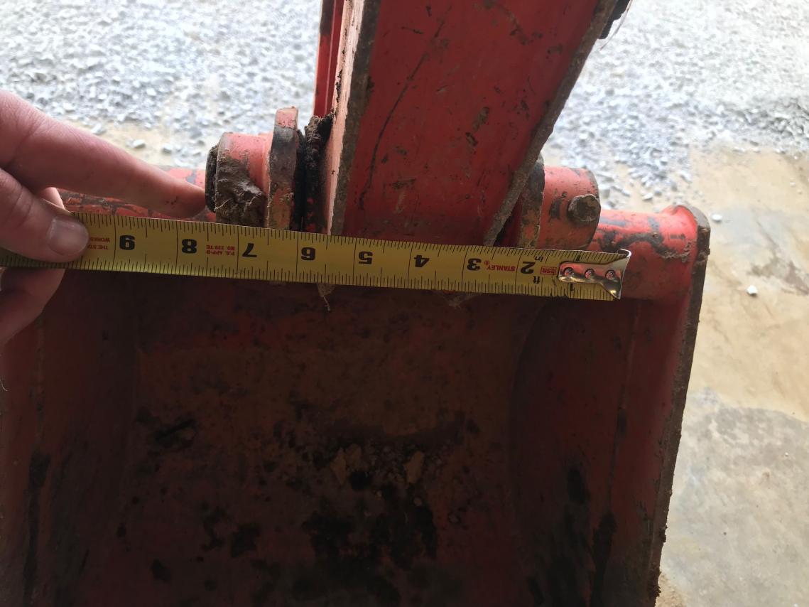

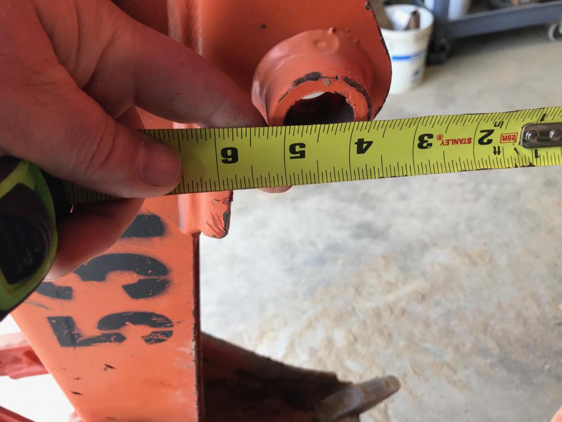

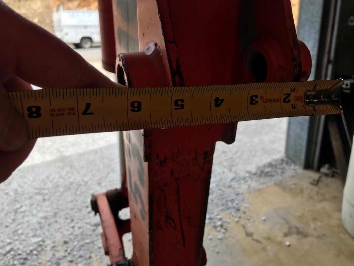

Your thumb is exactly what i have in mind, the distance between the boom ear and the main pin on the bucket i dont really care about i can cut or weld on an extension the adjustable part.
what will make or break that is:
1. the pin diameter in the ear on the secondary boom, the length of that pin when installed? I can make spacers or again cut it down.
2.the diameter of the main bucket pin as well as the distance between the ears that go outside of the existing bucket mount?
3. how long is the tooth part I dont know what else to call this the part that goes from the mount pin to the teeth on the bucket.
thank you very much in advance.

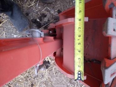

6" long x 1" diam. pin for dipperstick thumb mount flanges, main bucket pivot 10" x 1" pin, actual thumb as per photo. IMG_20190327_185758653.jpg IMG_20190327_185850415.jpg IMG_20190327_190001504.jpg IMG_20190327_190941710.jpg

The inside faces of the thumb pivot mount at the bucket main pin are 6" apart - in answer to the other question about outside of bucket mounts. All my measurements are close but not precise, using a carpenter tape, and BH is still in storage so can't reposition.

Thank you so much, Ill post up the B26 numbers tomorrow, so that anyone who looks this up in the future can see it, The Hydraulic thumb is 2k parts only. Im 100% sure i can install it but have heard its a real pain in the... The tractor can run a hammer also if I add that kit, this would be nice esp since i have some concrete that needs to go. If i cant get that to bolt on I still may go with the hydro kit. Ill post measurements either way.

This is where the good times come to an end, the bucket design seems to be totally different... Its a decent amount bigger mounts on the B26.
I'm looking for a mechanical thumb on my B26. What did you end up getting or doing?
