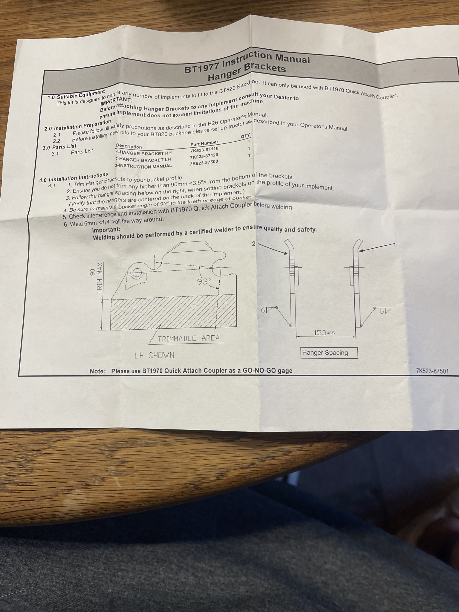

Kubota backhoe QA ear instructions.
Cost $221, freight $25
I had the part number from Wholegoods list. if you go to the local Kubota parts and use the part number they will not be able to find it. Parts manager told me to buy a bucket and cut the ears off! That’s too expensive and wouldn’t work anyway. Got the owner and sales manager involved to order them from Wholegoods.
if ordering from Messicks ask for sales not parts.
I like the adapter to be able to share attachments. Haven’t tried anything other than the ripper. Find the ripper saves time, effort and hole size removing stumps.

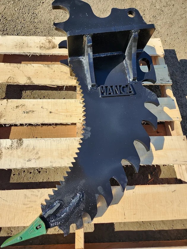

Expensive day! Pulled the trigger on the Manca 24". Nice folks, told them I don't need the ears as I will be putting on B26 specific ears and they took hundred bucks off. It'll probably take a few weeks to get everything in, migrating to the B26 quick attach system so ordered all that stuff too. Will post pics when I get it sorted
Fried1765: thanks for the Ox Thumbs heads up. Their attachments look well made and they're somewhat local boys for me, but the Manca with that serrated edge imo was just too bad ass to pass up.
Smokeydog: never thought to try the bucket sans teeth, but it makes sense for your application. I will definitely keep that approach in mind if digging near something potentially damageable.
Mikester: very impressed! Checked out your build thread on the Scorpion, looks like you did a great job. Glad to hear it does not interfere with the boom. That's a luxury I may not have when this all shakes out. I have to say I am jealous of you guys that own the larger L/M TLBs.

Great job Smokeydog! Really like the ripper and your fabrication looks stout. Find myself in need of a ripper for my B26 as we are clearing our property for projects--new driveway, shop etc. Lots of stumps. Wondering if a ripper such as this manca would be a good candidate? It is 26" and made of ar400 to fit kx 025 or 27 mini ex. Question is whether the serrated edges would be useful or just a novelty that doesn't actually help tear up roots and instead reduces the overall strength of the ripper? Thoughts?
Regards,
Jeremy
I think that the "teeth" are just frosting for that cake.
My 28 "OX Thumbs" ripper on L48 TLB, does not have serrated teeth.
Works just fine, with the machine's hydraulic power doing all the ripping work.
