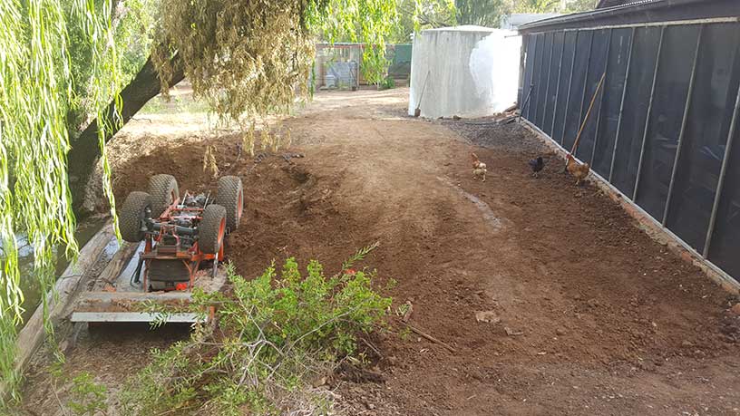

So this was yesterday afternoon. In hindsight I can see that it didn't actually get very wet:

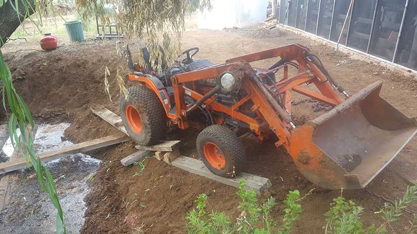

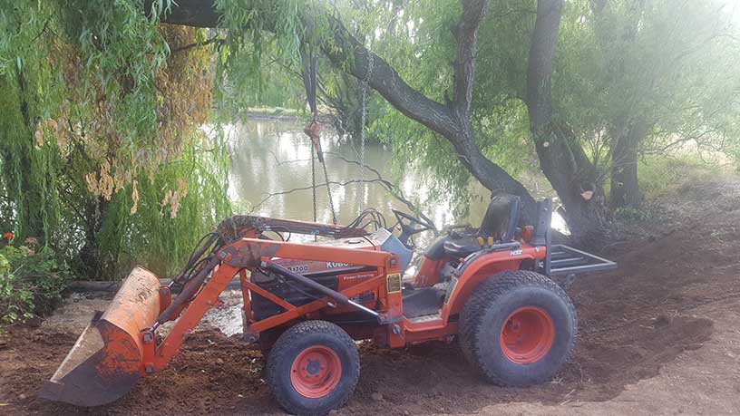

Later in the evening I figured I'd see what a chain block on that willow might be able to do. As it happens, it was able to do this. It is still on very unstable ground and would roll back in if it weren't for the chains holding it up:

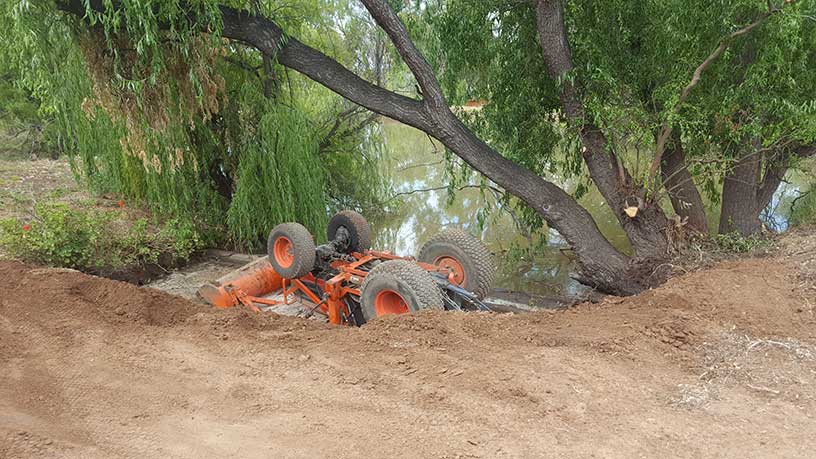

This morning I got another chain and come-along attached to the back of my ute (out of pic) and there was a lot of this:

It looks precarious, and it is, but we were only moving it a few inches at a time and constantly adjusting the two chains, chocks, planks etc.

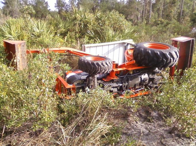

I was bush hogging along a ditch one night trying to finish a project. The ditch jogged and I didn't see it. I had the bucket up as headlights were useless when it was down, I couldn't have dropped it quickly enough to have helped once I realized what was going on.
As it rolled I just stayed on the high side, rops, roof didn't keep me from getting clear of it. But had the rops not been there it would have been upside down.
