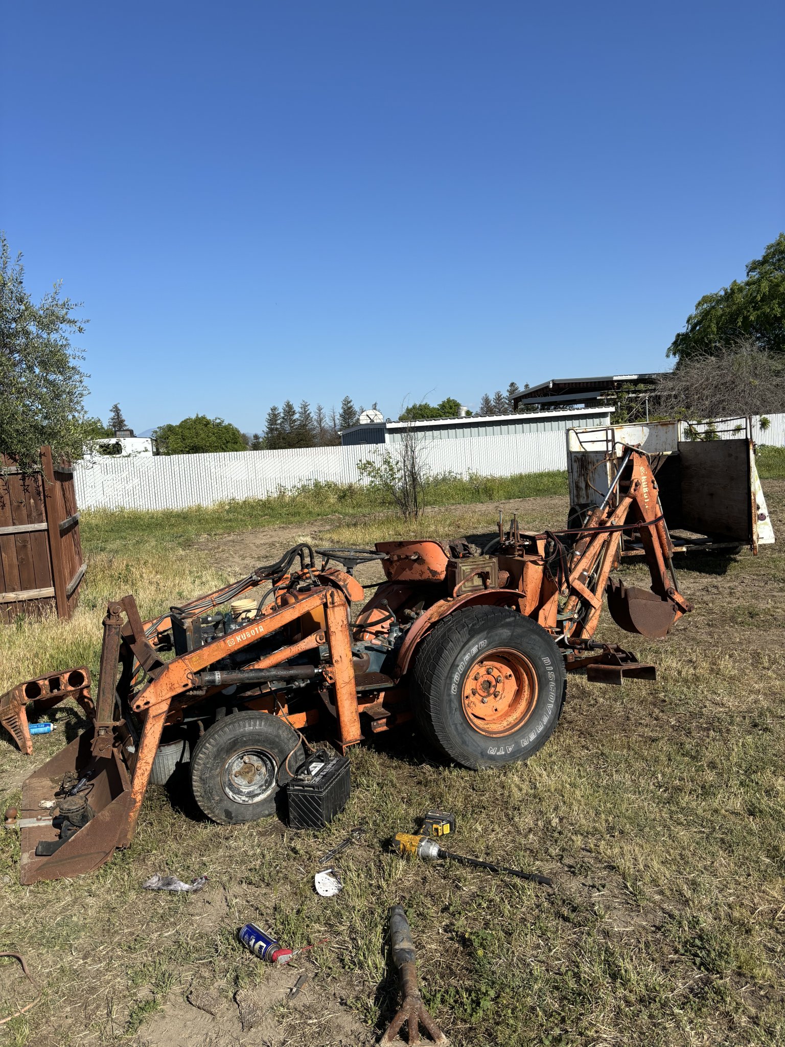

Hi guys I bought a b7100 and they made some Frankenstein modifications to the b1630 loader. I’d like to return it to original. I’m missing the front tilt rams, anyone know the size or where to get them?

The rams are missing I’m unable to get that:(

But looking at your pictures what's in front of you in not what you need.
You're going to need to get a stock bucket to get the measurements as it doesn't look like you could put the needed mounting points on that bucket.

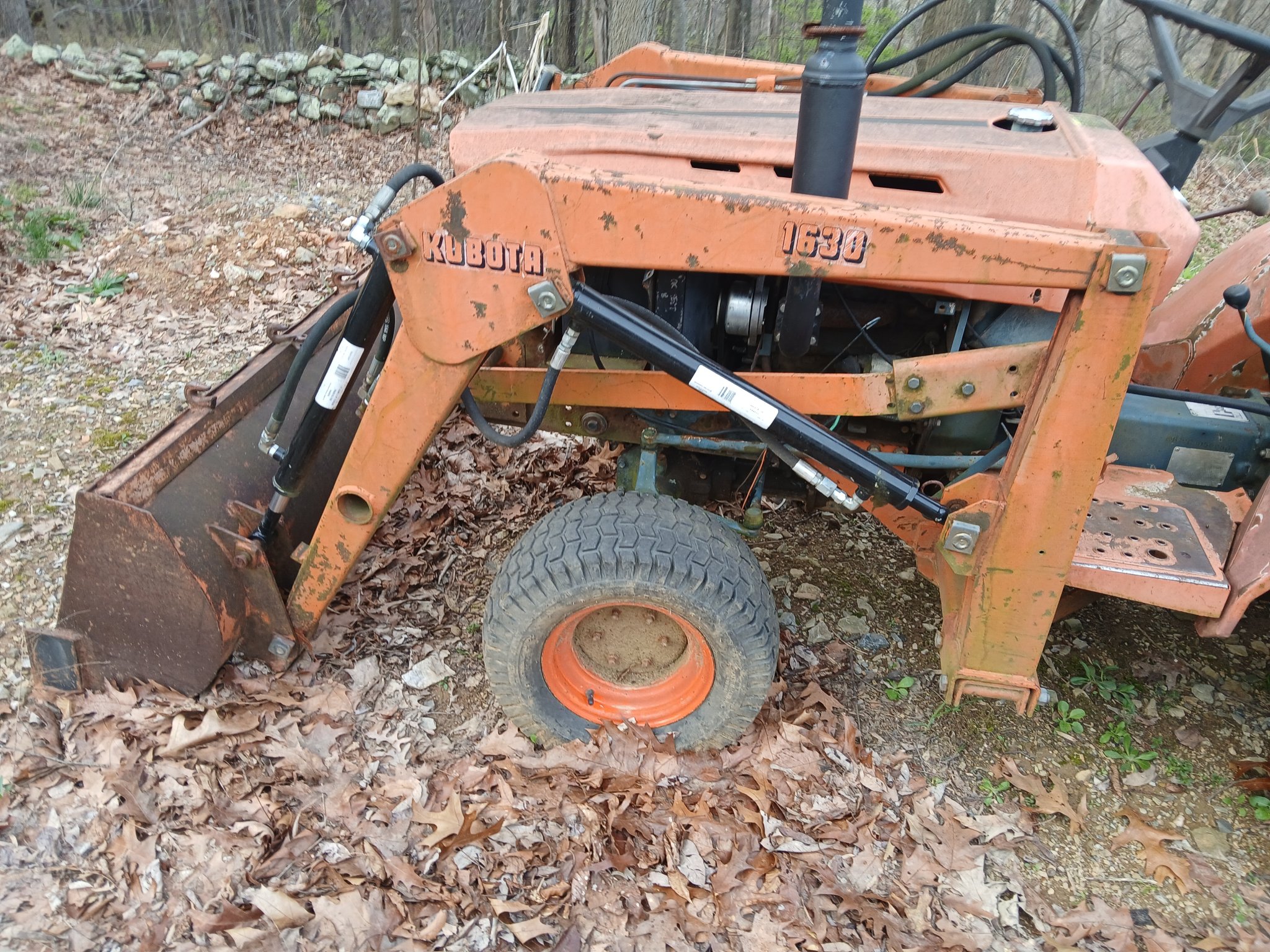

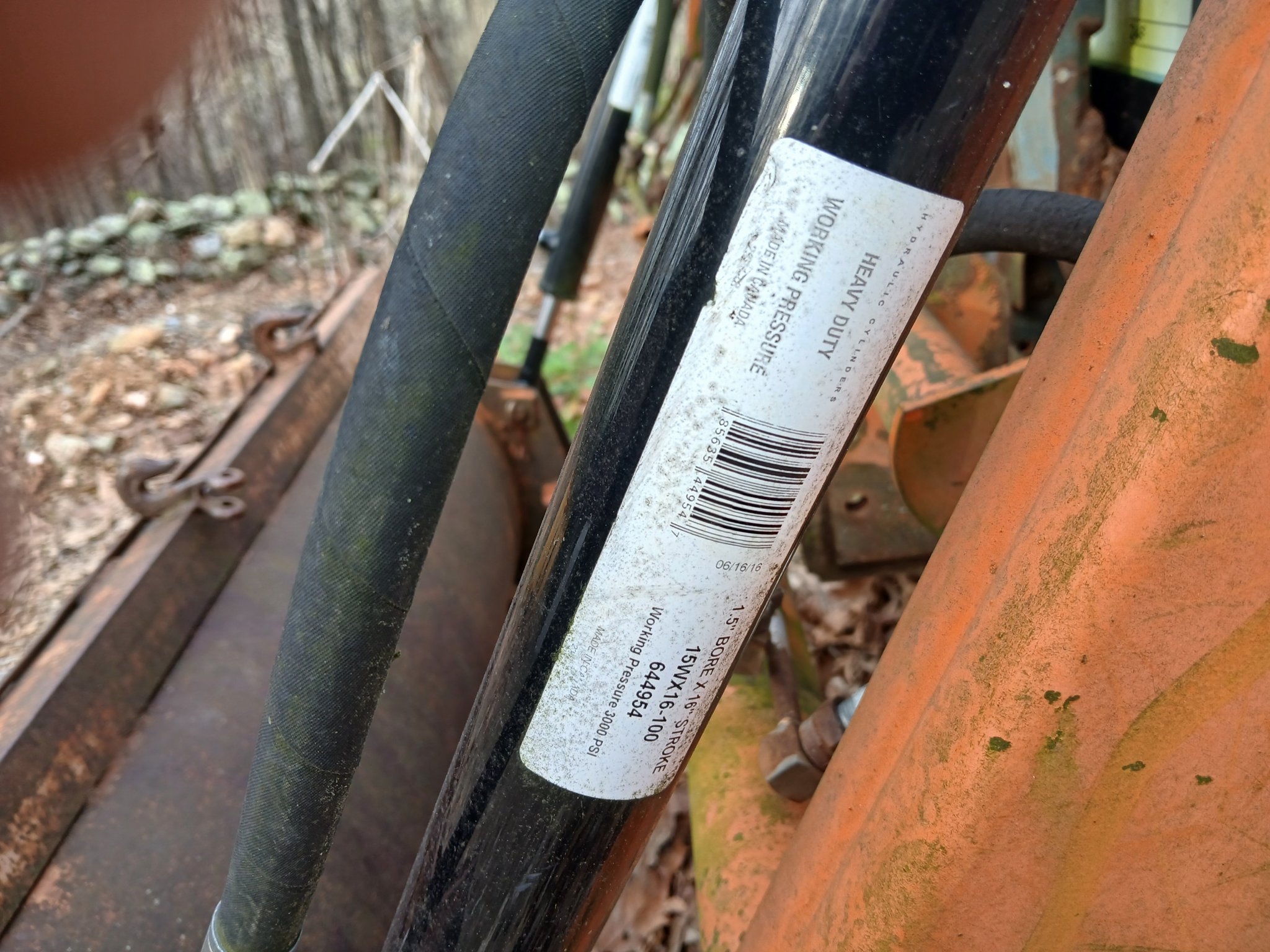

Here you go - new aftermarket cylinders on my B1630.
Bucket cylinders:
Bucket cylinders:
Going to order them now thanks Dan
