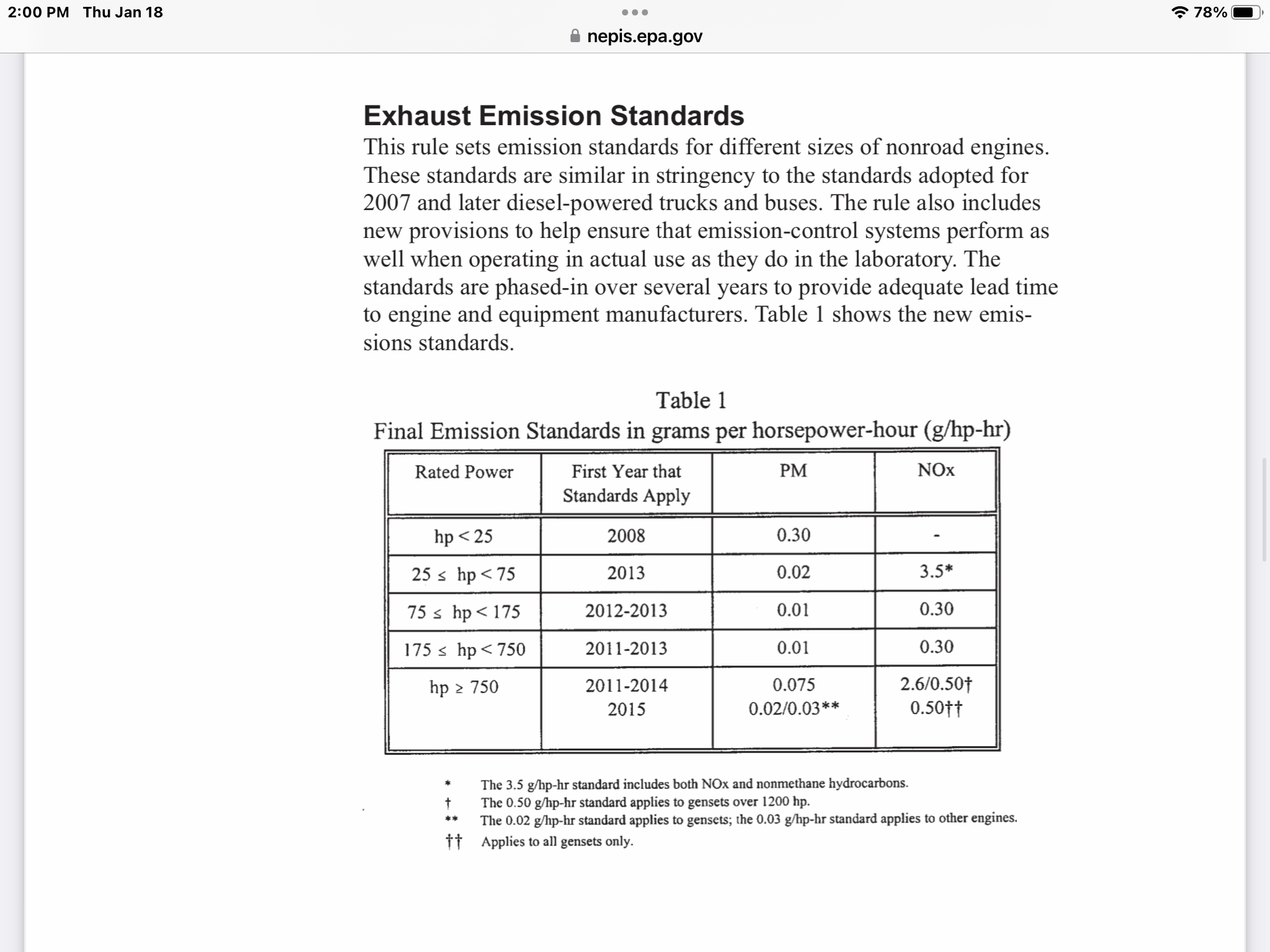

I pulled this chart from the EPA website which is the final tier 4 rules for non road diesel engines and the first year for compliance.
To say a non-road diesel engine under 25hp is exempt is probably a poor choice of words In my opinion. Under 25 hp still must meet an emission standard under tier 4 rules but has a much lower standard as to not require a DPF etc. The tier 4 rule for under 25hp was first implemented in 2008 so I am assuming this is why the seller in question stated his B2320 is “pre emissions”.
25 Hp to 75 Hp has a 2013 first year which jives with my memory of seeing Kubota tractors with particulate filters and associate electronic sensors and controls.
