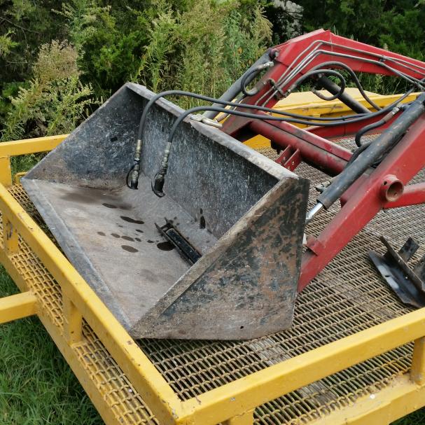

OK guys. Got a chance to pick up a loader that will fit my tractor with minor fabrication. :D
I'm looking for pictures from some of the folks that either have an L1500, L1501, L175 or L185 with auxiliary hydraulic pump mounted to the front of your tractor. My L1501 does have the splined shaft on the front of the engine.
I'm also looking for those folks running a loader off the standard tractor hydraulics to chime in as well. Trying to gauge my options and get a game plan together :D

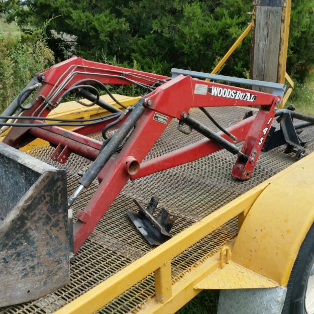

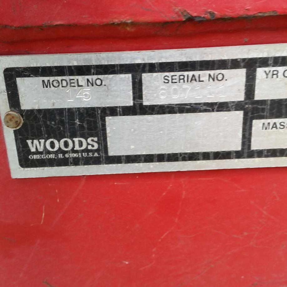

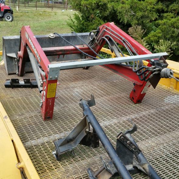

Honestly, I'm not sure what model it is. I know it's a woods off a Massey Ferguson. Maybe the owner of it can chime in since he's on this site. :p Picking it up in a few weeks since I'm gonna be in that area any way.
Trying to get the particulars and research done while I'm waiting :)
Biggest issue is locating a pump with enough gpm that will fit in the spot. :rolleyes: Hook up won't be too bad from what I looked at tonight. Will have to get a spline count and diameter of the front shaft on the tractor. Then get with the mad doctor at the local bearing supply to see what he can come up with for a love joy or spider coupler. Of course, I'm gonna have to fab up a mount for the hydraulic pump.
Considered a belt drive, but doesn't have enough room on the side where the pump could mount :rolleyes:

Pictures..... it was originally on a Massey 1010 two wheel drive, then he put it on a Massey 1020, 4x4. Then he bought a Kubota with a loader and hoe and sold the 1010.
Du-Al was built in Sioux Falls, SD. Not sure when Woods purchased them.
Thanks Len :) I had to factory default my phone last night. Tap talk app for the galaxy s5 is full of pop up adds :mad: Lost all the recent pics on my phone and all my contacts :rolleyes:

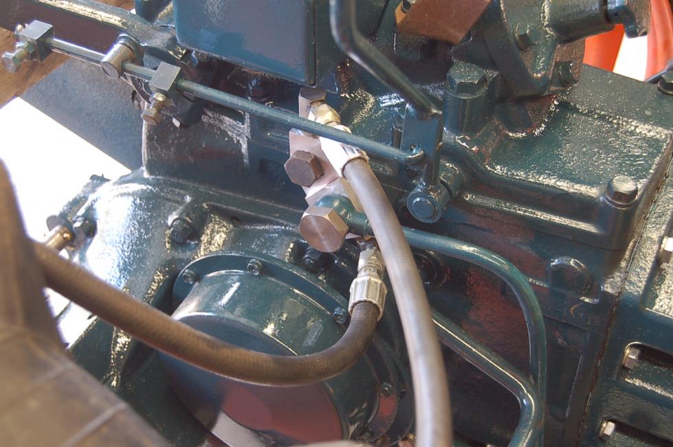

Darren, that is how mine is hooked up with an adapter block....

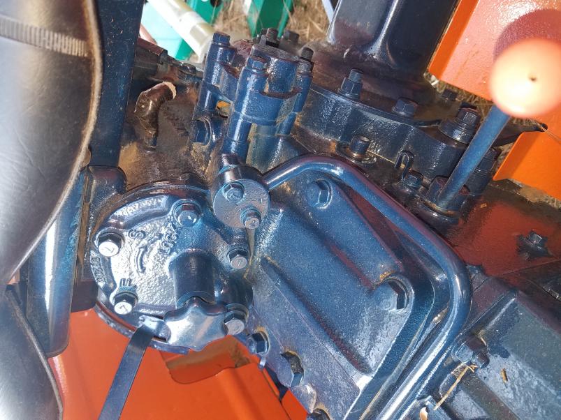

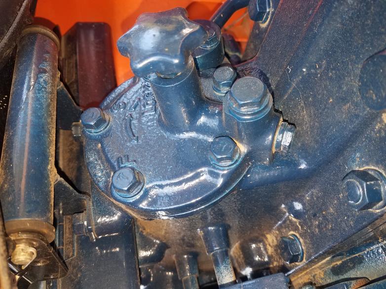

Unfortunately it looks like that block that Bill posted a picture of, doesn't look like it will fit my tractor. First picture shows how my pressure line from the hydraulic pump hooks up.
In this second picture, does anyone know what these two ports are for next to the knob? Wondering if these are for a hydraulic hook up :confused:

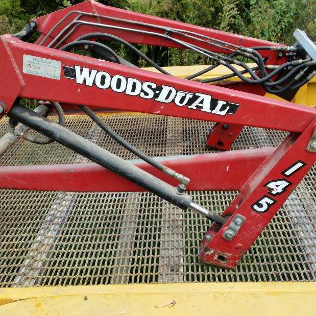

After talking with Wolfman, I decided that I'm gonna go with auxiliary hydraulics run off the front of the engine. :)
Got the loader home yesterday, and out of the truck and into the garage today. This way I can get the tractor inside as well and start taking measurements for the sub frame.
And also pull the fan shroud so I can figure out the hydraulic pump.

Get my hydraulic fittings finally :D And they fit :cool:
Ordered two 12mm compression fittings with 1/2"NPT threads. Cut the pressure line added the fittings. Tomorrow I'll hook the subframe back up and install the loader :D
