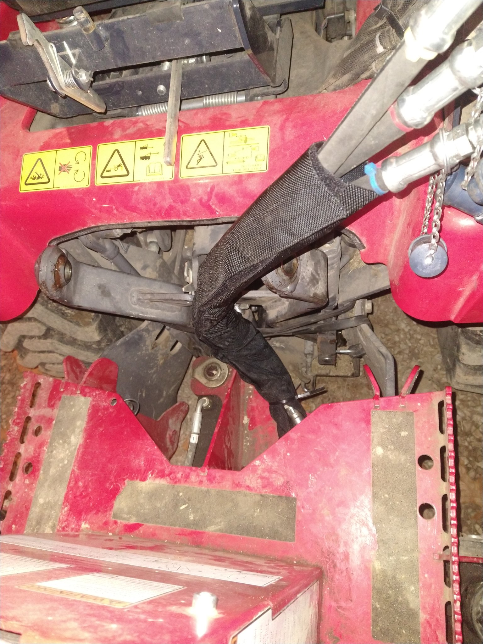

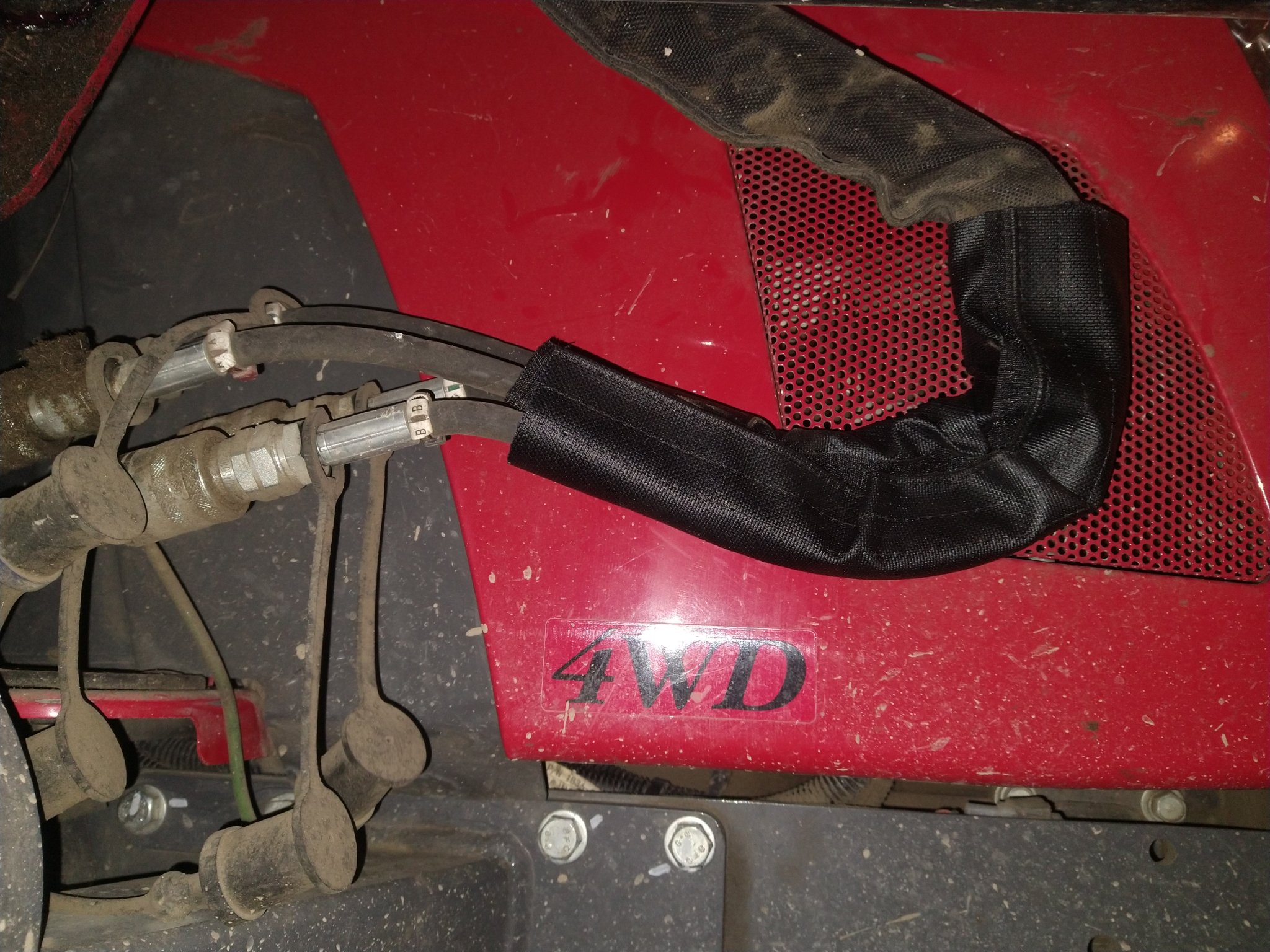

nbryan - what a great idea - retractible cuffs for bad weather and dirt!!
That woven sleeve is f...ing expensive. $5-10/ft depending on size, how the hell can they charge that? Is it some weird material or something? I just about fell over when the stealership told me the bill for a 3ft piece, whoah.
Any ideas out there for a cheaper but equally effective sleeve material?

Yes, it comes flat with Velcro closure ...

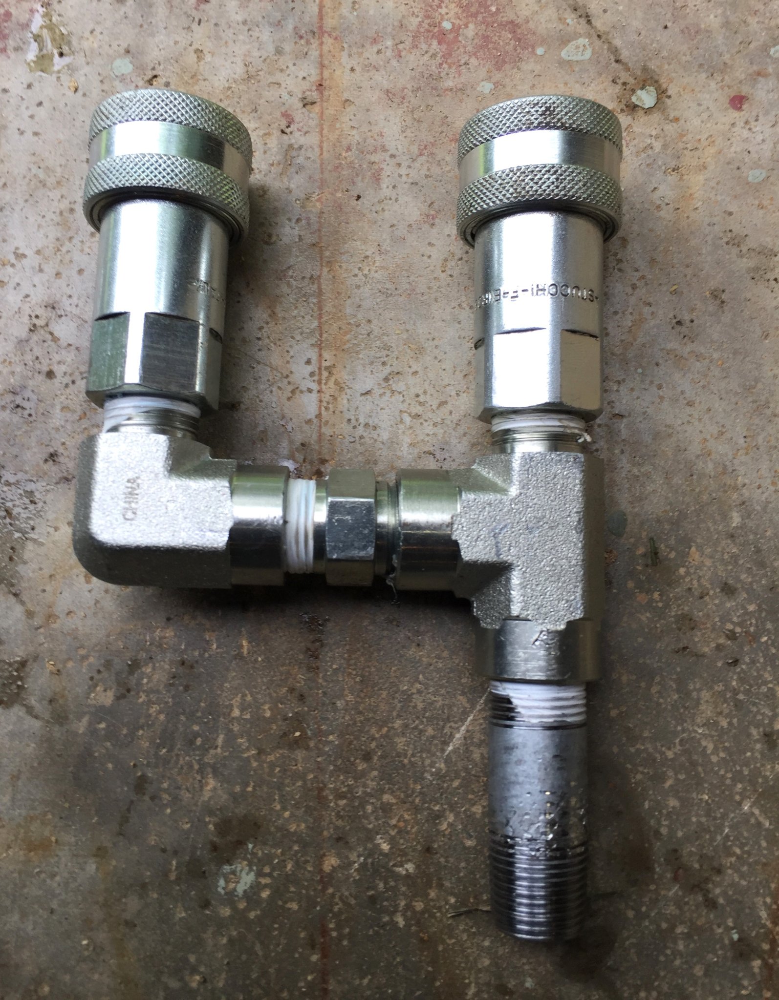

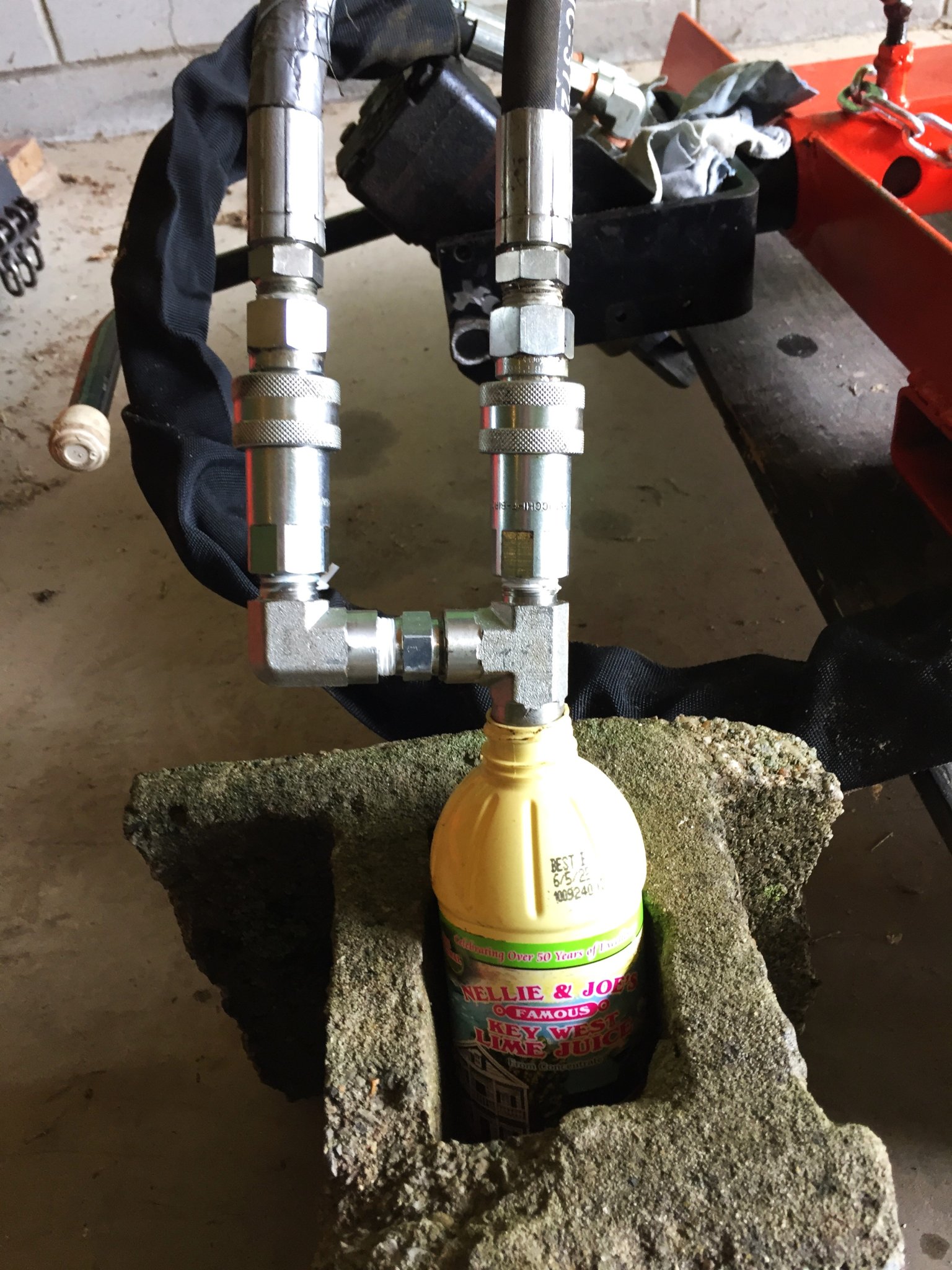

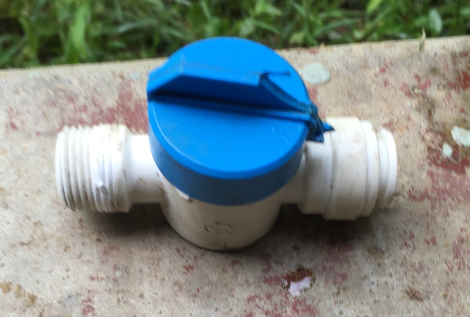

Using it the 2nd time, there was enough pressure that I broke the pvc valve handle trying to open it. Gave it a re-think and decided that the valve was unnecessary - whole purpose of this is to eliminate pressure buildup. Also moved the pieces around so it's easier to connect to sleeved hoses. Replaced the valve with a piece of pipe nipple. Whatever collects in the bottle gets brushed onto the top of wood fence posts.
