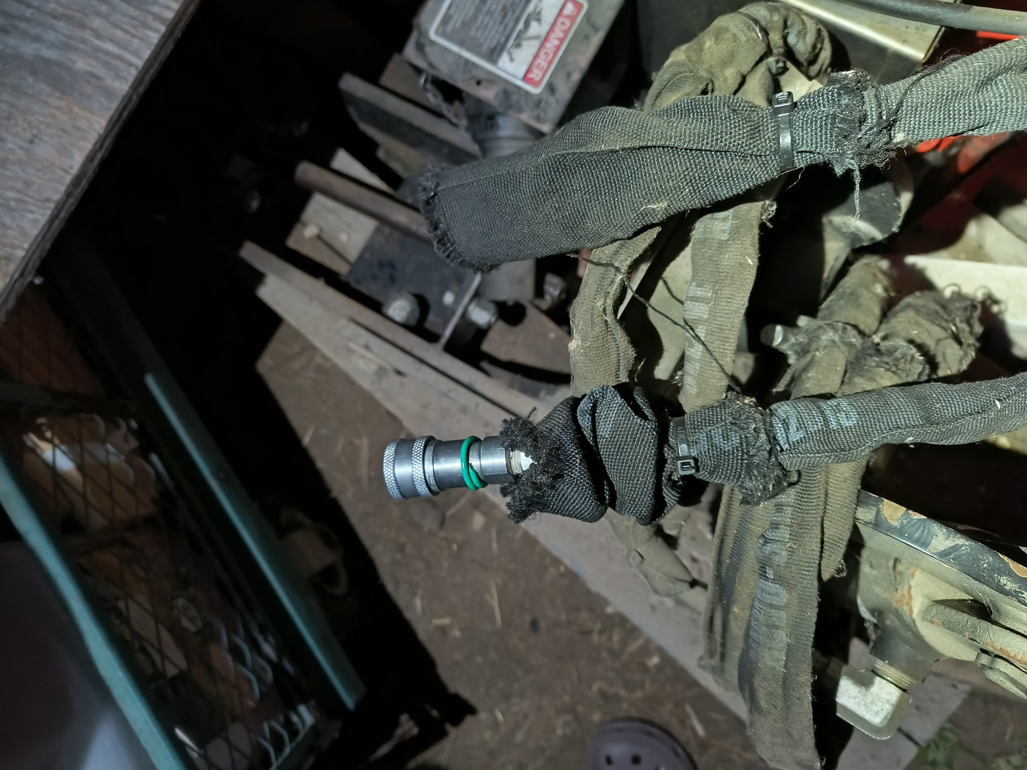

While you're sleeving if you have any 8" or longer lengths of 1 1/2" hose sleeve and a couple zipties, I recommend you consider making connector-protectors like these I made a couple of years ago.
First thought up and made for keeping clouds of snow around my snow blower hydraulics from melting on contact with the warmed up fittings, only to freeze solid within minutes of stopping and create hell when trying to remove.
These connector-protectors do that very well. I've since discovered they also work wonders keeping dirt off the connectors when detached, as they always picked up dust/dirt when they hit the ground otherwise.
