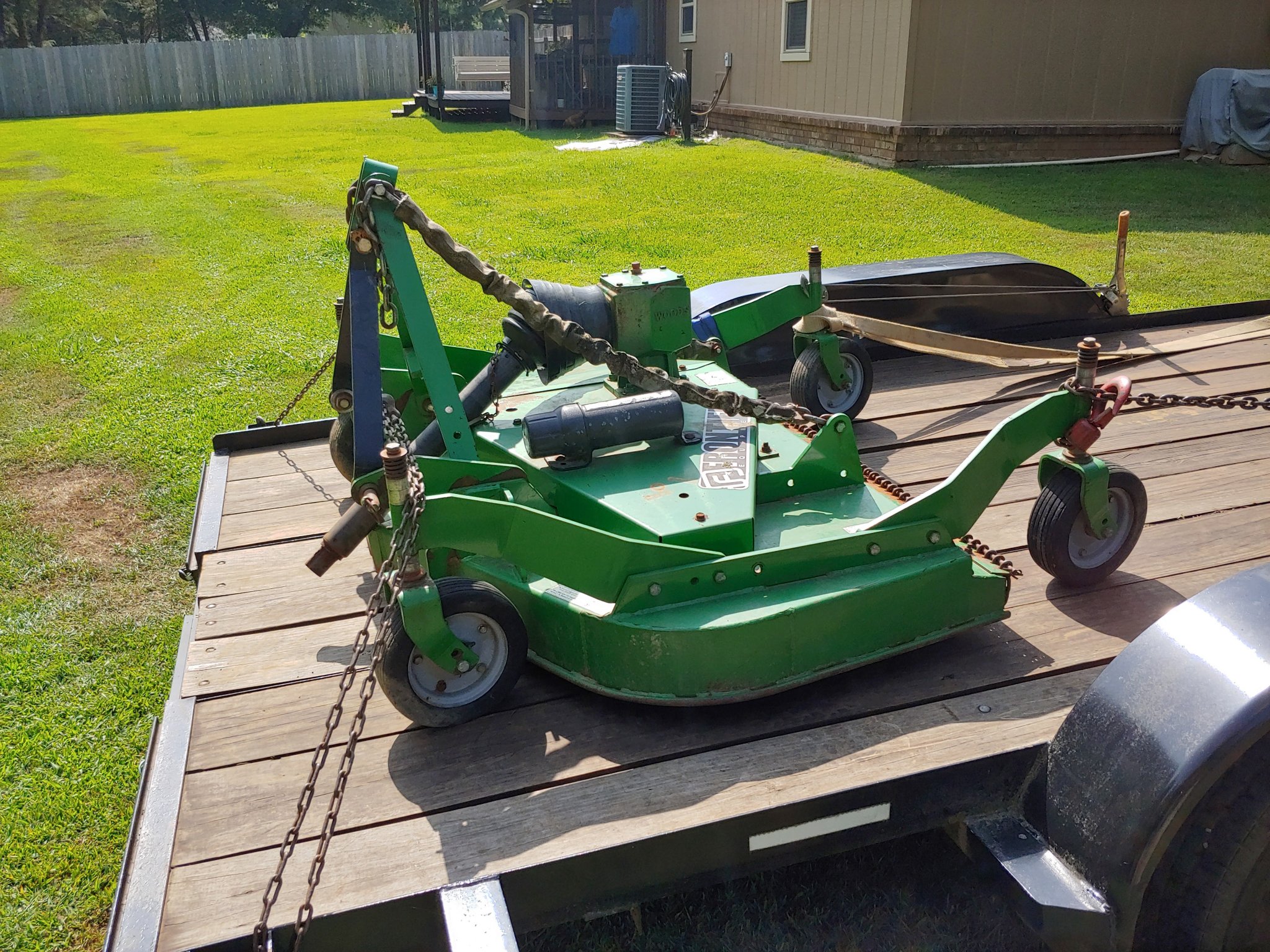

Well I have been shopping the local ads and calling around and I found a mower yesterday and bought it
today. It was the best one I found for the price and don't appear to be very old with no rust through and
most of the original paint. It is a Frontier by Woods GM1060R I seen another L185 on this forum was running the same mower. I also bought it because my grass is not very tall and eventually I might go to
a bigger tractor and I didn't want to have to find another mower. I figured this one would work for
most all tractors and places I needed to mow. Now I'm just having problems finding 1 bottom breaking
plows local. They are all 2,3 and larger. Found one so far about 90 miles away and at a dealer so top dollar
and I think I can find one cheaper but some dealers have deals like the mower I bought today was cheaper and nicer than anything online I found for sale.

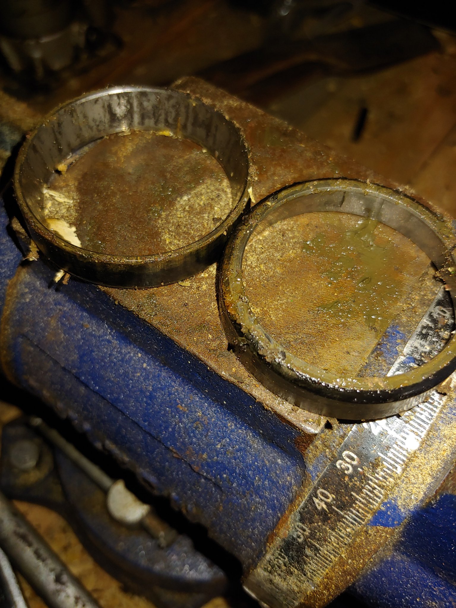

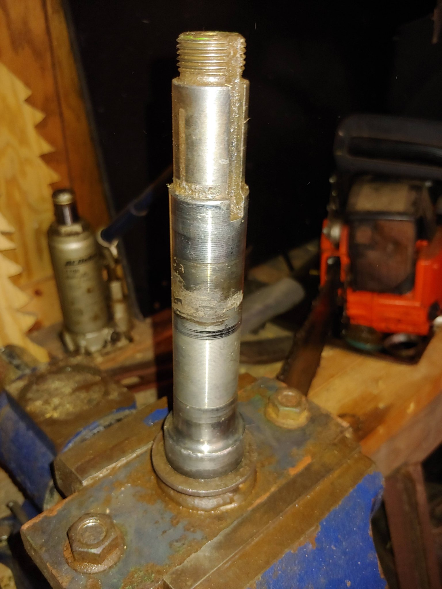

Got the other two spindles bearings pressed out and one set of
bearing races installed and have to put the rest of them in and
then press everything back together. Here are some pictures so
far.

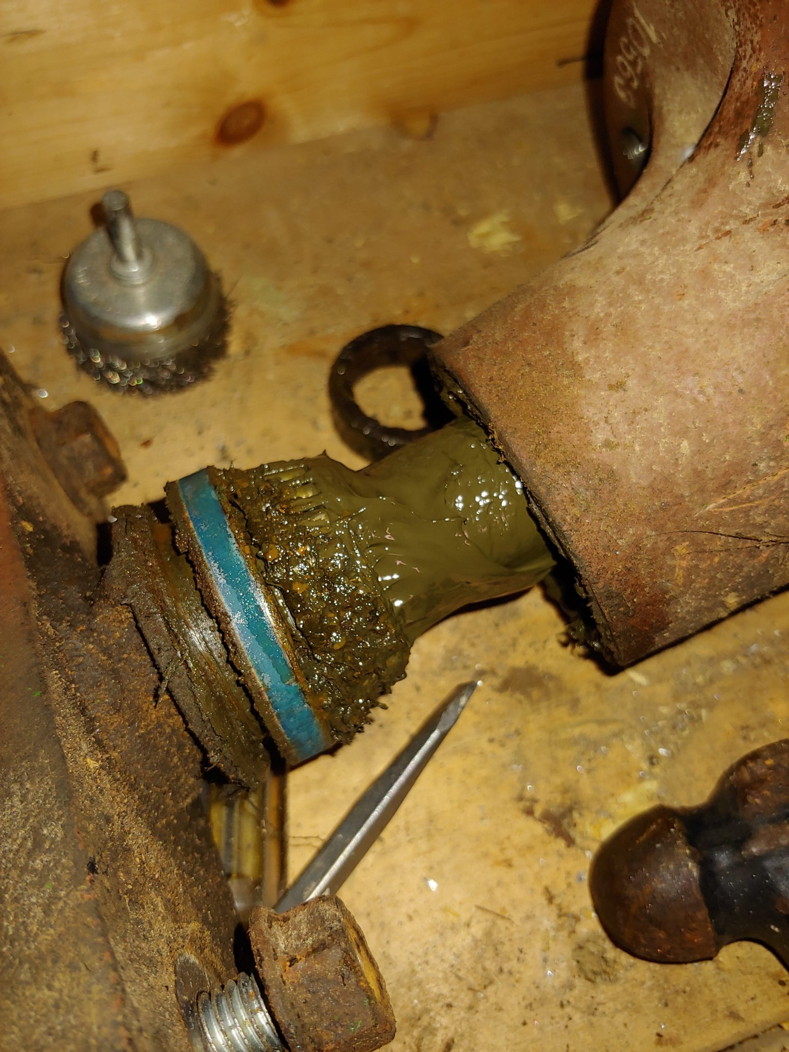

This one was bad too not quite as much plastic in the bearing but still some
and the grease was all still full of dirt and looked like mud. What a mess
that definitely motivates me to take care of my equipment better than the
previous owner of this thing did.

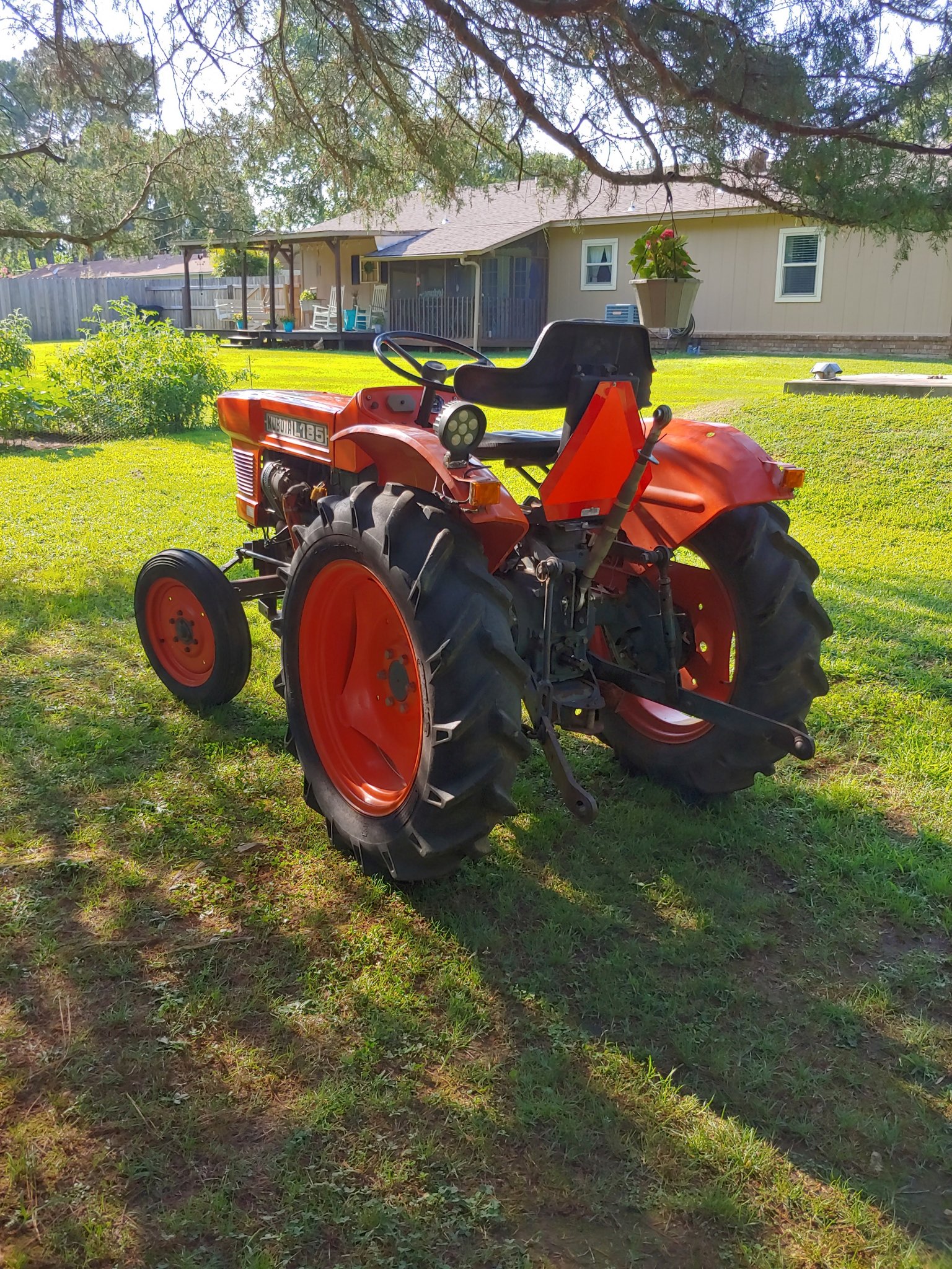

Here is another picture of the Ol' tractor ready to work.
Dave
