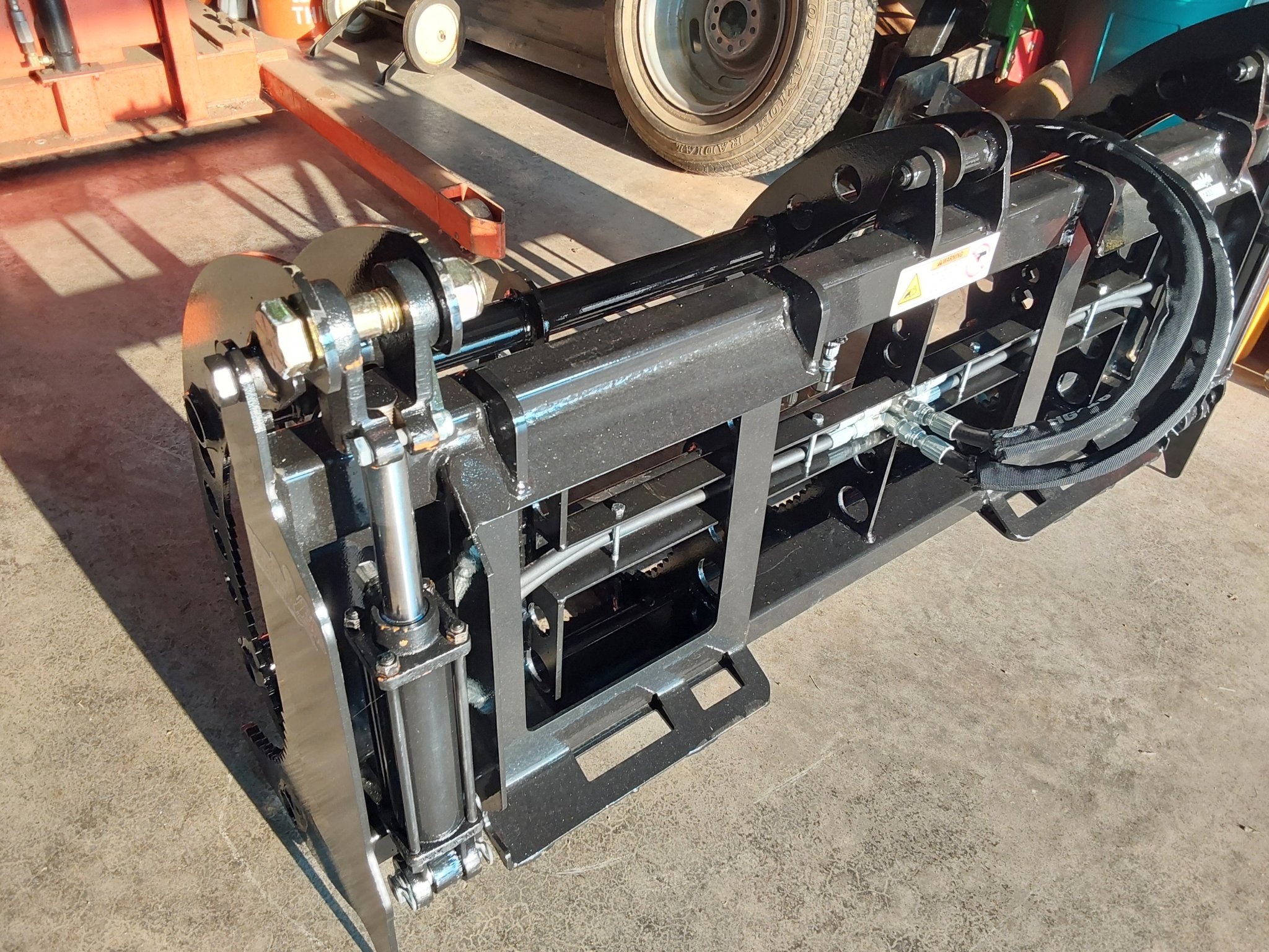

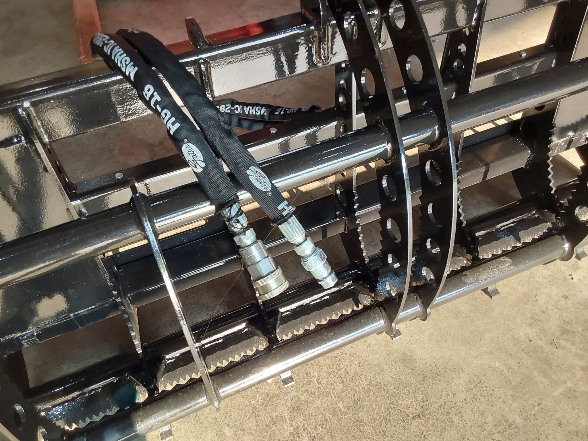

Here's some quick pics. It seems very well built. This definitely has a lot of welding in it. Full welds both sides of all stress areas. It must take a half day just to weld it up.
Very nice job hiding the hoses and high quality gates hose
Stands up nice and cylinders are hidden well

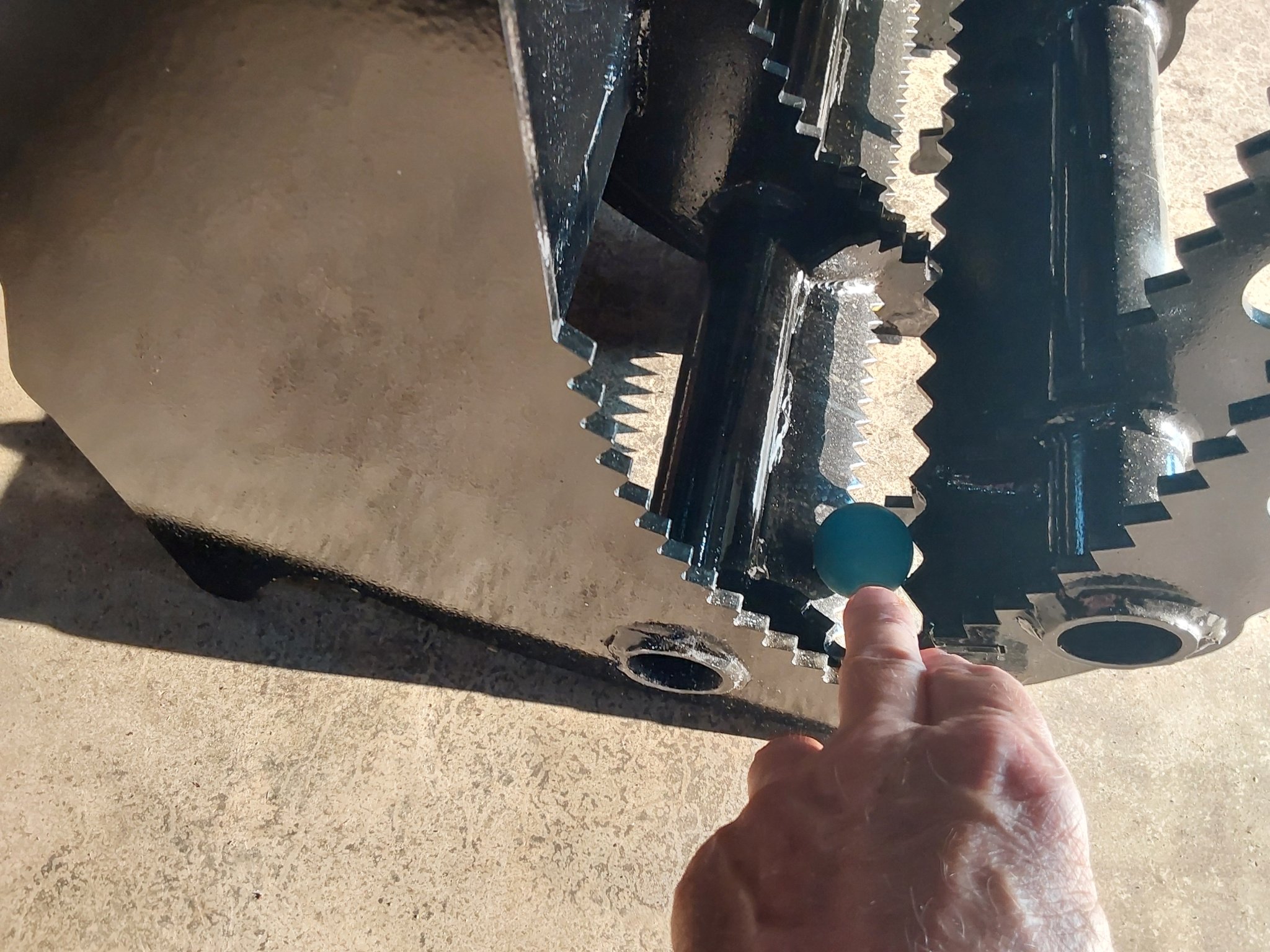

The main reason I bought it is how small a root ot vine can be clamped with those teeth bars.that blue ball is 1 1/4 diameter won't slip through anywhere across the bottom

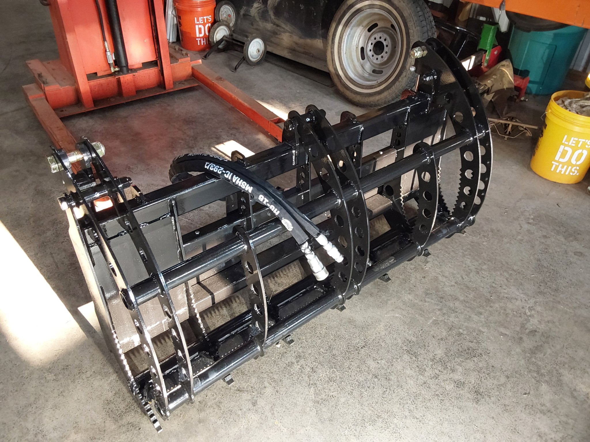

I got the ag style couplings. The tripled fully welded rake teeth are done nicely

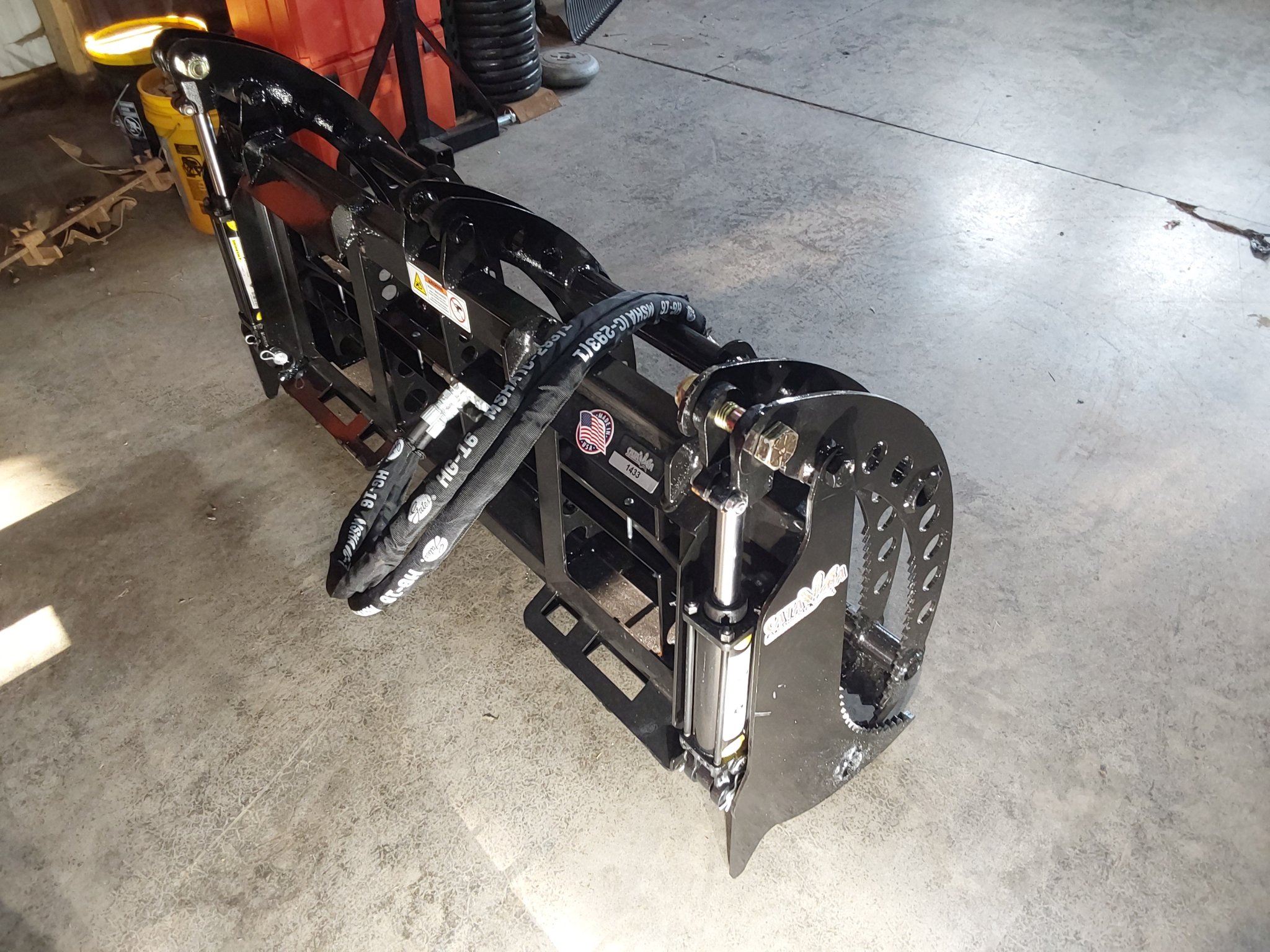

Back view of hidden hoses and quick connect plates.
Only area without grease fittings are the cylinder mounts that look to be high grade bolts. I'll shoot graphite in them. All the pivots have grease fittings. Looks great. There's some weld spatter under the paint in areas but otherwise has a decent finish for an implement. Can't wait for my tractor to arrive so I can try it. I definitely made the right choice for my needs.

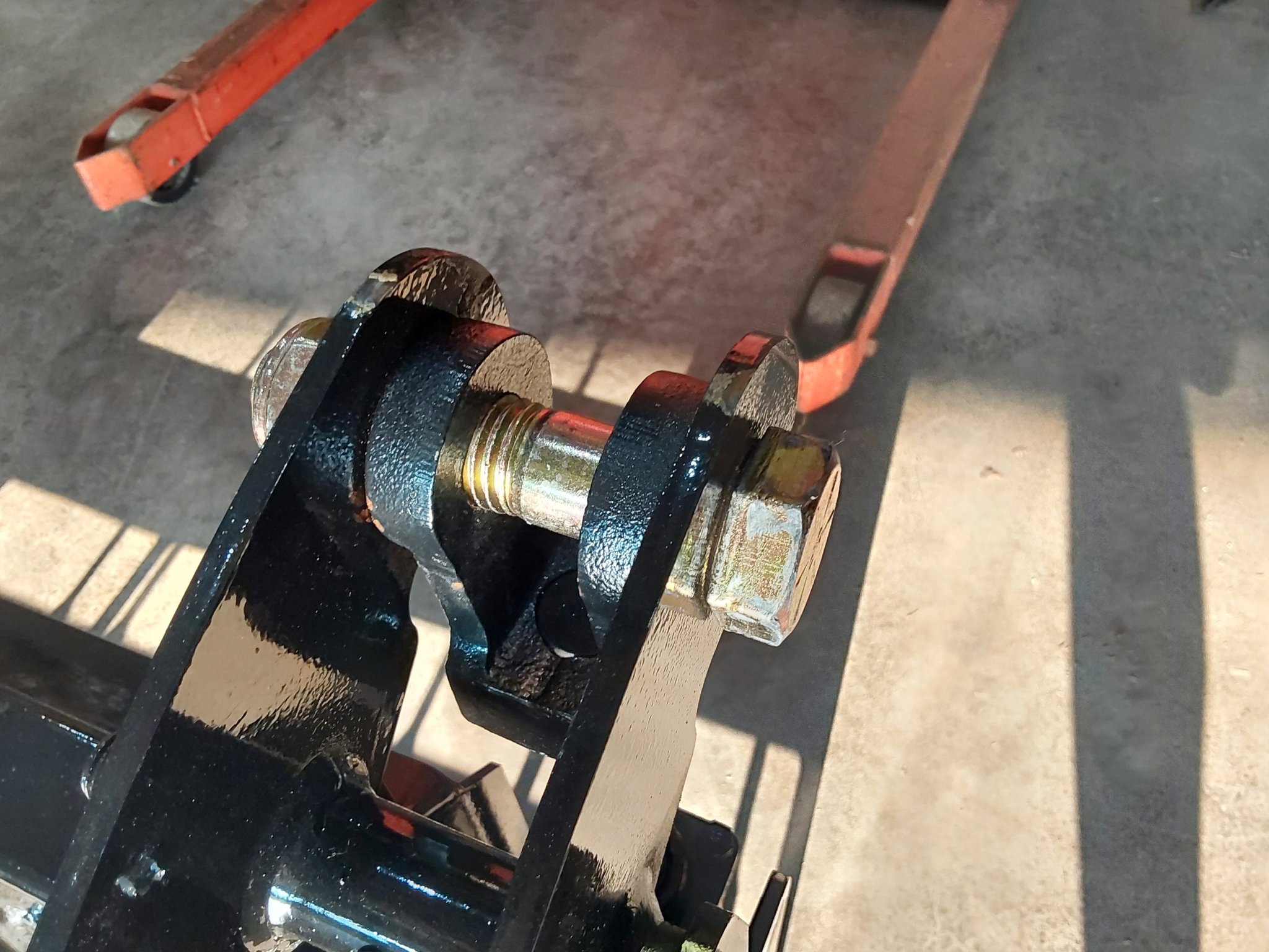

I would suggest replacing the cylinder mount pivot bolts, with others that contact the bolt surface, rather than the bolt THREAD surface.
Would use grade 2 bolts,....... perhaps grade 5, at most.
Worn bolts are easy to replace,....cast cylinder mounts are not!
I made brass bolts for my ( different brand) grapple cyl. mounts.
Sidekick
Jul 29, 2023
1,083
1,513
N.Y,
I was thinking the same thing. I have some 1 inch longer bolts that could be cut down and eliminate threads in the cylinder mount area. I could cross drill softer bolts for a grease feed easily then.

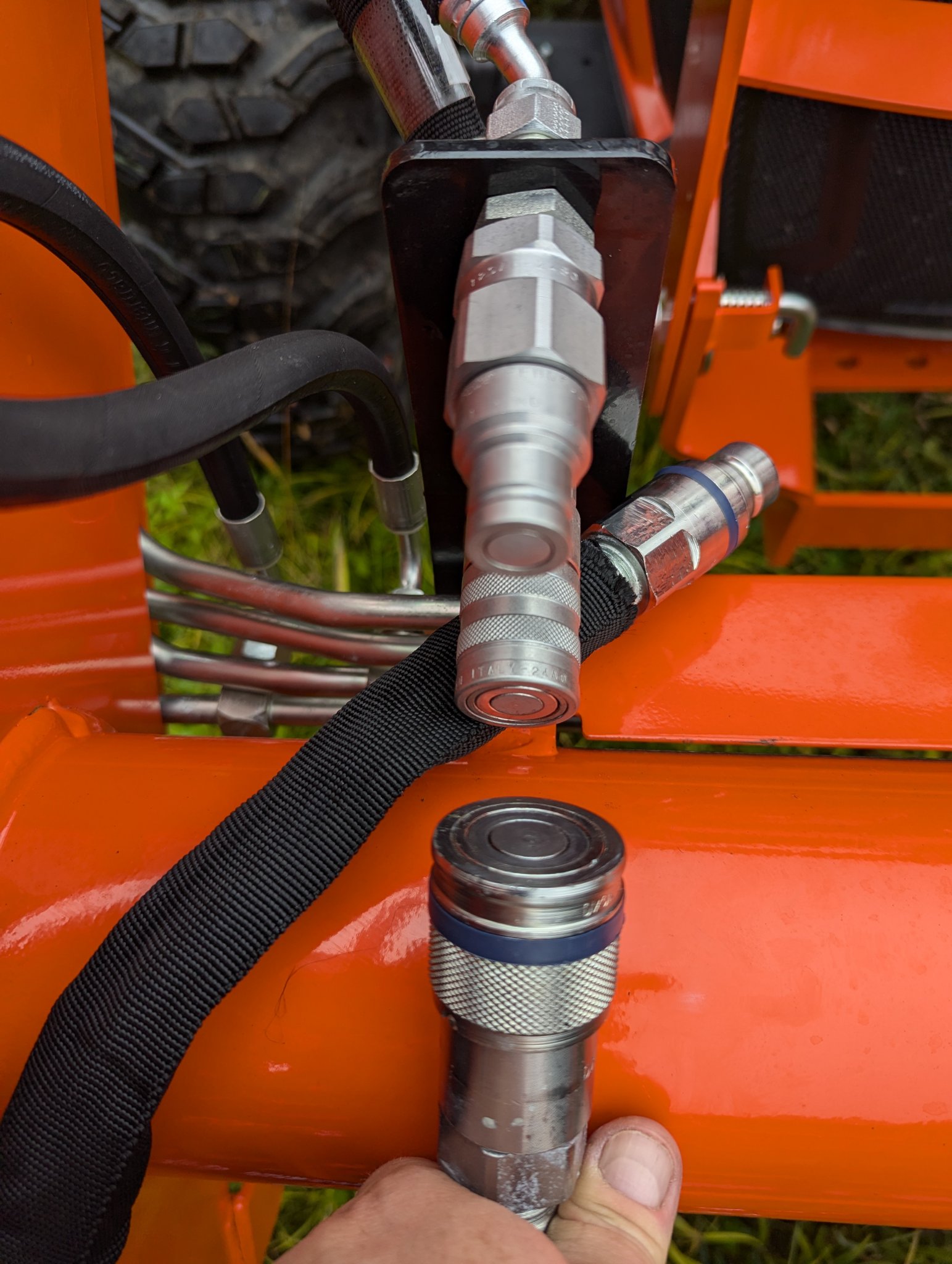

Just received mine, everything looks great, except I probably should have told the dealer to install a half inch rather than 3/8 flat face!!!
Sidekick
Jul 29, 2023
1,083
1,513
N.Y,
Just received mine, everything looks great, except I probably should have told the dealer to install a half inch rather than 3/8 flat face!!! View attachment 136412
That stinks. What connectors are used on the rear remotes? I think front and rear should match. Catawba didn't have a 3/8 option?
