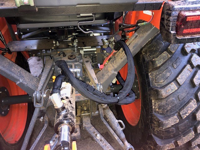

Are the rear remotes valve ROPs mounted or have they cleaned it up and mounted it below the fender like the cabbed model? The "factory" remotes I saw on a B2650 look home brewed.

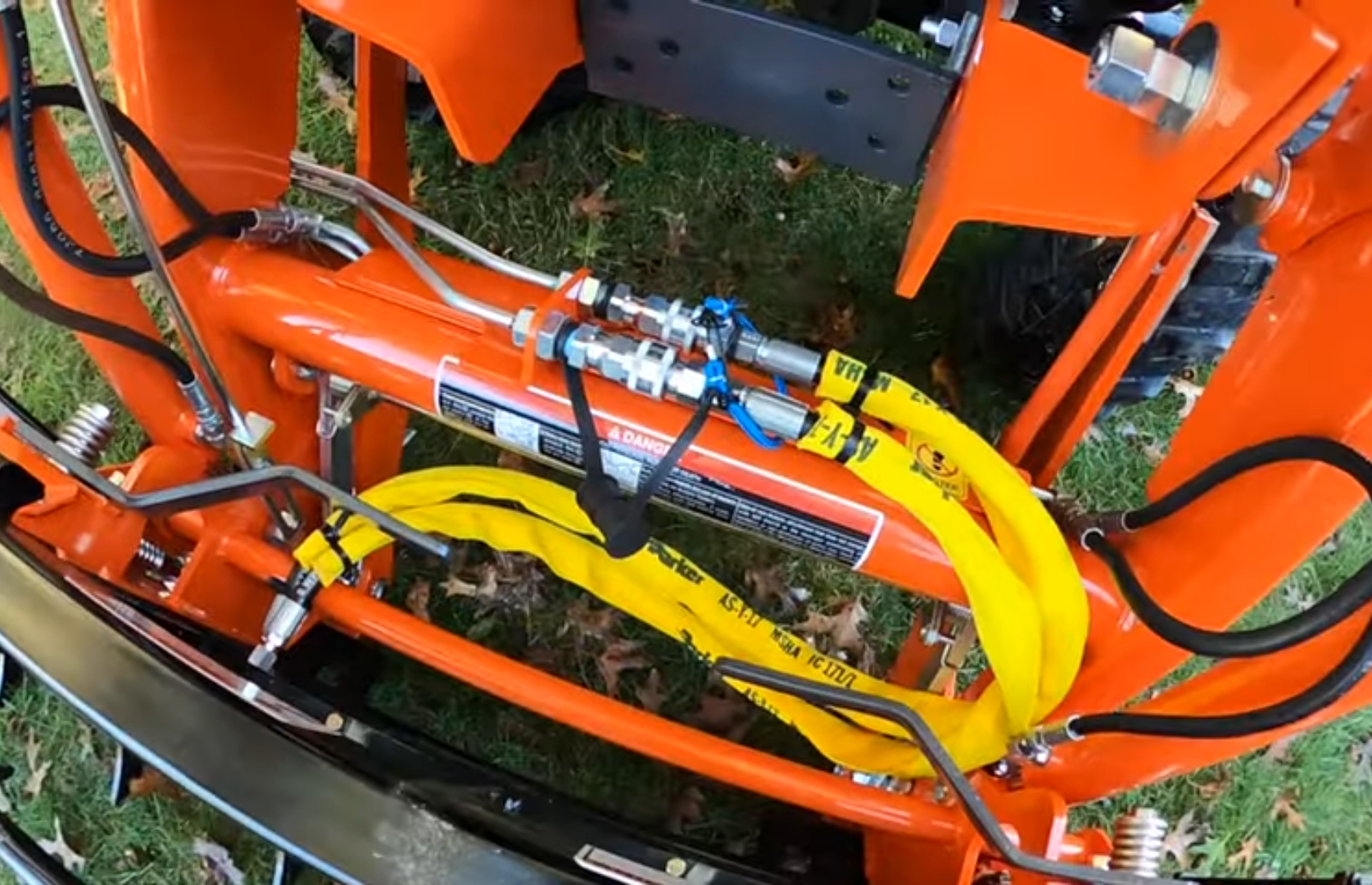

My dealer said they install Landpride 3rd function valves, but I know from talking with another dealer, the loader can be ordered with the 3rd function pre installed. I assume based on the welded coupler mount and hard lines, the video linked below is the real factory 3rd function (start at 0:44). Should I fight my dealer on it? When I mentioned it to him he said "that's not how we do it"

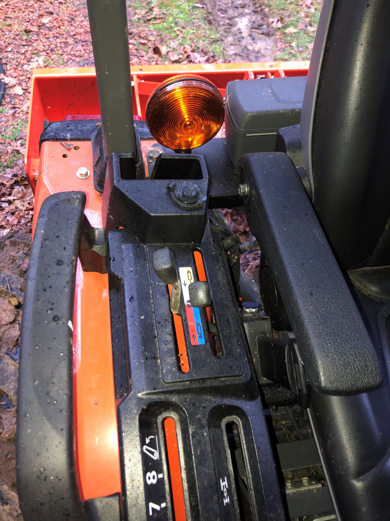

Here are my two remotes on my 2610. and the levers to control them.

Thanks! From my understanding that is a big improvement from the 2650.
Yes! I made sure to ask my sales guy, EXACTLY where the remotes were. Kinda the same reason I didn't get the Kubota 3rd function.... that weird hose loop killed it, would have liked the hard lines down the loader though.

It does look stupid how they bent the hard lines out to transition into that loop. Did you install your own, and did you like how yours turned out better?
Did your loader have the bracket welded in place to install the couplers? I'm trying to determine if it's standard or if you have the order the loader with the 3rd function kit to get it welded.

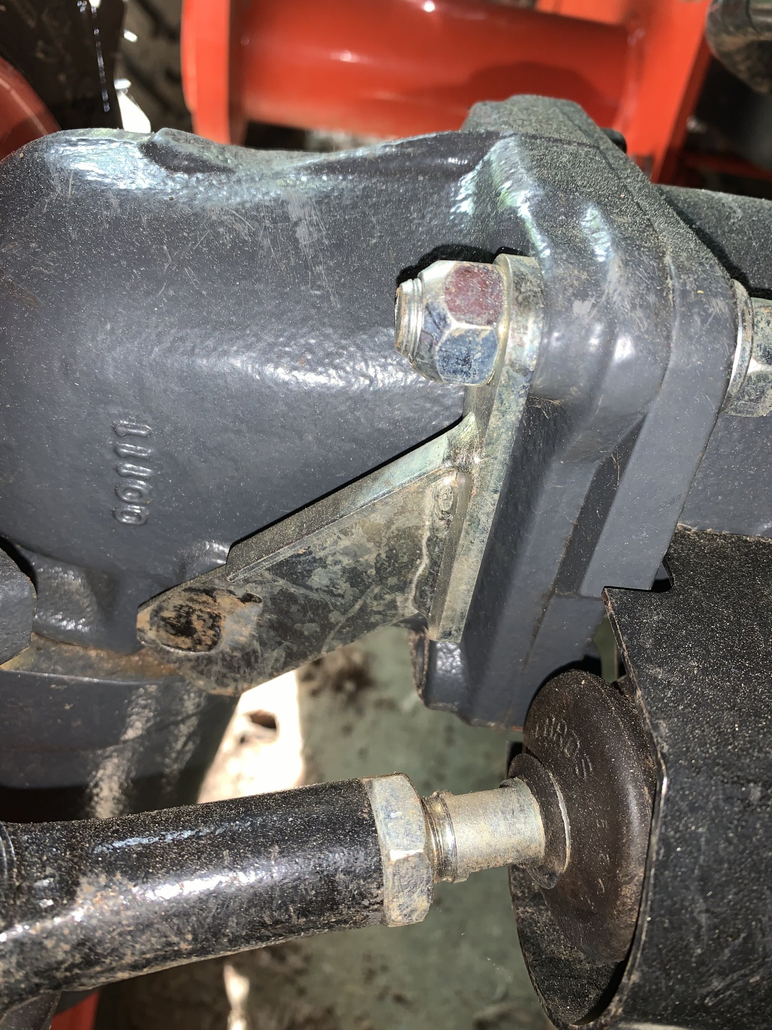

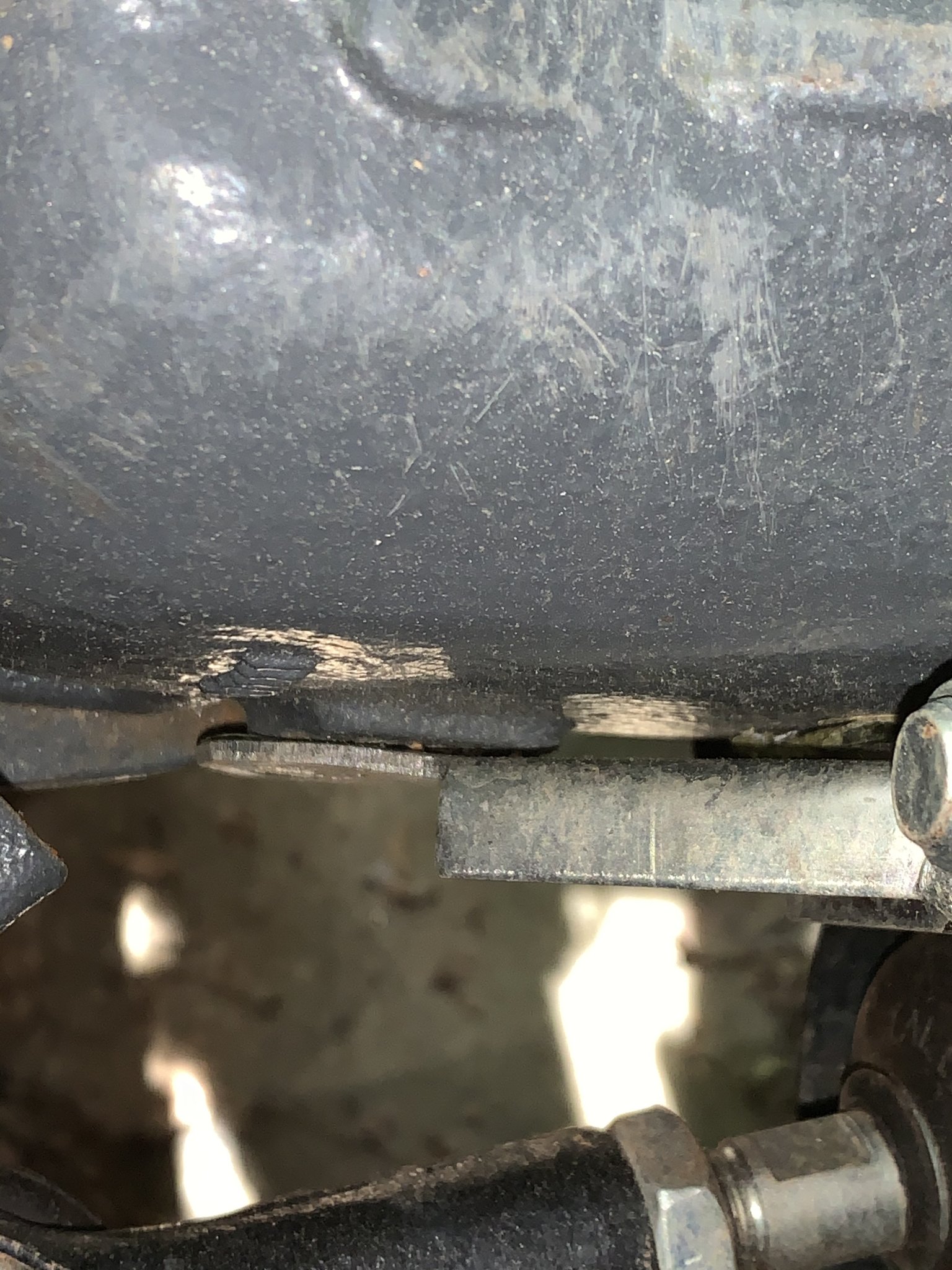

My last tractor had large wheels and should have had stops. The tires would hit. I'm curious how much travel it prevents.
My LX3310 came with the stops installed so I can't compare before and after, but I was shocked at how far they would turn - they almost point a full 90 degrees to the side at full steer. The maneuverability of this thing has been a really positive surprise for me.

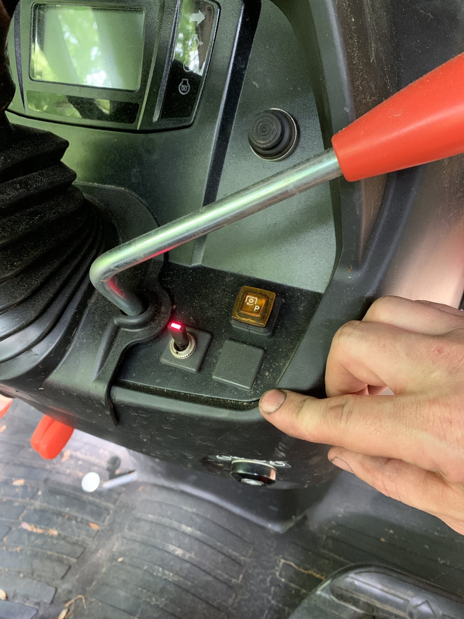

Thanks. Seeing pros and cons to each of the different kits. Maybe I'll just install it myself. I'm pretty particular. Why are people putting power switches? Is there not places to tap hot from that is only energized when the tractor is running? Or is the switch to keep the solenoid open for something like a hydraulic brush mower?
Bird dog touched on it, I will too. If I'm not using the grapple, I didn't want power to the solenoids if nothing was hooked up. No matter how hard I try, I always end up hitting those buttons on the loader handle. With my switch, it doesn't matter if I hit them with the switch off. My switch is lighted, so I can easily tell if they are energized or not.

Just making sure I understand. The solenoid wouldn't be energized unless a button is pressed either way. If nothing is connected to the quick connects, and a button is pressed, what happens? I assume the lines past the solenoid could pressurize and that's all?
Correct, but if that wire is connected straight to battery, it always has power/solenoids are able to energize.
My loader buttons do nothing, unless this is on.
