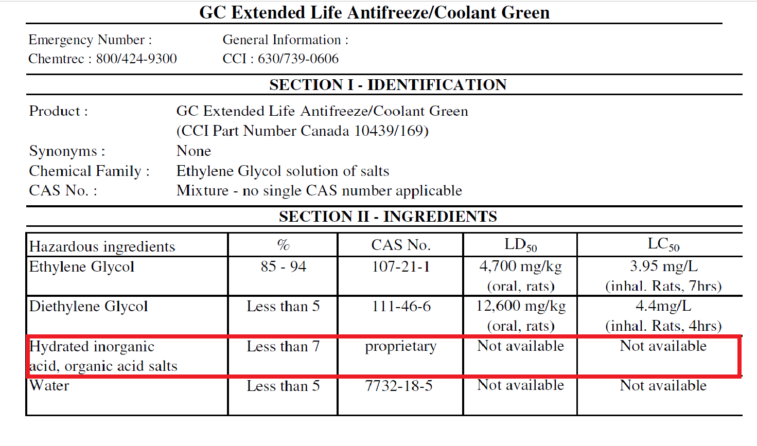

Here is the Spec sheet for what Kubota has private labeled as their "long life" anti-freeze. Use a product with the same chemical properties and you are good to go!

The actual chemistry (CAS numbers) is "proprietary" and not disclosed.
Organic chemistry was a long time ago but Hydrated inorganic acid, organic acid salts smells like an HOAT to me. Also very typical of Asian OEMs.
Most importantly its "green" so the curmudgeons should be happy.
