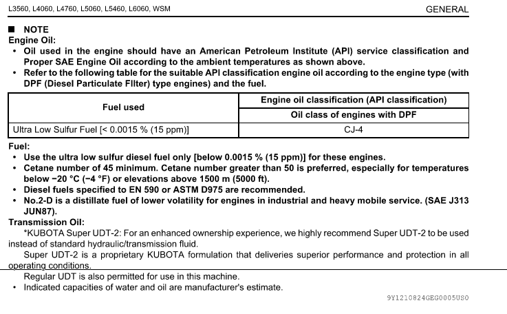

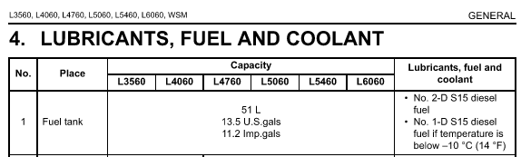

So I'm responding to a previous comment I made regarding fuel. I stated it was in the Operator's Manual but it's actually stated in the Workshop Manual. I know I read it somewhere. Bottom pic clearly states ULSD ONLY. This only applies to tractors that have emissions.
ULSD is ULSD. Doesn’t matter if it’s taxed(yellow, on road) or not taxed(red, off road). As maple farmer said, this only applies in North America.

That's stupid. Except for the dye, they are identical.
Until 2007 off-road diesel was still high sulfur. Probably the text stating use on road diesel is left over in some manuals. All diesel with a few exceptions went to ULSD in 2014.

In MD a minimum of 40 cetane and a maximum sulfur content of 15 PPM is specified on the pump just like octane for gasoline and the fuel is clearly labeled ULSD. The ASTM testing procedure is the standard for diesel fuel sold in the USA. I would have to look at a pump to see if it is actually mentioned. I know the gasoline pumps specify the test used for octane.
This has gotten downright silly - if you are buying OTR diesel anywhere in the USA it meets those specifications.
