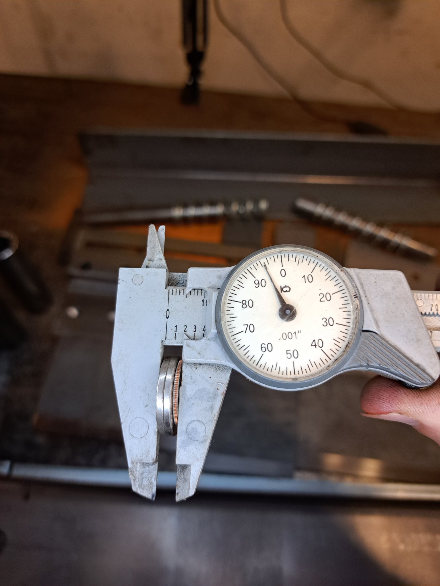

I decided that I did not want to fiddle around with accidently going too far with the alignment pins, so I came up an idea.
I decide to use some combination of nickles, dimes and/or pennies to make a "go/no go" gauge.
So after digging around in the "piggy bank" I came up with a combination that basically gave me the perfect combination of change that would prevent me from "over shooting" my mark.
Then cleaned the "mill scale" off a little, put them in place and hammered away.
As you can see a little a little adjustment is necessary to get it "square" in both directions.
A few "whacks" with my "precision ground" adjustment hammer and we have what amounts to "good nuff".

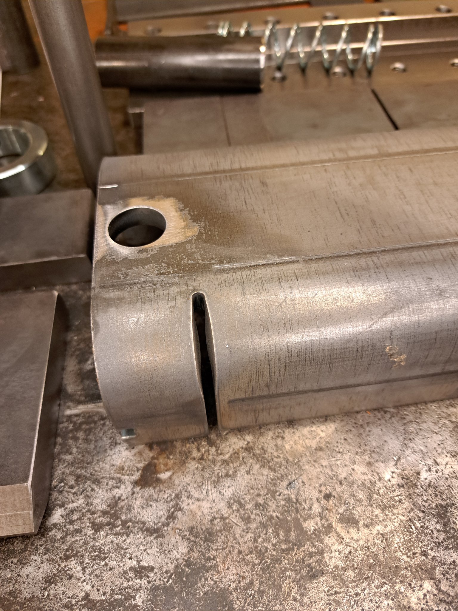

Most people I watched are using MIG, but I am a huge fan of TIG.
I am certainly no "great welder", but I do love the elegant combination of complexity, dexterity, quietness, and "non-smokiness" of TIG welding.
It's by far and away, my favorite type of welding.
So I "plugged" the hole and ground it flat (not pictured)

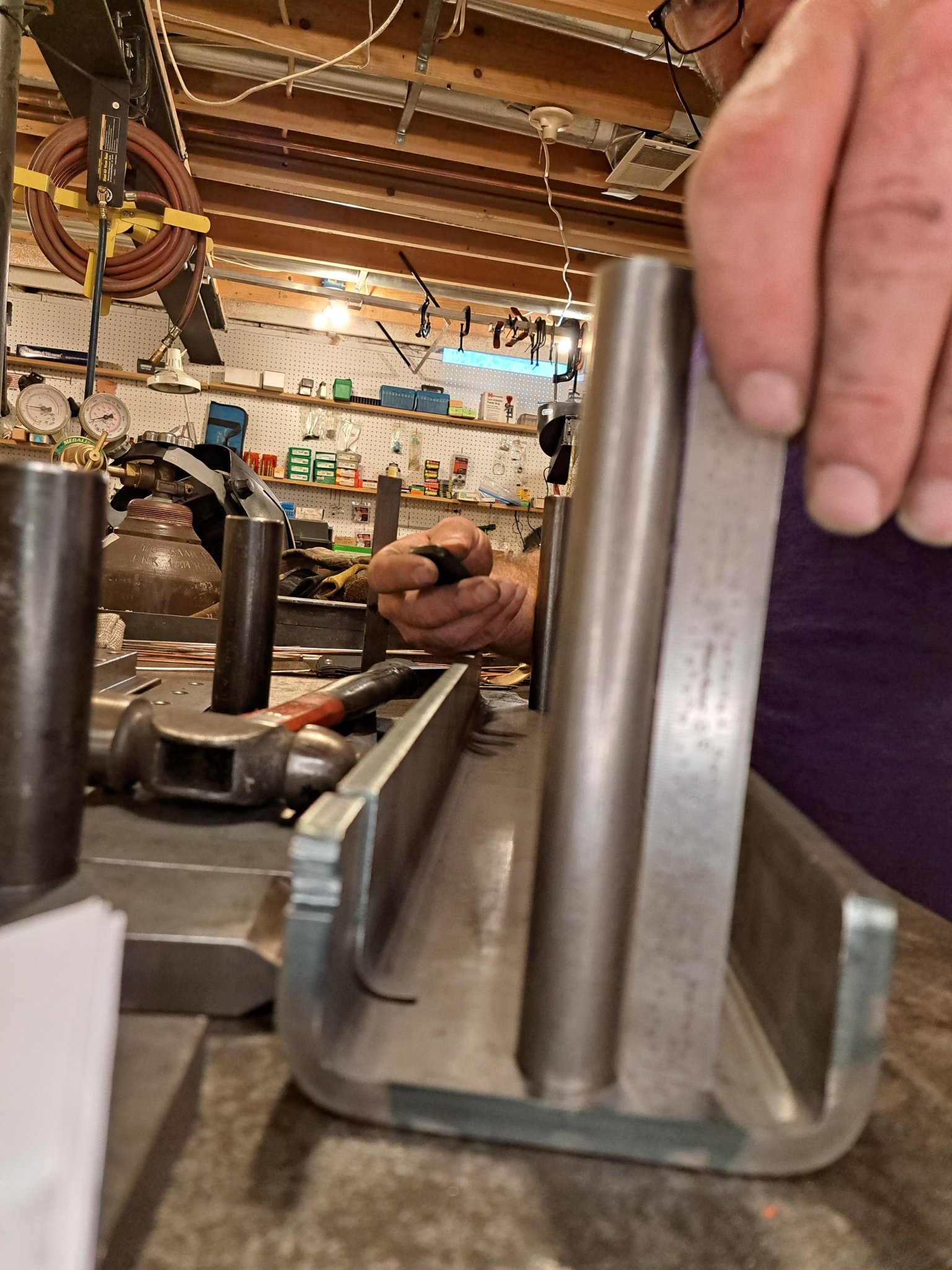

Then it was on to the lining up the "guide bushings"
Now here is where they warn you to not "accidently" weld the guide bushing to the "Finger clamping bar" because then you can't release the fingers when needed. You also have to "center" the Guide Bushing on the "Main Bar"
2,892
3,534
Lining it up only "by eye" did not give me a 'warm and fuzzy' feeling, so that usually calls for "Unnecessarily Over-Complicating" things......and I do not disappoint.
So it's off to the lathe to make what amounts to make my "UOC" alignment tool.
If anyone here has shot Aperature Globe Sights or even "iron sights", you know there is this weird phenomena, where your brain wants to "Auto-magically center" things. (I have no idea what this phenomena is actually called)
So I get this idea to make a tool that will kind of help me "make sure" (at least in my head) that I am aligning things correctly.
In the scrap pile, I find a scrap bar that almost fits into the Guide Bushing, so I take a few minutes to turn it to just barely fit, then use layout dye and "scribe" a "Centering line" on it.
In the pic you can barely see it, but that is my inability to use the camera properly. I could actually see it quite well and it "seemed" to help. Whether it actually did help or not, is open for debate.

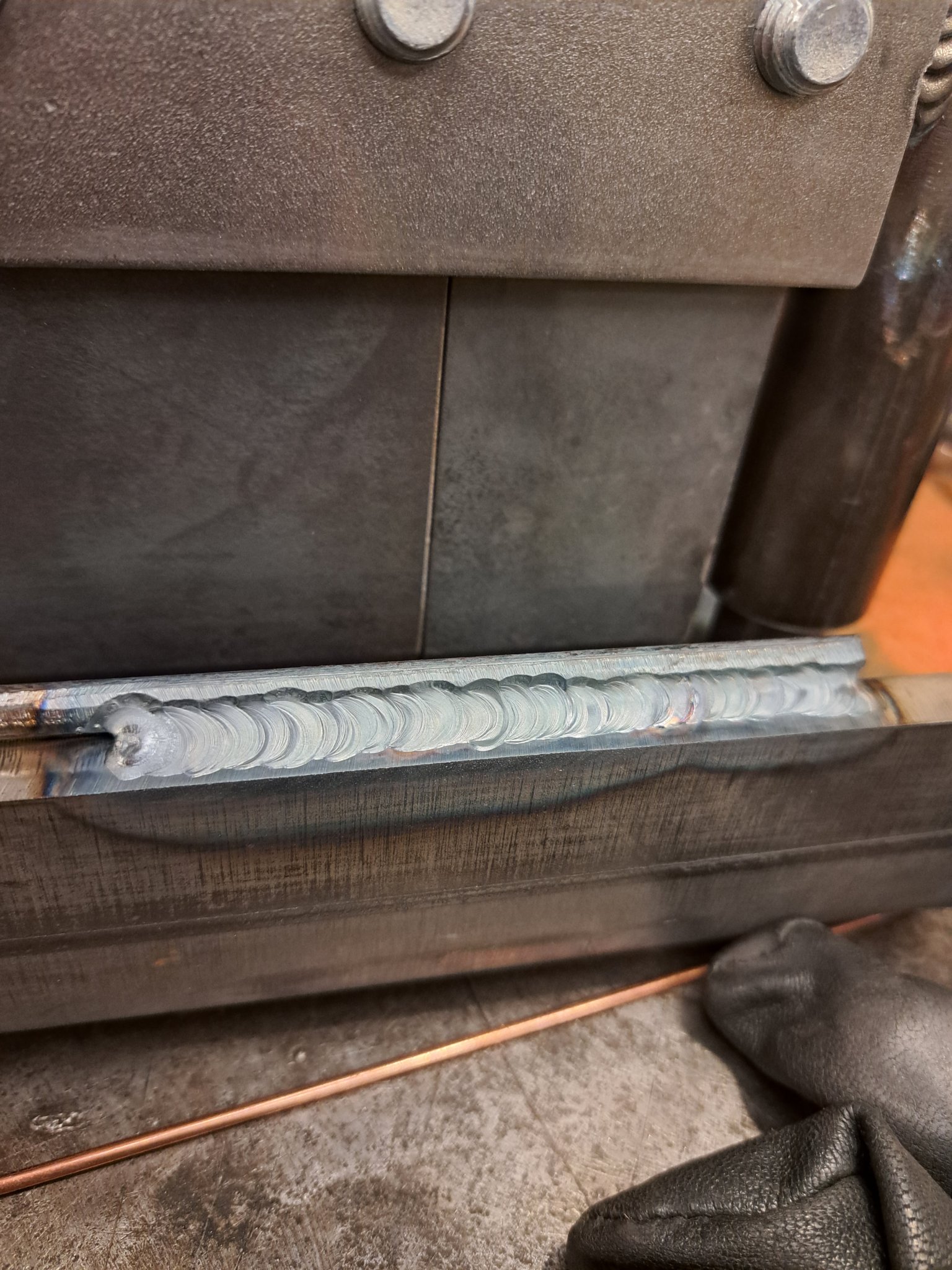

Now I "Tack her up" on both sides.
This actually turns out a little harder than was expected, due to the "gap" between the "Main Bar" and trying to avoid welding to the "Finger Adjustment bar".
Now I weld her up with multiple pass's, being mindful that the "Finger Bar" has to be able to "clamp down" properly. they do suggest in the directions that if your welds are a little "proud" you can bevel the "finger bar" ever so slightly.
I took a "butt load" of pics, so here they are in order of "First Bubble gum looking weld" to "beveling of "finger bar"
In my defense, I did get a little better as I finished up.
On to the other side and "middle"

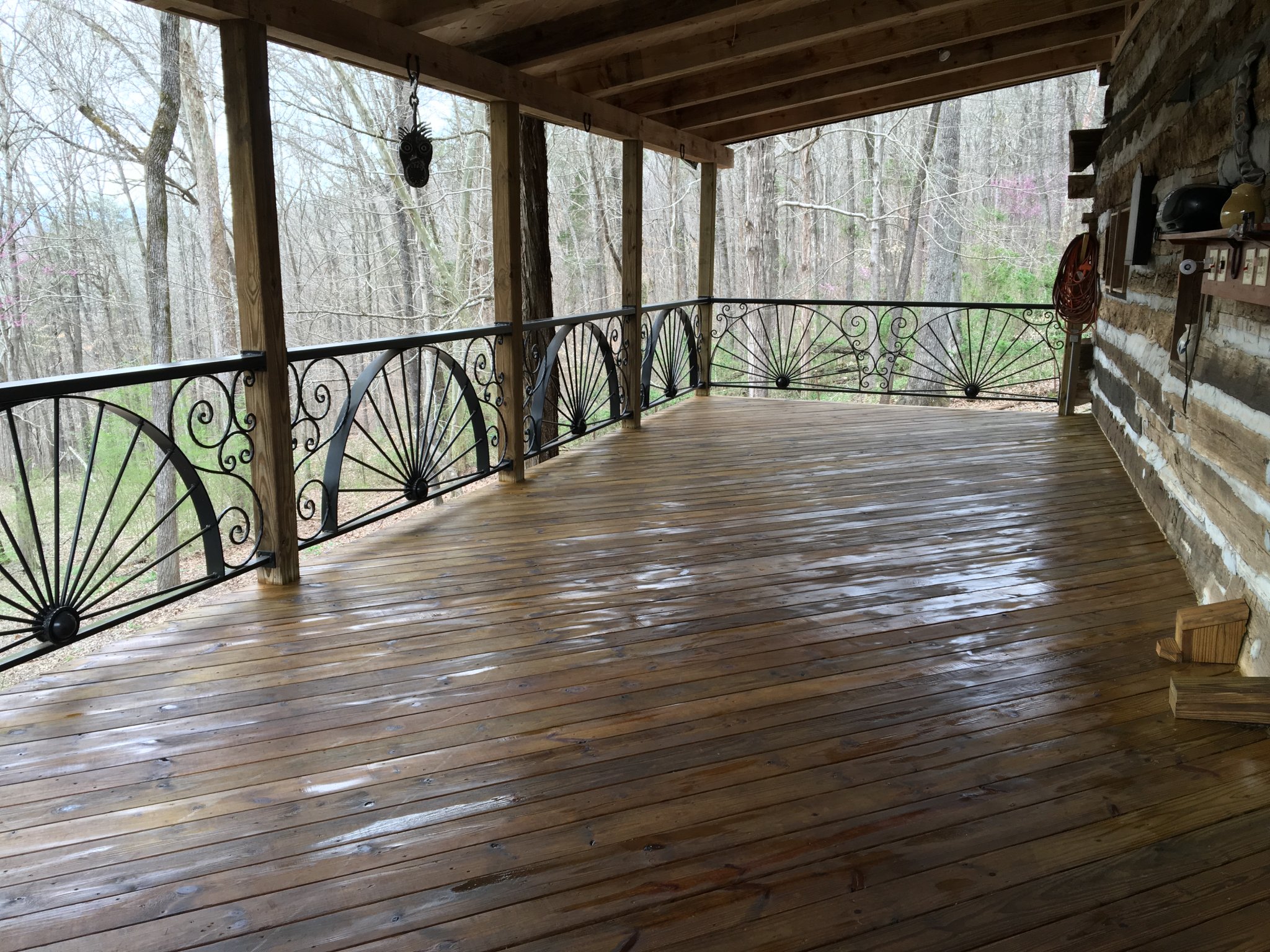

Great write up! SWAG makes good stuff.
Been looking for a wagon wheel roller for some time before finding their horrible freight mod. Didn’t want jail bar deck railing.

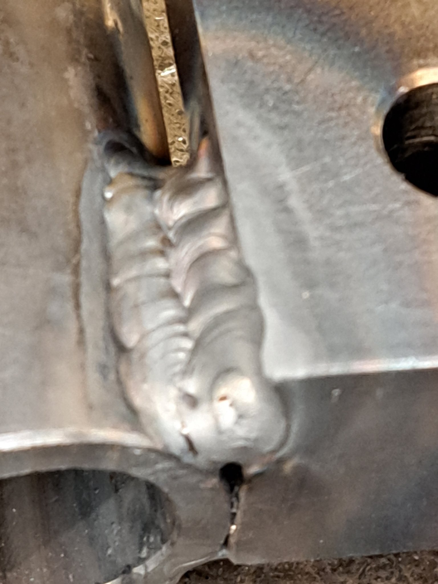

Now for the pièce de résistance ......Welding the "Big V"-
They say that you might have to grind part the bottom part of the V to make it sit properly, but with mine it sat perfectly so no need to grind anything.
Since it is such a long weld, you basically have to weld a section and then go to a different section to minimize warping.
Well, I have always had a difficult time "stopping and starting" my welds and making them look like one "continuous weld", so here is my chance to practice.
I start off buy welding small sections of opposing corners then small middle sections.
I am really NOT liking the way these are turning out. It seems to me that there is too much "under cutting" (I think its called that) at the top of the weld.
No matter what I try to adjust, the "under cut" is till there.
It's not "Hideous" but I'm just not happy with the results so far.
Then it dawns on me, to try a different size rod.
I stepped it up to a 3/16 rod, but that seemed difficult to control the weld puddle with. It seemed to cool it off to quick and would "stick to the work" so I dropped down one to a 1/8 and then that seemed to help a lot.
The RH side now looks a lot better (at least to me)
From there on out I pretty much have it as "dialed in" as I am capable of.
It's not "pro work" but I am a happy camper.
I pretty much went over the whole thing again, trying to make it look better.
It took my little machine a long time to get through this with it's low duty cycle, but I was having fun.
