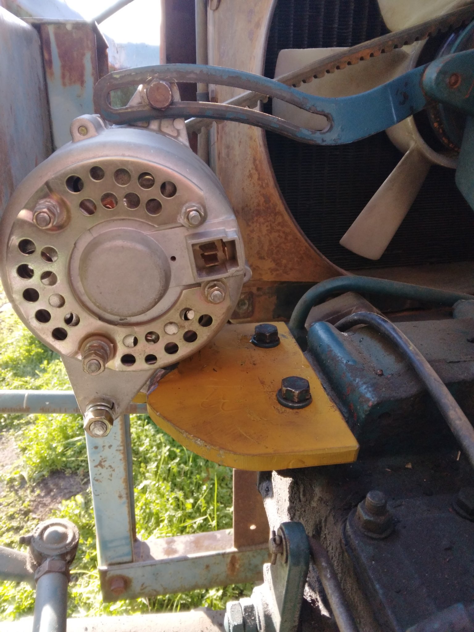

It looks like this . That generator mount is way too wide for that alternator you need a conversion mount plate .

That post is broken and slides in and out . I got the screws out and pulley off but i cant get the ends off to see if i can fix that .
If you did not need bearings that could still be used. It’s not optimal but you could put the ring terminal under that nut. Just make sure to pull the stud up as it most likely has a plastic insulator that is shaped like the stud so to won’t spin as you tighten the nut.
