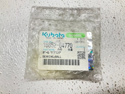

The required bearing sizes are 35x15x11 and 32x15x11. Still working on best sources; plenty of cheapies available but I'd rather not do this again...
No cheapies. Go for SKF, NSK etc., any reputable OEM supplier. They are still only 1/4 of the Kubota price.
Check the original bearing, the manufacturer is normally engraved on the outer ring or maybe on the cover disks. And get the standard bearing number (6xxx). This should give you more search results.
