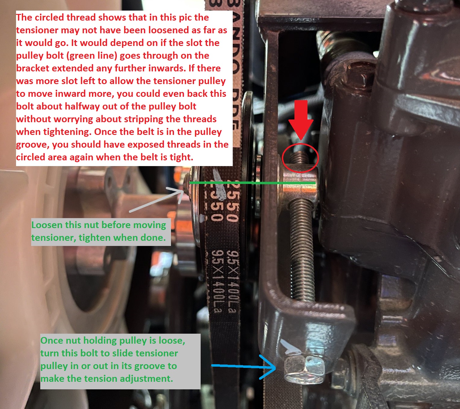

The tensioner has nothing to do with getting the belt on the lower pulley and ac pulley thats where the issue is. The tension pulley is for left right play not up and down
That is not right. The tensioner is for the belt you're talking about, and there is no 'directionality' to belt tension. The way you use that tensioner is loosen the nut in the middle of the tensioner pulley. That nut locks down the adjustment, you need to loosen it to change the adjustment. Then, loosen the bolt on the side of the tensioner bracket, that has the paint mark next to it in the picture you posted, counterclockwise. That bolt pulls the bolt the tensioner pulley rides on sideways to tension the belt. So first loosen it, put the belt on the bigger pulleys first and slide it over the small tensioner pulley last if it fights you. Then tighten that bolt on the side of the tensioner until the belt is appropriately tight. Last, tighten the nut in the middle of the tensioner pulley to 'lock down' the belt tensioner to that position.

typically the 'correct' tension is when you can push the belt in about 1/2" , midspan AND you need to recheck it after a days use(say 4-10 hours).

But then there's the odd one. It basically comes down to the fact that you're not seeing something. Sometimes it's obvious. Sometimes not. There's an adjustment somewhere that you're probably not seeing. Been there, done that. I've pulled off A/C units and power steering pumps to try and fit a new belt... only to find a hidden adjustment bolt.

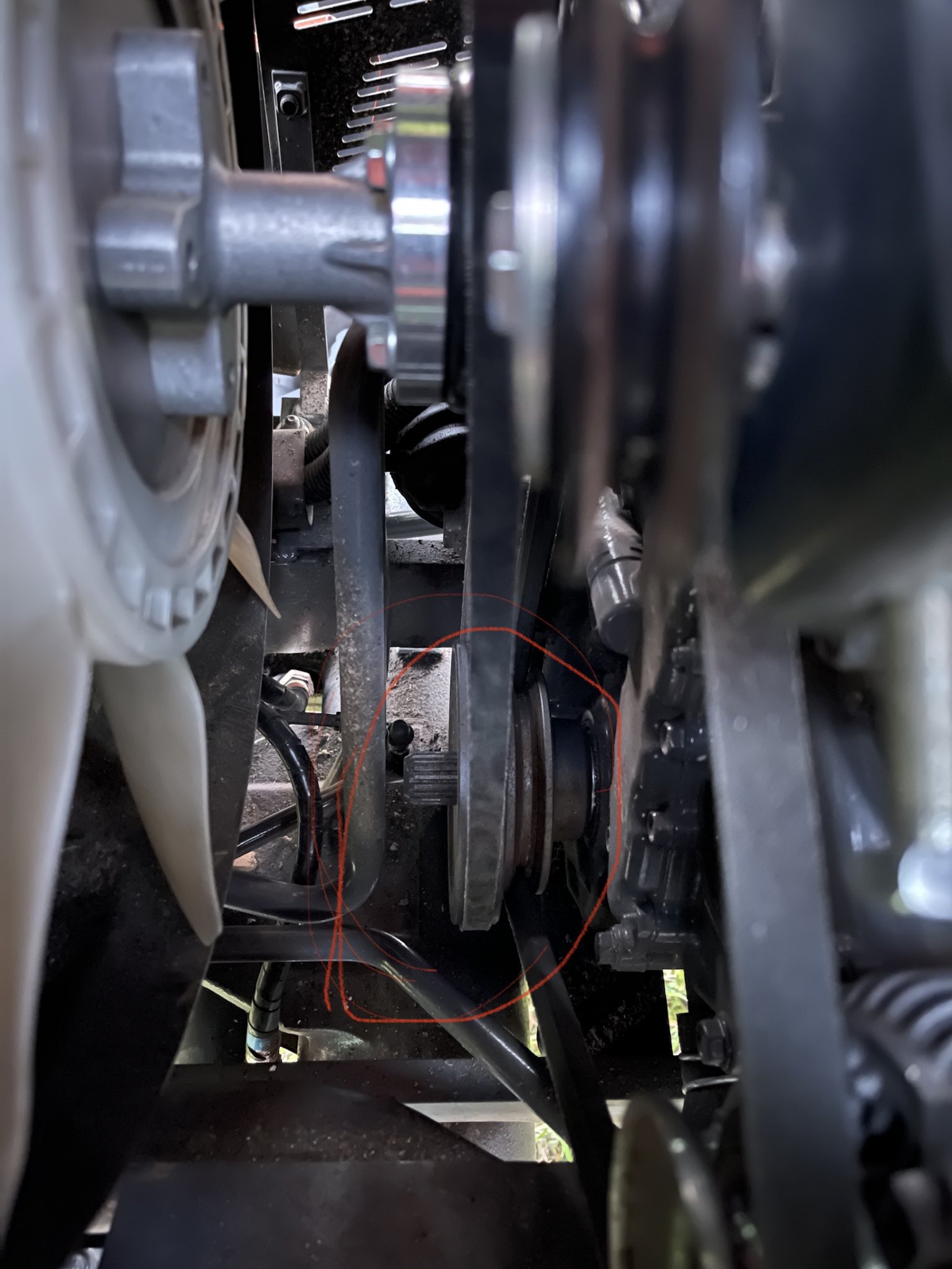

Edit: For what it's worth, the second picture in your first post. That belt is basically on there, by that picture. You might have to manhandle it a bit, but don't use any sharp tools.

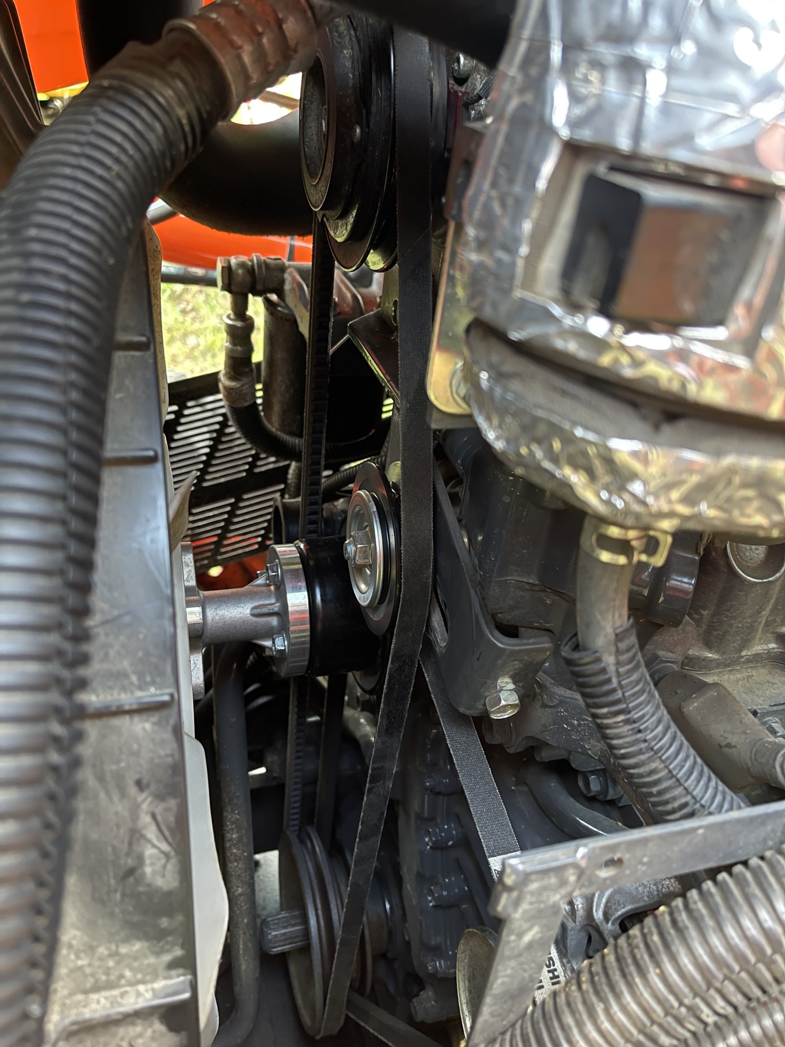

It's the correct belt,according to the pix of his buddies twin tractor.
The problem is, he's got the belt on the WRONG pulley !
He needs to remove it, loop around the smaller,inner pulley, then over the AC pulley, then adjust the tensioner for 1/2" deflection. Then readjust after a few hours of use.

Hmm, is it on the bigger lower pulley or the smaller lower pulley ?
In your picture, you have it on the bigger pulley, while your friend's engine has it on the smaller pulley.
Looking at his etup, there's more than enough 'length' to wrap belt ove rhte 2 correct pulleys and then tension it. You should never 'force' a belt on..too easy to damage it.

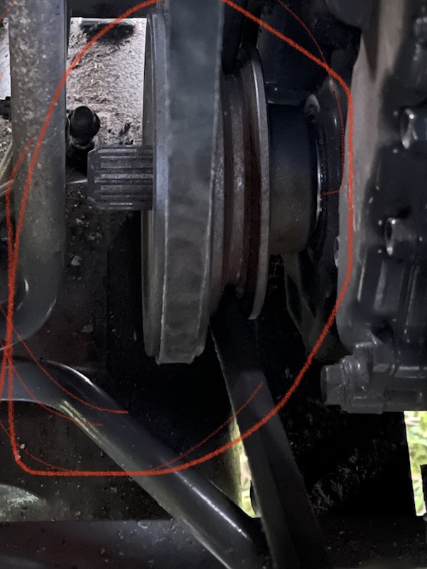

no they are on the same pulley the outer one aka the larger one. That other belt you see is the alternator belt

really? Is that a fact……the smaller in side pulley is the alternator fan belt pulley it is clear in the picture there is a belt on it already. The compressor belt goes on the outside pulley which you can see in mine and my buddies tractor just taken from the opposite side i took mine from
Here is the zoomed in on said pulley that you shouted im wrong about
two belts…

Ok, can you post a picture of your tractor that's the same angle and view as your friend's picture ,that show's the pulleys and belt and tensioner ?

Often times when folks ask specific questions and post pictures with pictures that are too close up. For someone not standing there looking at the problem it's best to get a further back picture then move in with some close ups. So the viewer gets a general idea then a specific idea. This helps in problem solving.

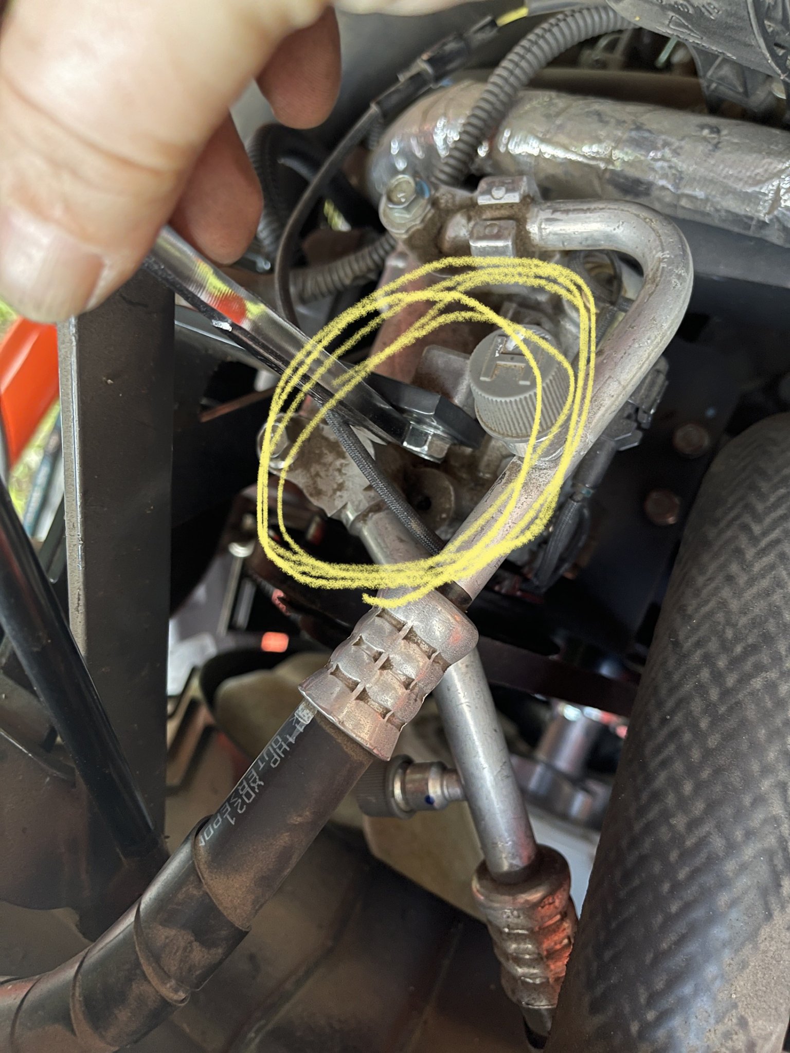

russellit left it out in the sun for the last day or so
was more pliable yet not enough ended up loosing two bolts hold on the ac compressor and it was enough to get it over and on the pulley
Ill post a pic of the two bolts in case it may help another with the grand l series for future reference
and one with a view from the right side as a reference for others

finally got it on thank you to those who threw out Suggestions and ideas to assist with exception the the latest one posting who seems to be that one guy who thinks he is right when wrong among a few other choice words i would have for him.

Not trying to be feisty to the OP, glad the belt is on and the problem is solved. But for the benefit of anyone else with a similar problem who might come along later..
