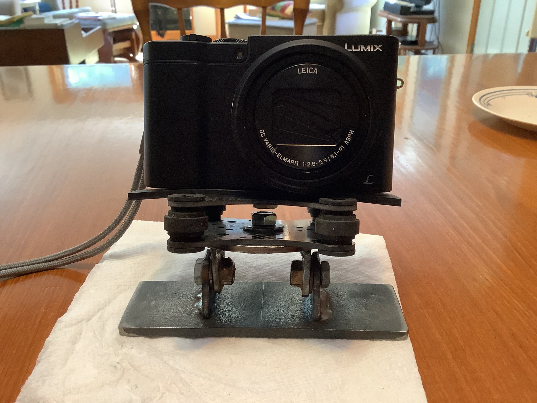

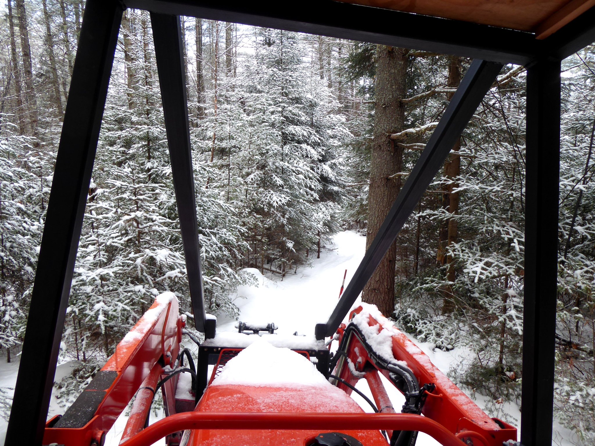

I have a cage with limb risers on my M5640. I have a vibration damper mount for the camera.
The camera was mounted over head center of the cross piece.
I have tried all kinds of mounts - even made a couple different vibration dampers trying to tune out the vibration. Some better than others but none good. Any help is welcome !!

That is surprising. That cage must vibrate much more than my cab. The picture from the camera I have mounted solid with a magnet near the top of my cab provides a rock steady picture. Maybe try to move your mount close to the point where the cage members all intersect and see if that provides a more steady picture.

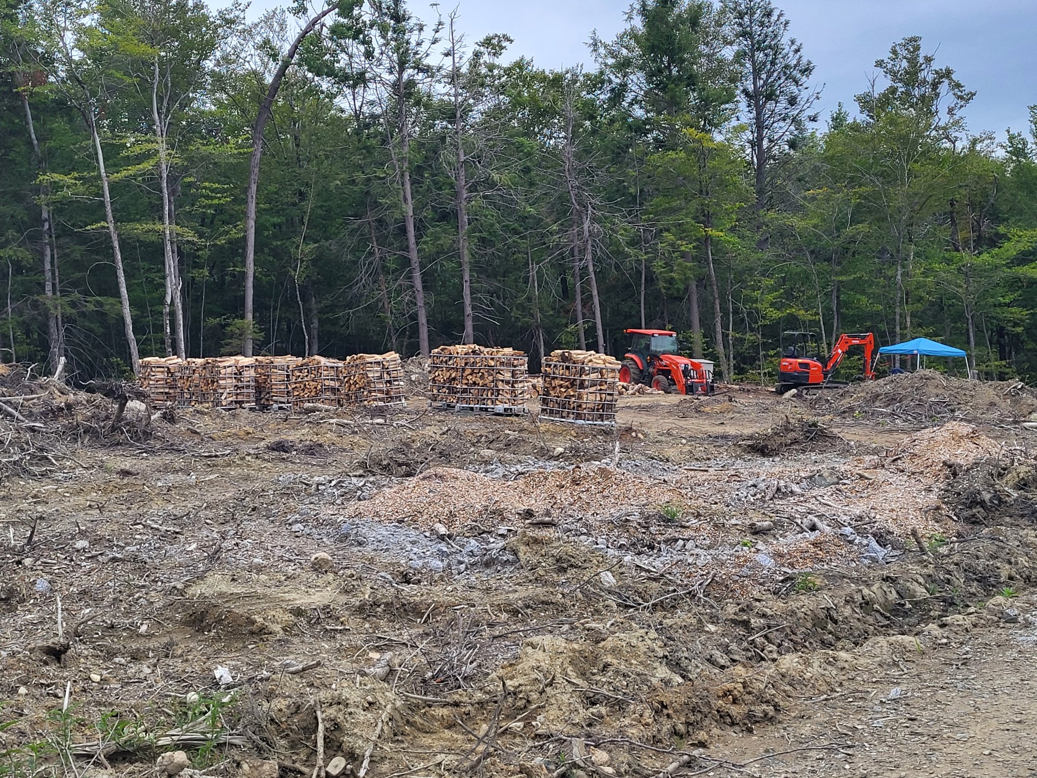

Does getting out of the cab 26 times count as a few times? Lol. I have uneven dirt and gravel terrain to contend with as we are clearing and grading after timber harvesting this winter so it makes it a bit more challenging. Once I get a level pad down, life should get easier.

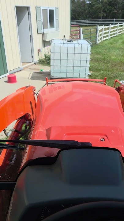

if i can remember to do it ill do a movie of me moving the horse hay feeder it always sits on really uneven ground.
you kind of have to disregard the orientation of the tractor itself and orient the forks to the load
i kinda use the fork frame to judge the orientation. once you get the fork tips close you can play with the tilt as you slide forward little at a time.
it doesnt have to be 100% perfectly aligned. dont overthink it
