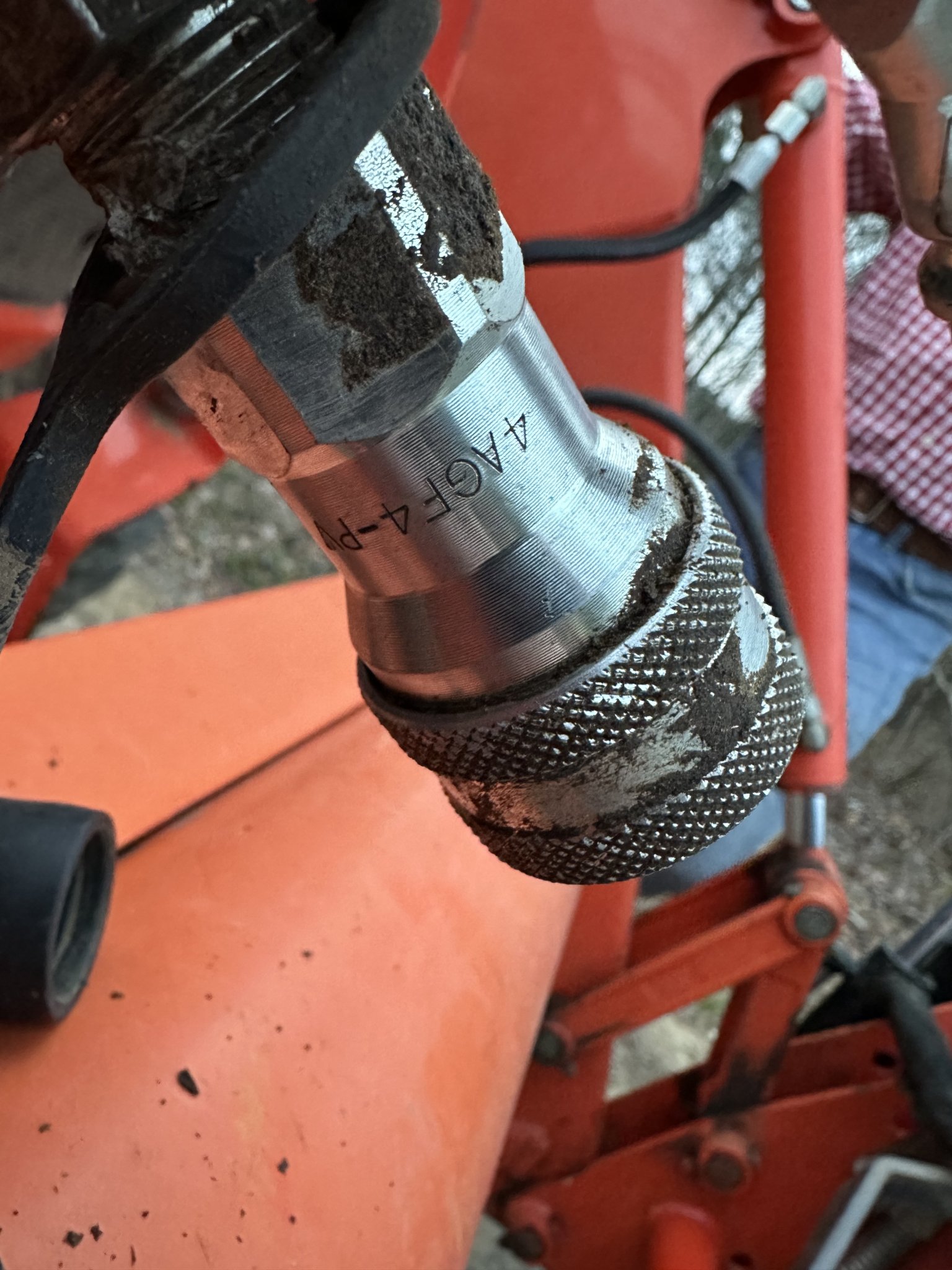

What size are the pioneer male threads? They are much larger than 1/2 NPT and physically measure 13/16” overall thread diameter.

Could be many things other than NPT. 13/16 is suggestive of 1/2" BSPT which is a common fitting on Kubota tractors.
The picture shows part number 4AGF4-PV which is a Dixon coupler. If you get the full part number off the coupler it will tell you the thread type and size.
EDIT
According to the Dixon catalog 4AGF4-PV is a 1/2" body size ISO 5675 poppet valve coupler with 1/2" NPT female threads.

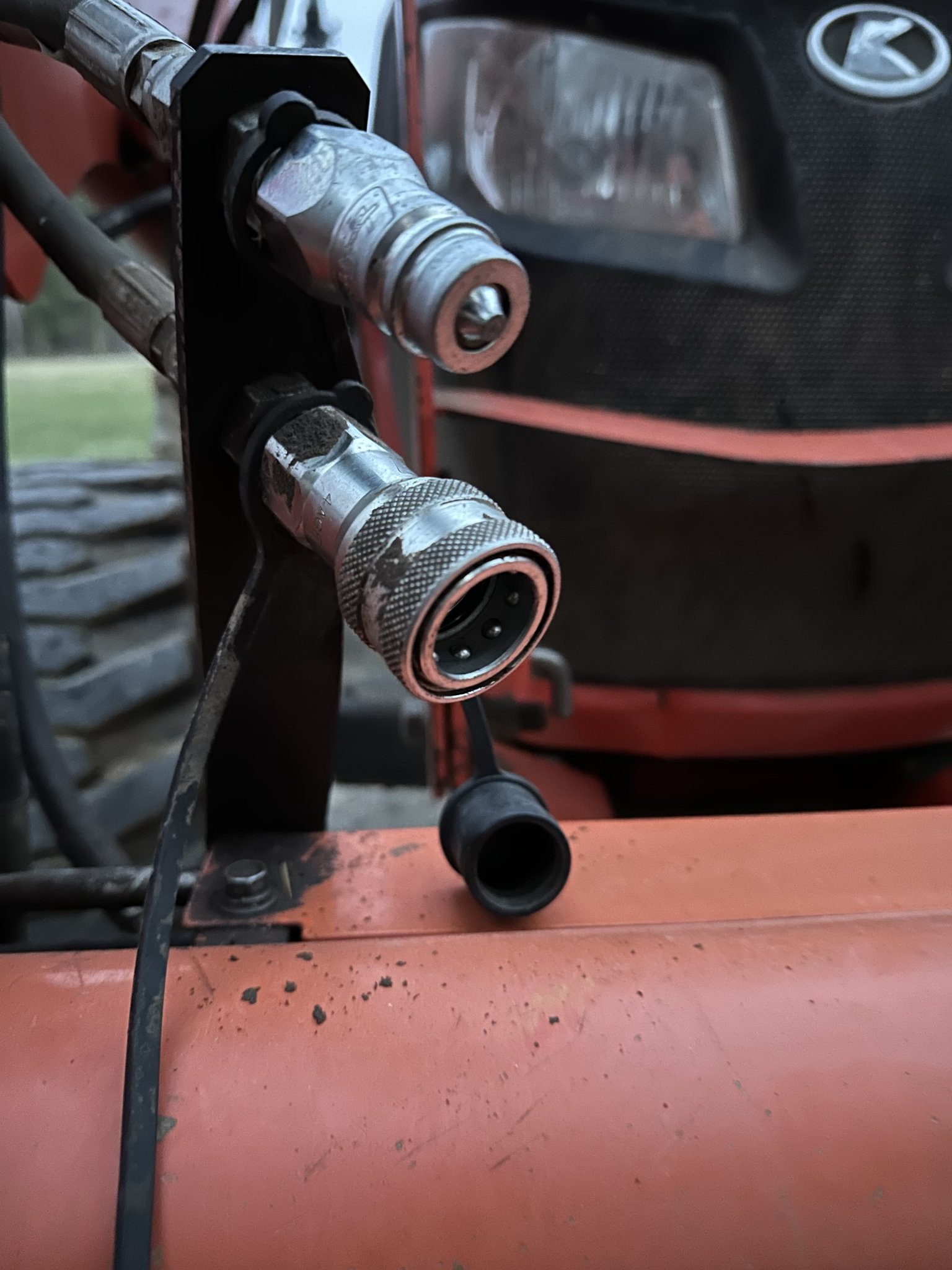

Dan, the fittings on the tractor side are both female. The thread diameter is quite large; around 13/16”

The picture shows one male plug and one female socket.
The part number on the female socket identifies it as a Dixon coupler with 1/2" NPT female threads. The OD of a 1/2" pipe is .840 and at the base end of a NPT male thread it is just under 13/16.

Here is a Dixon coupler just like the one on your tractor. You just need to know what the thread size is on the grapple
