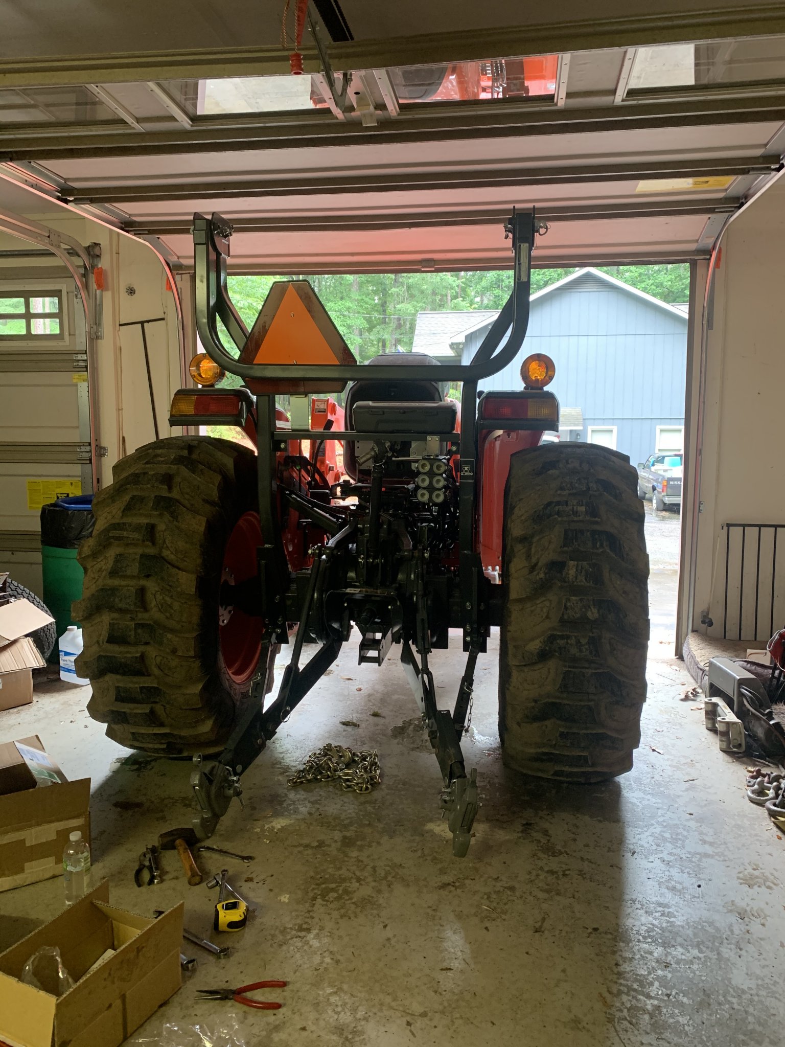

Ok thanks for this info. Does anyone know the height of the L4060 with the ROPS folded down? Low enough to fit into a standard garage?
76.5” on my MX that I’m installing remotes on right now.
Gotta duck while in seat, but it fits.
ROPS on L3901 is 91.7" and L4060 is 96.7". The 3901 measure 6'-1" folded so one would think the L4060 should be well under 7'.
