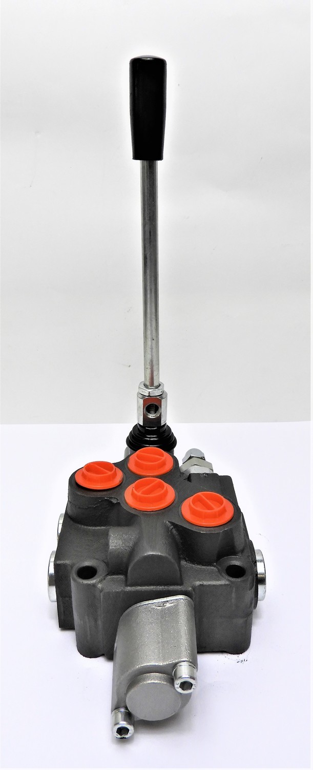

Any single spool valve with power beyond will work. This is the one I have
PB plug to suit
Just connect the T and C ports via a shorrt line to the back of the BX
The loop line goes to the P port
A and B goes to the top link ram
Same connection as the BH

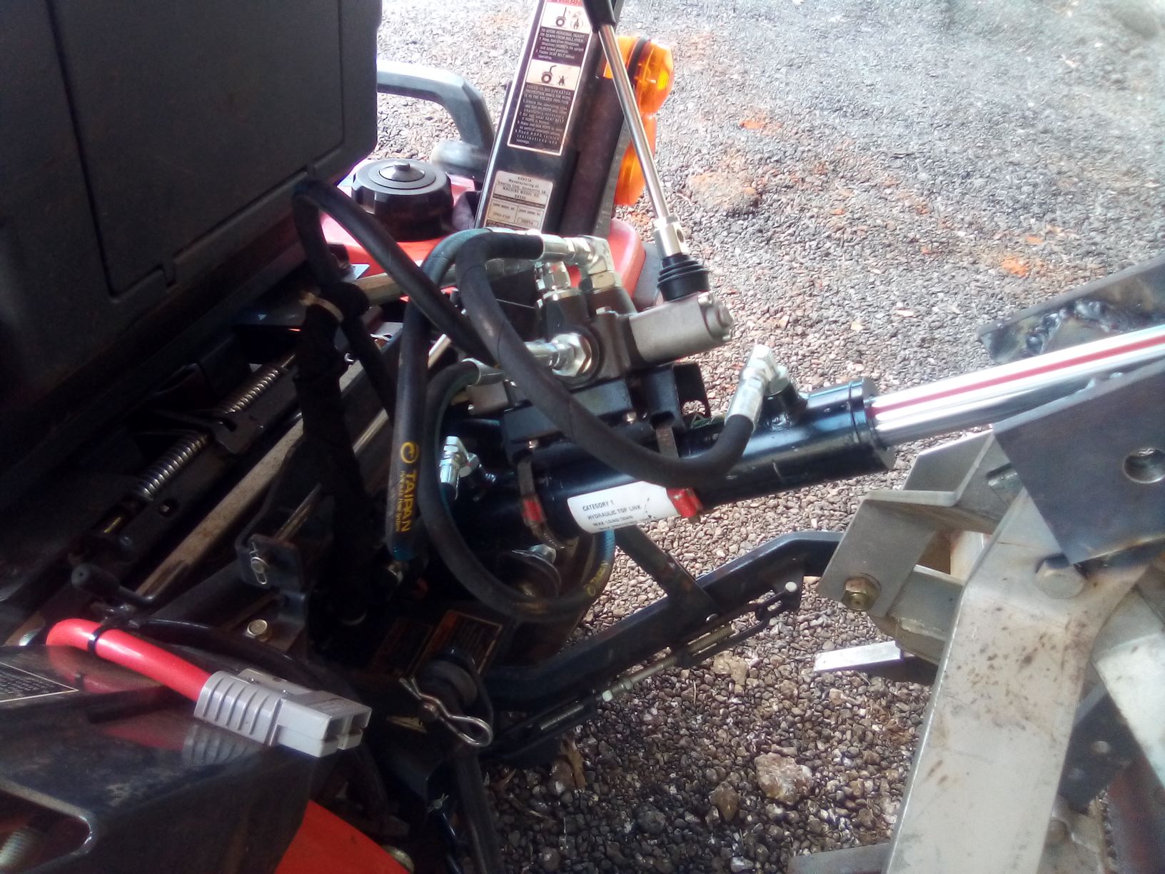

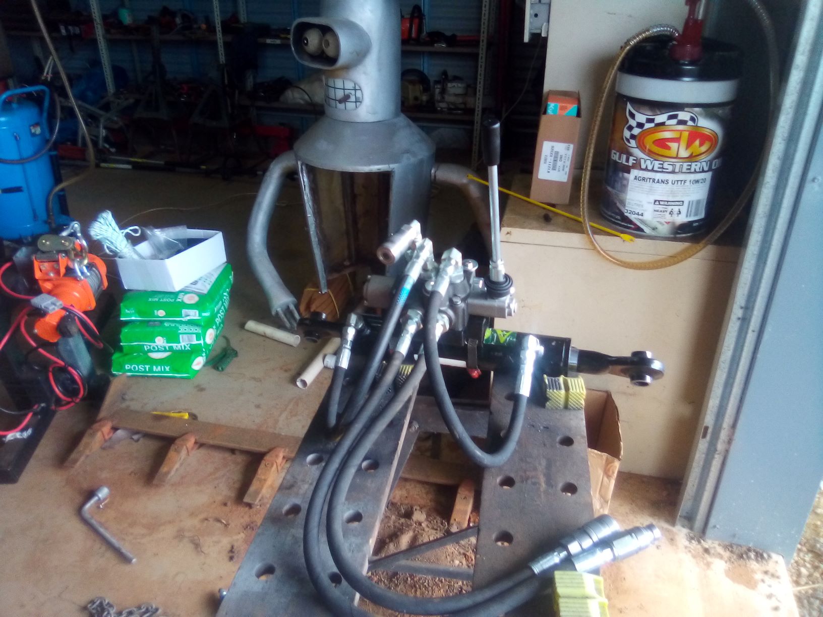

For MY BX23S-au I decided the kit was to expensive for what it was. Also had to make new coupler mounts and and hoses to fit it.
As I dont need the tilt, just the top link, I mounted the valve on the top link and just plugged into the 3 outlets for the backhoe.
View attachment 49357 \
Very interesting approach. Do not think I have ever seen a control valve mounted to the cylinder it is controlling!
Can you reach the lever from the tractor seat? If not I would see that as a major shortcoming. I like to adjust my top cylinder on the fly.
34by151
bx23s
Jan 12, 2019
166
46
Peachester, QLD, Australia
No issues with that, the hande is anged to one side. I only ever use it with the box blade which I adjust on the fly. The rest of the time I have the BH mounted
