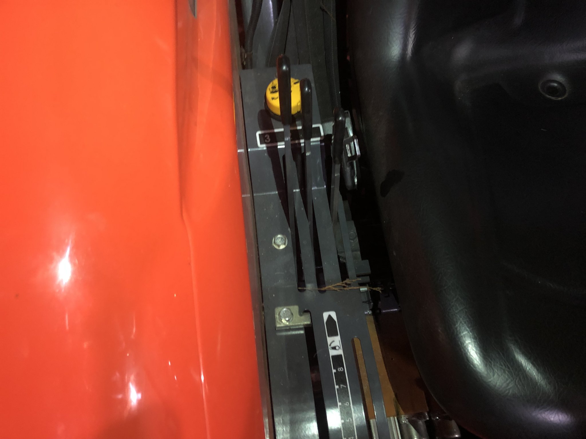

Same "standard" tractor as mine but more hp... You have an "open center system with power beyond" (important when buying the valve)
....adding 3 circuits (toplink sidelink and grapple)
....build your own.
....manual lever
....No Float (I have top and side links with pilot operated check valves, so no leak down!)
....Dos; add needle valve or restrictor to reduce the speed of the top link flow
Getting to understand what you are doing takes a little time (easy since you can ask questions here). I bought my stuff at Surplus Center, I bought a Wolverine by Prince MB series (which cost more but I *think* is better quality - I have NO infor to back that up!!!) I also want one that was close to the same flow as my tractor (less than 8 gpm).
I mounted that to my tractor, so I can measure the hose lengths I needed. I mounted it on top of the FEL since that did not clutter up the rear of the tractor and I mainly used it for the grapple. It is ugly but I only had to buy one hose to hook up the valve. (you need other hoses to hook up the ports!!!)
Basically, I removed the power beyond hose of the FEL and attached it to the new Valve's Power Beyond port Then I needed to connect the two, got a hose that went from the old PB and connected to the Power IN of the new valve. Only thing left to do was to connect the low pressure Return to Tank "T" ports together (That's the only line you can "T" together). Since they were so close, I used fittings to connect the two lines.

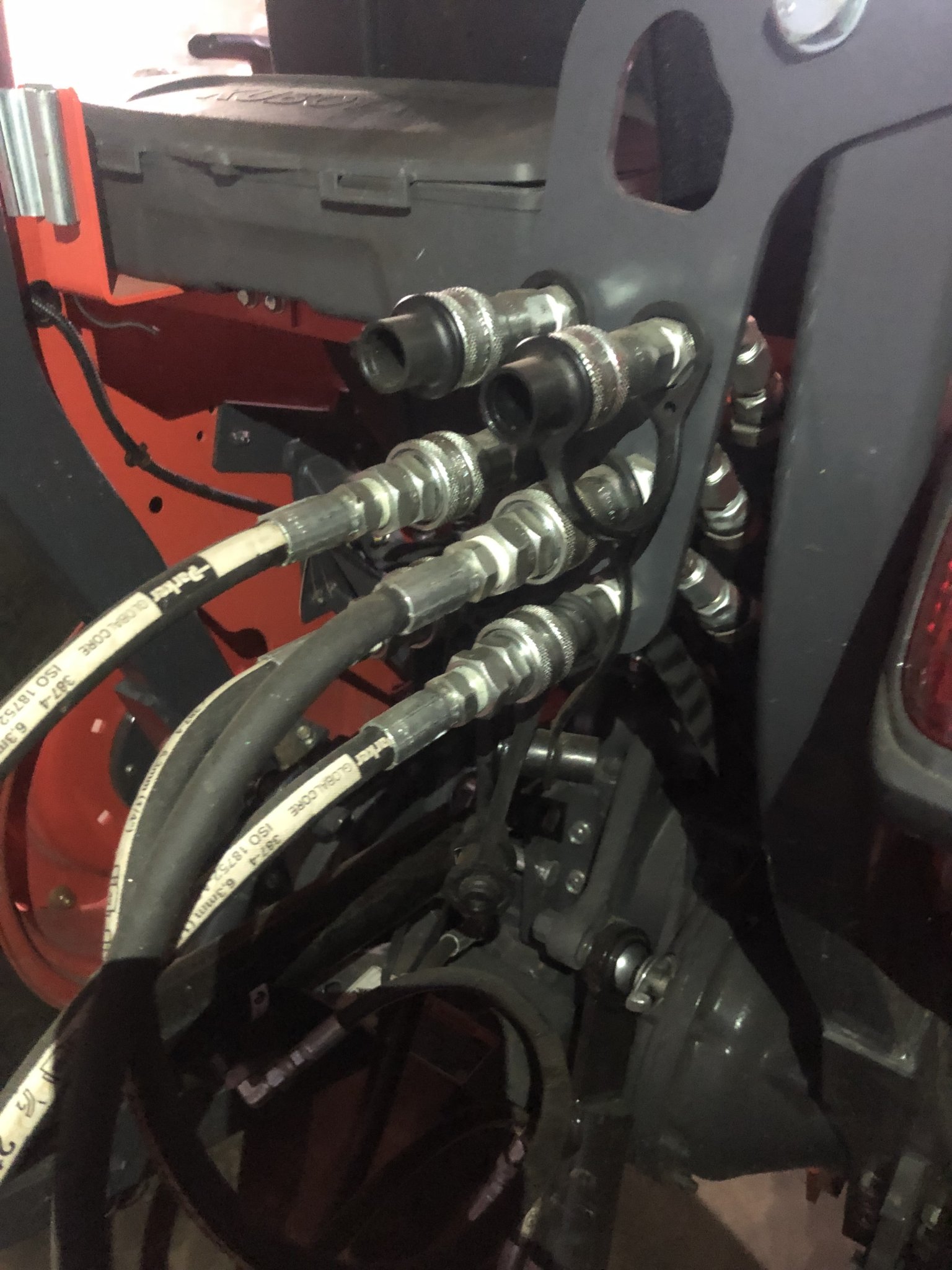

I can't imagine having a tractor without a minimum of three rear remotes out back. I have both SCD and FD remotes in both tractors and would certainly recommend at least one float valve (FD). The M6060 came with one SCD and one FD so I added a third FD since I see no disadvantage to the float option and plenty of advantages. I float all manner of implements such as the snow blower, folding cutter, flail, land leveler etc. Any time the rear wheels are on one plane and the implement on another float is nice to have.
It'll be interesting to see what you come up with. I've had the Kubota dealer install three rear remotes and two MX6000s and the M6060 and I like the factory look and function even if it costs more than a DIY kit.

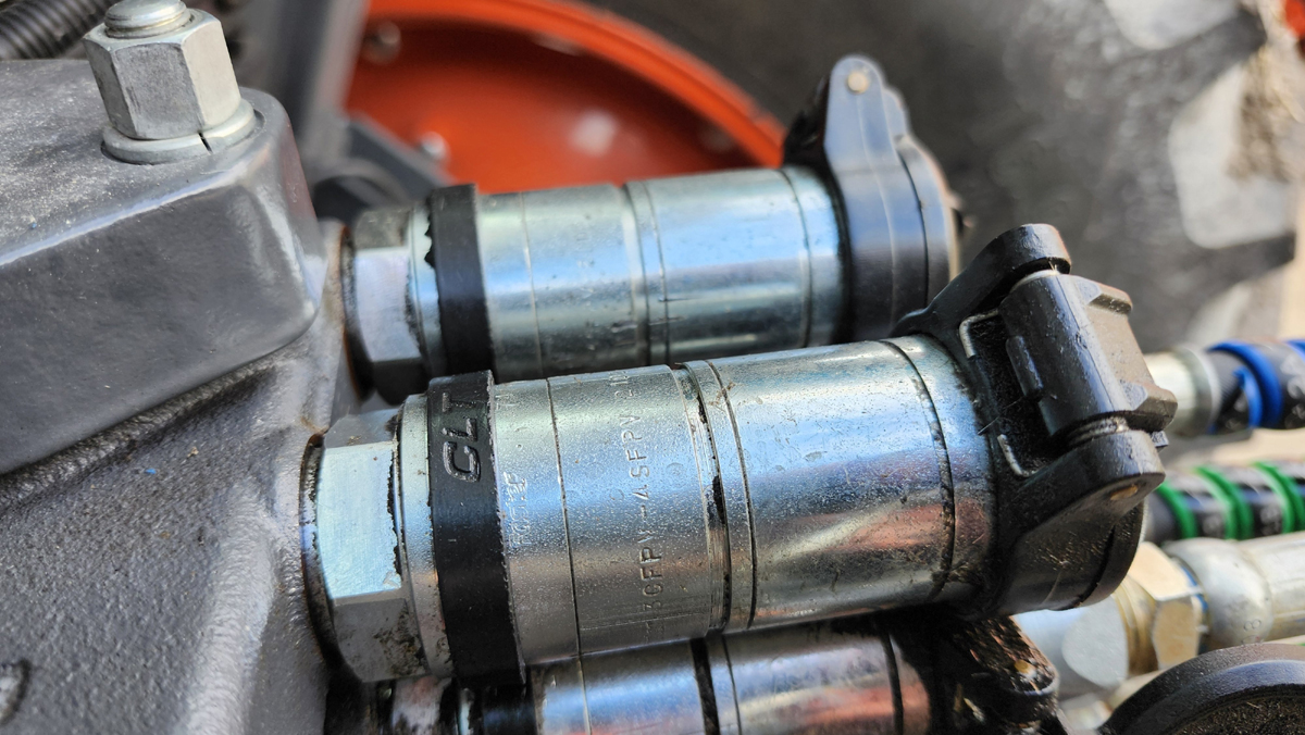

One isssue I've had which is annoying and messy is one of the rear remotes on the M6060 leaks. It's the top one closest to the camera, and I get some wetting all over the rear of the tractor if I leave that particular hose connected. When I insert the hose fitting into the coupler, oil squeezes out from under the black seal ring so I'm fairly sure it's a seal issue. I can't find a schematic of the fitting anywhere online but will replace seals this spring.
I ordered a seal kit from Faster which was a pain to track down, but I was able to order one from an hydraulic shop in North Dakota. It's probably in my PO box already.
