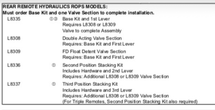

Where do you plan on buying this from? Messicks/Coleman or local? Either will be able to get you the right parts through the whole goods dept. My L4740 looks like it has the same parts needed as yours. I got the base (p/n L8335 aka TD170-98151) and a float valve (p/n L8309 aka (TD170-98161)). You could get a non-float valve, instead (p/n L8308 aka (TD170-98171)).
I also got the second position kit (p/n L8336) and a second float valve for about $1,400-1,500 shipped.
All this info is on the illustrated parts website through Kubota: here, under the "OPTION" drop down in the T15000 and T15001 sections. There may be slightly different parts needed, depending on the year or version of your tractor, so have your S/N handy if you call a dealership.

Hay Schmitty, thanks for posting this. I also have a 3240 and am looking for a rear remote. I found the TD170-98151 Base Remote. If i purchase this "KIT" will it give me one hookup at the rear of my tractor? It looks like the base remote gives you one, then 2 more could be added. I don't really need more than one, but a float valve might be nice.

Hi Bart,
That base kit is only half of what you need. It contains the base, lever, and coupler parts. You still need the float or non-float valve. Messicks was very helpful when I called their whole goods dept. (y)
I have not checked for differences between the two, but you will want to be sure if you have an L3240-1 or L3240-3 before calling Messicks or have your serial # handy.

Schmitty is the MAN!! Using the information shared I was able to get a rear remote on my 3240. I searched the internet for a while until I stumbled onto “new old stock” for the base remote, then got a valve from messicks and diagrams on Kubota site. All installed and operational in one afternoon. Base remote $310, valve $345.
