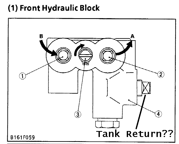

I think you are confusing open center spools with open center directional control valves. In the mobil DCV context open center has nothing to do with float. Your tractor has an open center hydraulic system and you must use an open center valve with both a tank and power beyond port on your tractor.
I am going to assume you DO NOT have a loader on the tractor. If you do the directions are a little different.
  1. Remove the plugs in ports A and B.
  2. Connect a hose from port A to IN on your new valve.
  3. Connect the power beyond on your new valve to port B.
  4. You then need to find a place on the tractor for the tank return on your valve. When I get a chance I will look at some parts diagrams to see where that would normally go.
  5. EDIT: After looking at the WSM and parts diagrams it appears that the tank return is via the plug in the lower right of the outlet block. The WSM does not talk about it which is odd. I have edited the picture of the block to indicate the plug I am taking about, You should verify that is the proper point before trying to use it.
  6. Once all three hoses are connected turn the selector valve 3 on the outlet block to the vertical position and leave it there. Do not turn it back unless you remove the hoses connected to A and B and plug those ports.

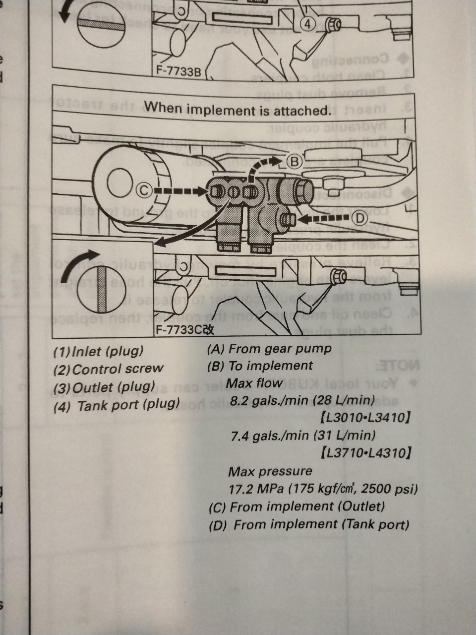

Hi Old Hokie, correct I don't have a loader. Here is a photo of my hydraulic block
Thank You View attachment 93814
OK - that diagram is a bit clearer:
  1. Port B on hydraulic block goes to IN or P on your AUX valve.
  2. Power beyond (PB) on AUX valve goes to C on block
  3. Tank port (T) on AUX valve goes to D.
Thats all there is to it.
