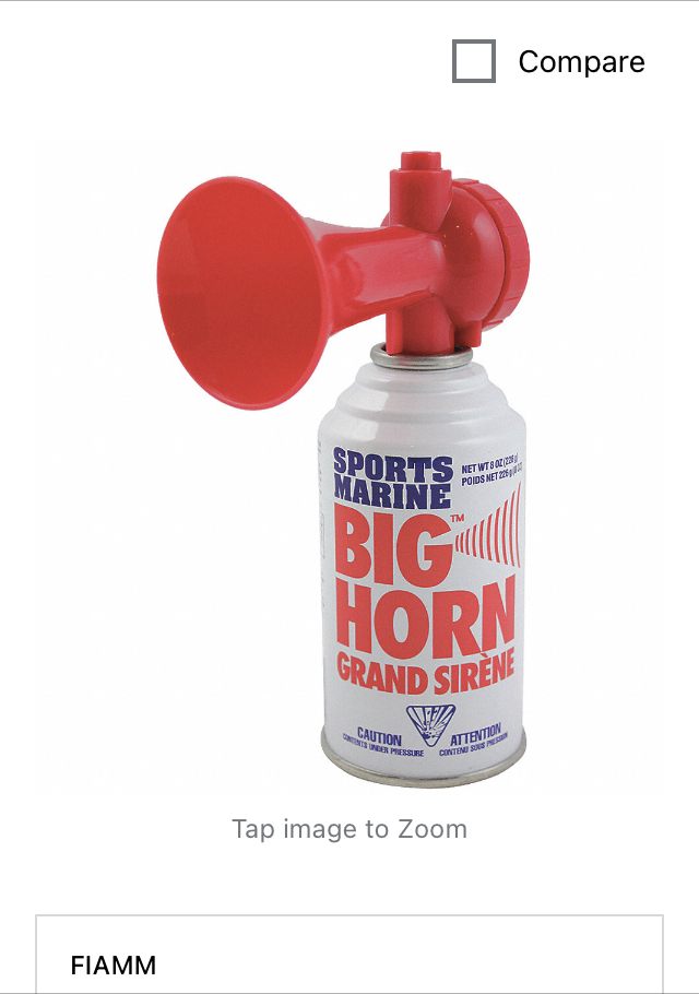

A few years ago while spending about a month at the coast for work, sharing a 5 bedroom house with co-workers, as part of a series of back and forth practical jokes and everyone generally being intentionally irritating for entertainment purposes because grown men sometimes act like middle school boys when left to their own devices, I bought one of those portable air horn in a can things like pictured. As the person in charge of the operation it seemed appropriate to blow the horn to signal the start and end of the day. It’s Coast Guard approved for vessels up to 60’. I’m not sure what that means other than it’s stupid loud. Even if you’re the one blowing the horn and everyone knows it’s about to blow there’s a involuntary convulsion/jump from everyone nearby when it goes off.
I have put it in the cup holder on the tractor and used it a couple of times when working with a crew on a work day at church where some were clearly experienced working around equipment and others needed a little toot to be reminded leave off picking up twigs for a few seconds to allow me to pick up a tree.
I have no idea how long they last, but it’s highly effective and satisfyingly annoying to everyone within a few hundred yards.

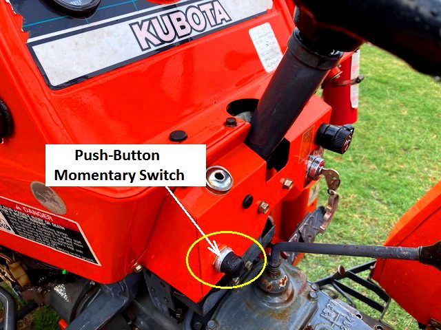

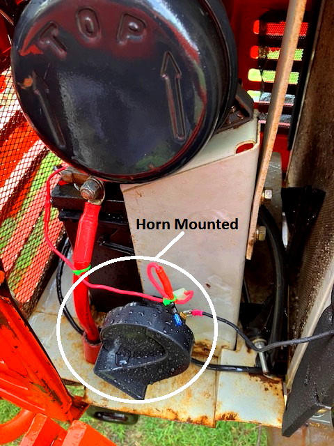

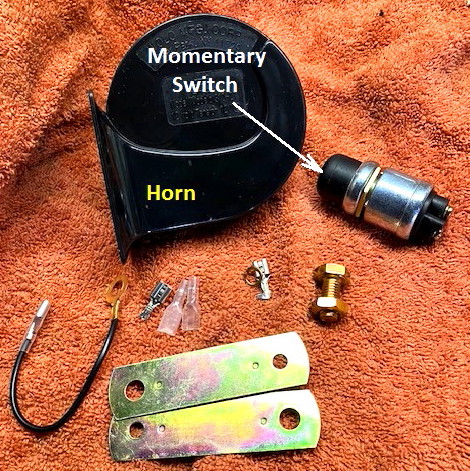

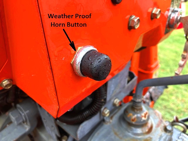

Same here. Doesn't take any real effort or time. I found a mounting spot for the horn close to the battery, so just ran a fused 'hot' wire to the horn straight off the battery.
Then mounted a push button momentary switch at the dash area and ran the ground wire to it to complete the circuit. Done in no time.
